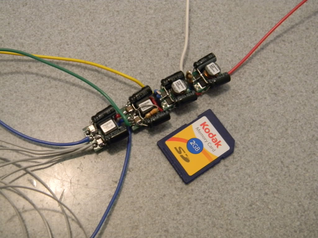

Custom regulator is all wired and ready. For those who don't know, most portablizers replace the GC's standard regulator with these much smaller and more efficient Texas Instruments regulators.

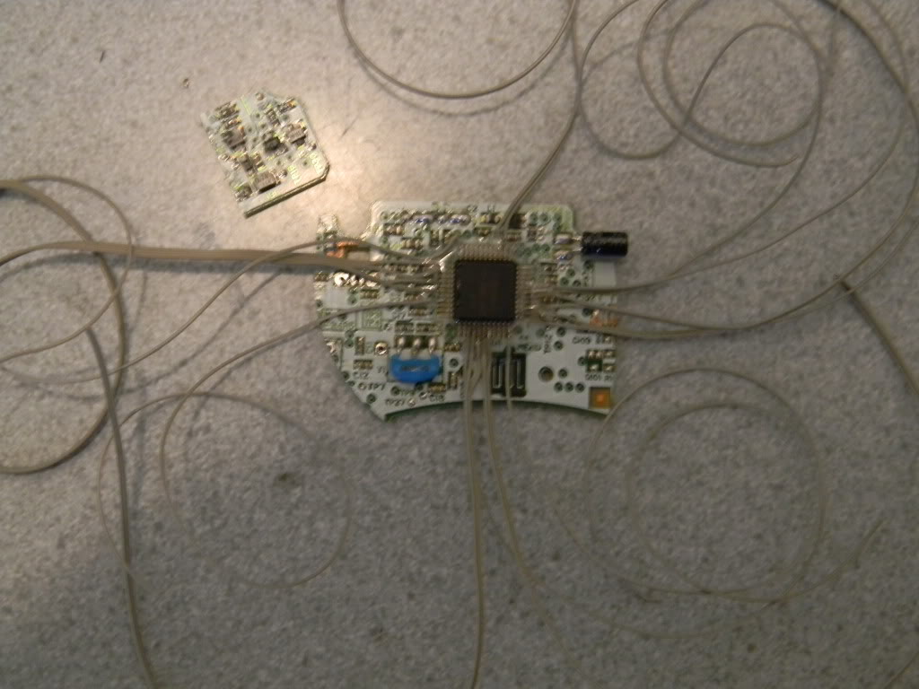

Controller board is wired up:

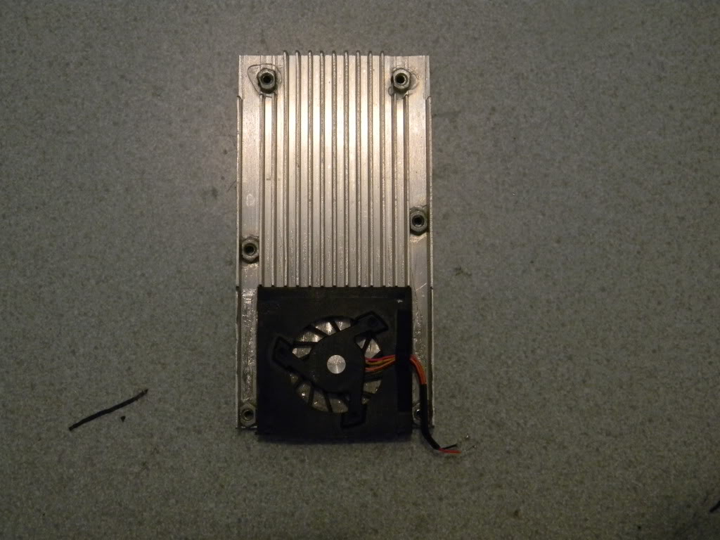

Heatsink/Fan ready to go:

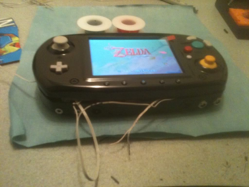

Post by Ashen » Sat Jan 28, 2012 7:42 am
This ones all done! Here's some craptastic pics of the finished unit, my camera wants to make everything dark and blurazy tonight for some reason.
Unit is 100% done, tested, etc, etc. Sans the L/R decals and the logo decal I'd like to apply:
I'm not 100% sure about it though, what do you guys think?
This one is real similar to the Revolution in every way, I tweaked out a bit more battery life in this one somehow though. 3 hours and 40 minutes!
Features:
Custom Vacuum formed case, slightly frankencased.
Dimensions: L: 9 3/16" H: 4 5/8" W: 1 1/2"
Weight: 1.835 lbs
5" Dalian "Good Screen"
Wiikey Fusion - GC lidswitch included for multi disc game support via the SD swap method.
AlmostWTF cut GameCube motherboard (onboard audio pre-amp retained) + Trimmed official GC heatsink with Tchay's netbook fan @ 5v
6x 2600mah Lithium-Ion Batterys (7.4v 7800mah total) = Roughly 3 hours and 40 minutes playtime. System is wired to "play and charge".
Zenloc's custom regulator: CPU=1.5v GPU=1.7v 3.3v and 5v all regulated separately for maximum battery life.
Official GameCube controller with rumble relocation, iPhone 3GS rumble motors, fully functional L/R "triggers" via the dual tact mod.
Internal 128mb Memory card on slot "A", Internal SD Gecko on slot "B". Save game transfer possible via external adapter.
iPod/iPhone audio amp with DSLite speakers + switching headphone jack.
Mario's low battery indicator circuit. Active @ ~30 minutes left.
