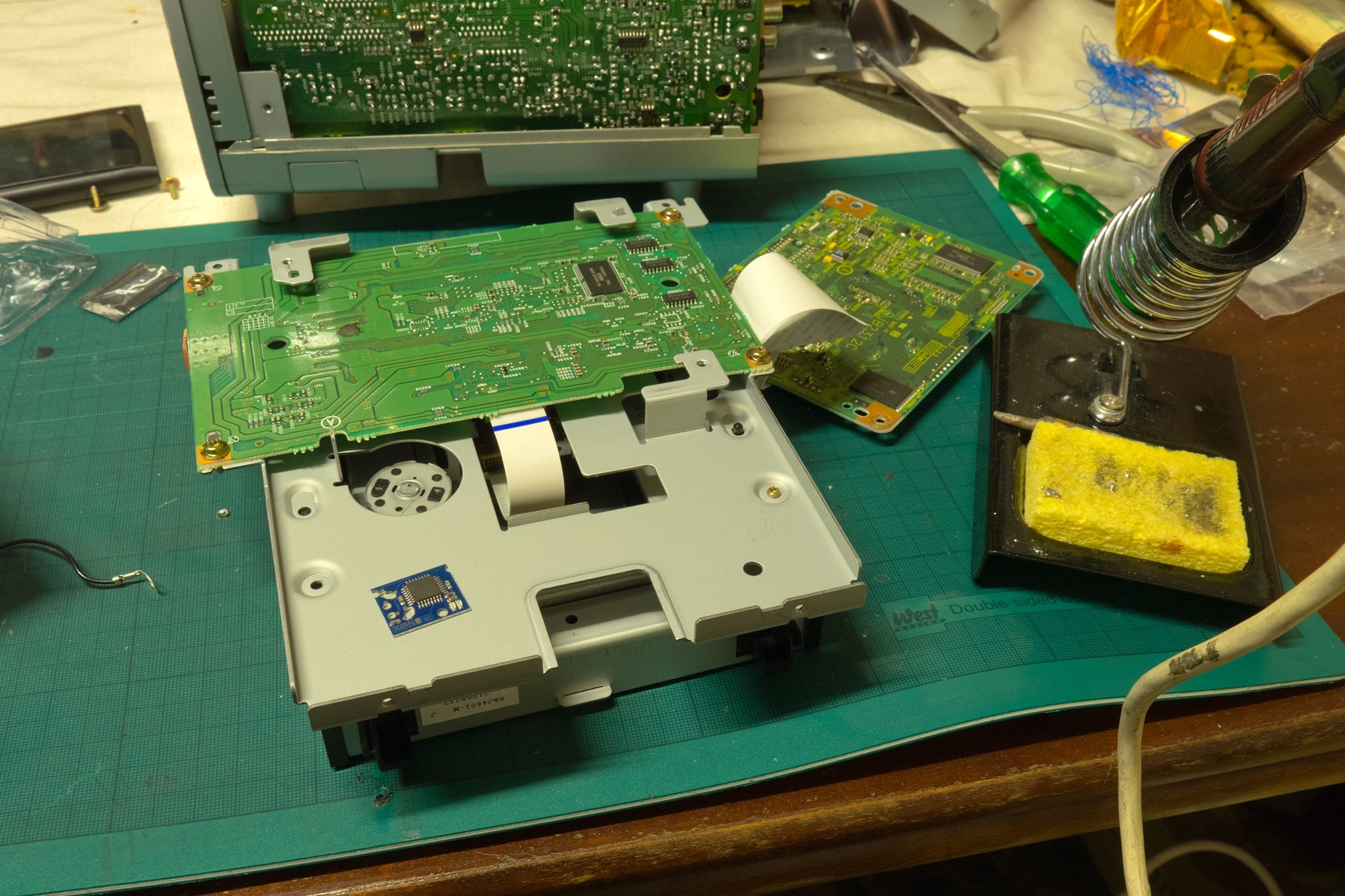

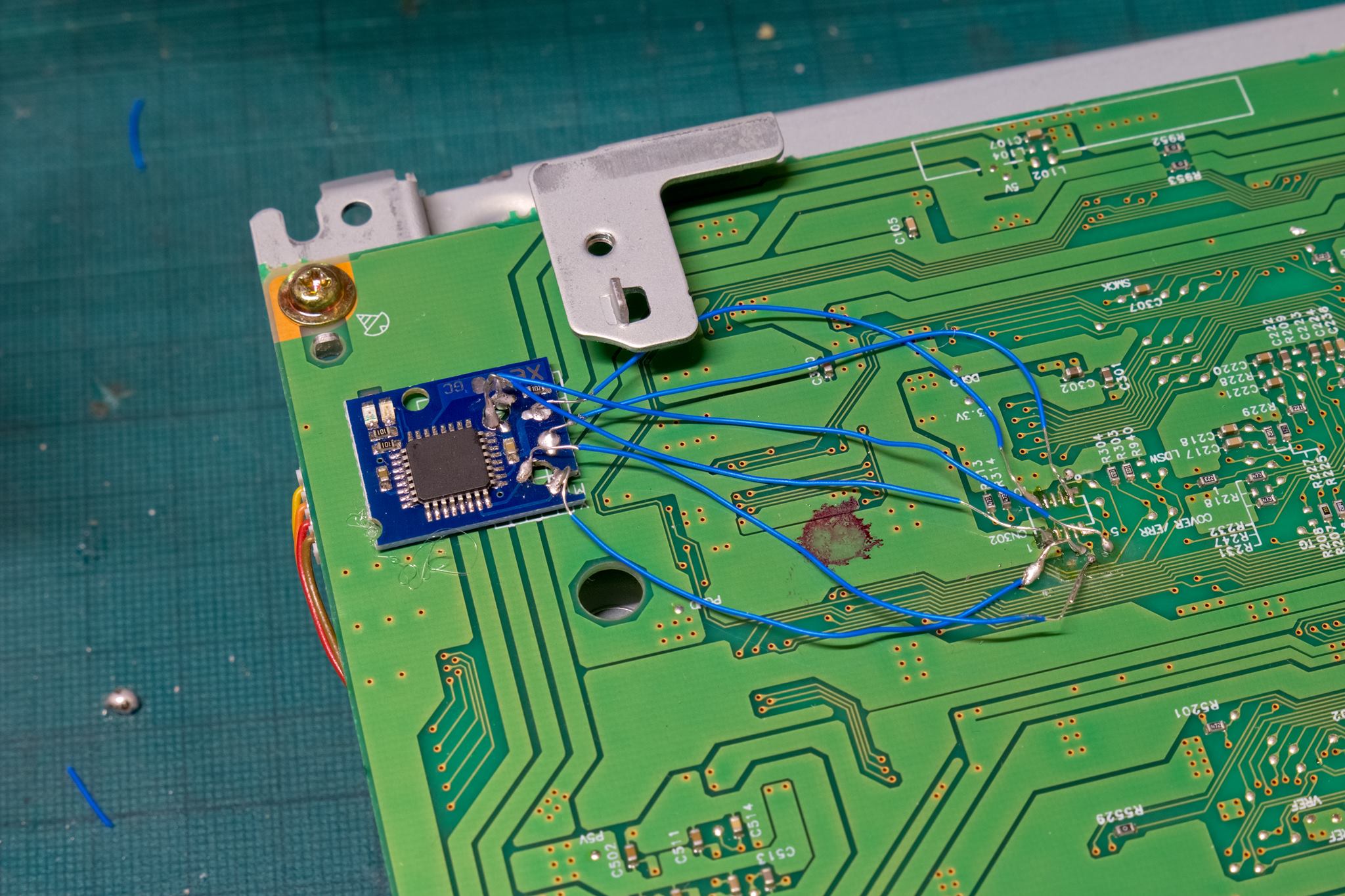

Well this is was one of the installations I did, this is also to show which XenoGC modchipo I have.
I don't think it's a clone right?
- (381.3 KiB) Not downloaded yet
Re: XenoGC and Panasonic Q
That a Q ? It sure doesn't look like the bottom of a normal drive.

I can assure you that this was the bottom of the drive from a Panasonic Q.Streetwalker wrote:That a Q ? It sure doesn't look like the bottom of a normal drive.
Good thing I took good photos of my work
