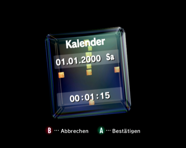

Do you know this - 01.01.2000 - in the GameCube's date and time settings?
(180.63 KiB) Not downloaded yet

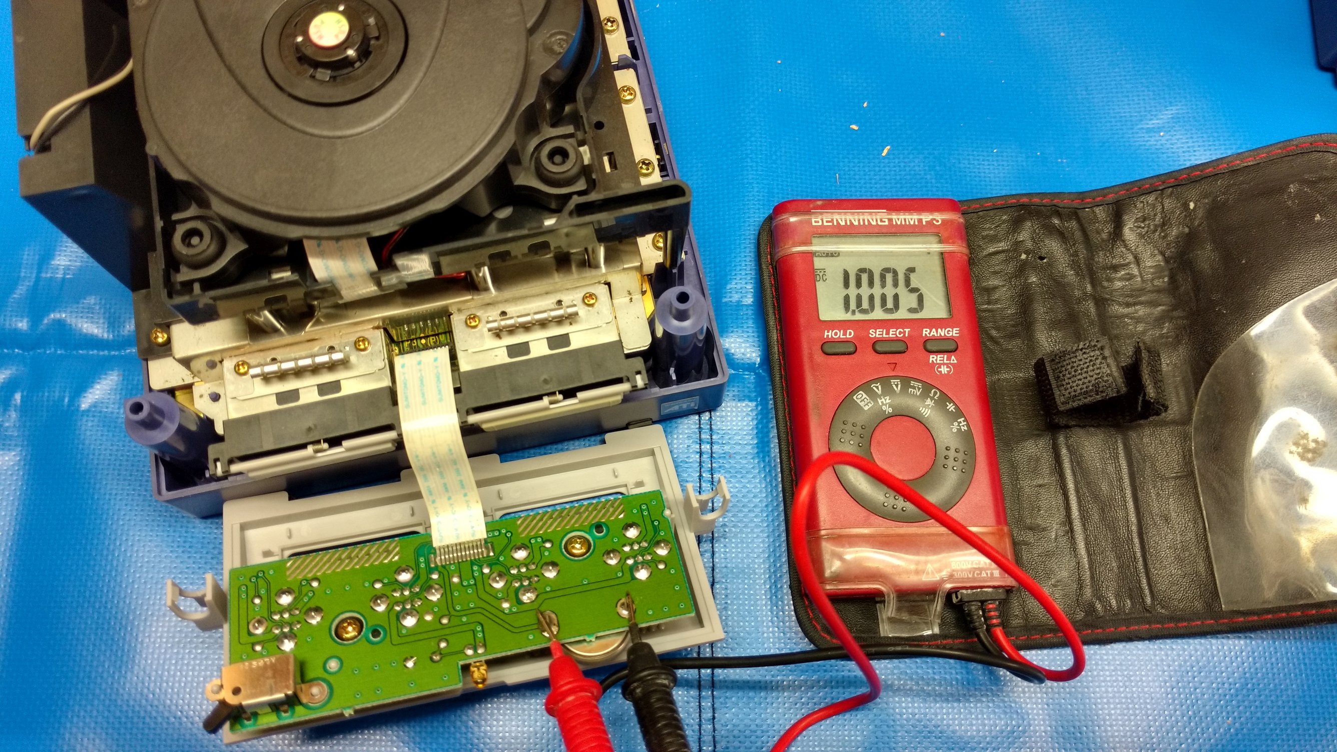

Here' is the reason why:
(788.06 KiB) Not downloaded yet
The GameCube's battery ( CR2032 with solder pins) should have a voltage of about 2.8 ... 3.3 volts.

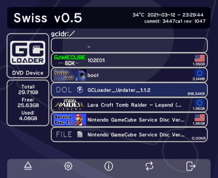

update the GC Loader PnP from 1.1.0 to 1.1.2 ( https://www.youtube.com/watch?v=ZvLxjSPyUoI)
(216.18 KiB) Not downloaded yet
