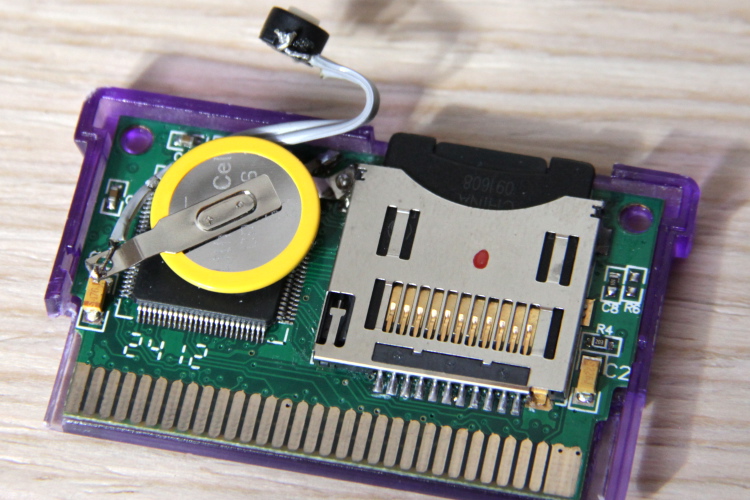

Hello, because of the very low compatibility of the SC MiniSD with GBA games, (this card was in fact mainly designed to run DS games) I never had a use for the save feature untill recently. :roll:
The problem is the battery was drained so much it didn't allow the quick power cycle to be performed, no matter how fast I can perform it.

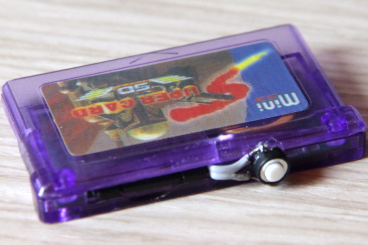

So I decided to change the battery, but with a little mod: a button to power the cart only when needed, in order to keep the battery good as long as I don't use it.
Inside with a cr1616 and the switch
(199.62 KiB) Not downloaded yet
Outside with the glued button
(149.75 KiB) Not downloaded yet
I then realized that even when I don't press the button, it keeps the saves long enough to allow the QPC to be done.
So I'm gonna run tests to see how long it keeps the save data without errors.
If you have such a cart with dead battery try just to rip it off first, and see if it work well without it.
