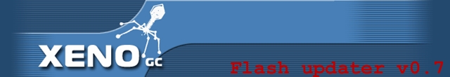

The chip is also capable of being updated via a flasher .dol file (included) - but I would use this at your own risk! It's quite nifty - the author tells me that he actually gets the MN102 to flash update the XenoGC - quite cool :) To run it, you must solder a switch from GND to any letter of the "Xeno" text on the modchip and toggle it when you've booted the DOL.

Just to confirm the flash updater does appear to function although i had to repeat the process.
Got a 1.00 xenoGC now reporting a Shell when pressing start, guess that makes it a V2 :)
