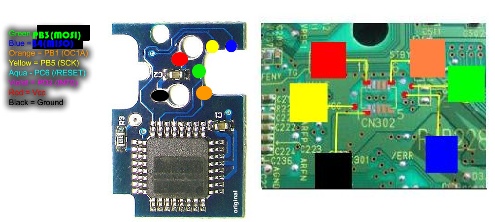

I'm using a Wiikey.
I connect like the picture is what my diagam is good?

It is only the same atmega8l, but not the same firmware. But you can flash the xeno firmware to the wiikey chip, so it will just work like a xeno.
Re: XenoGC Full Source Code
It will but, for my wiikey, it does not work.
