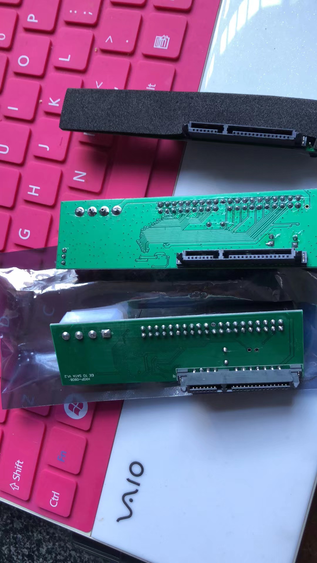

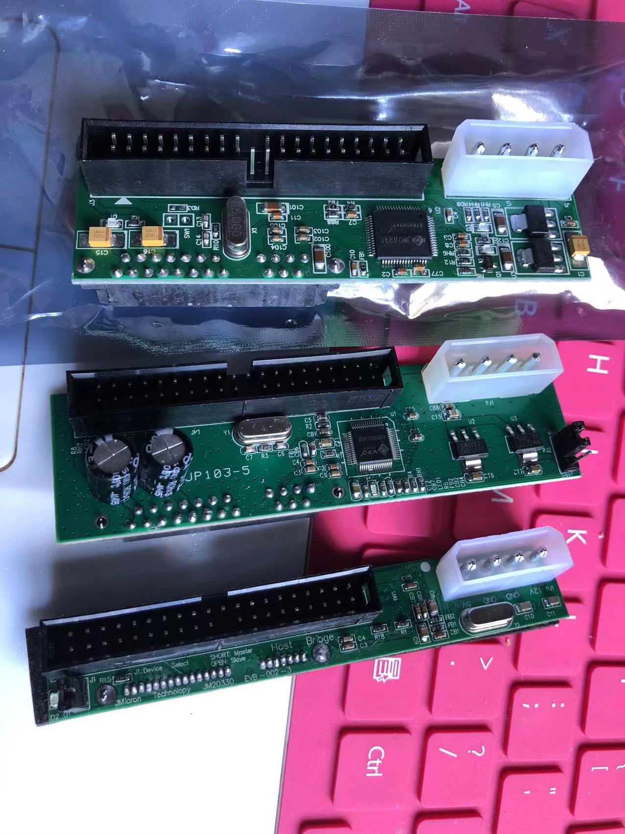

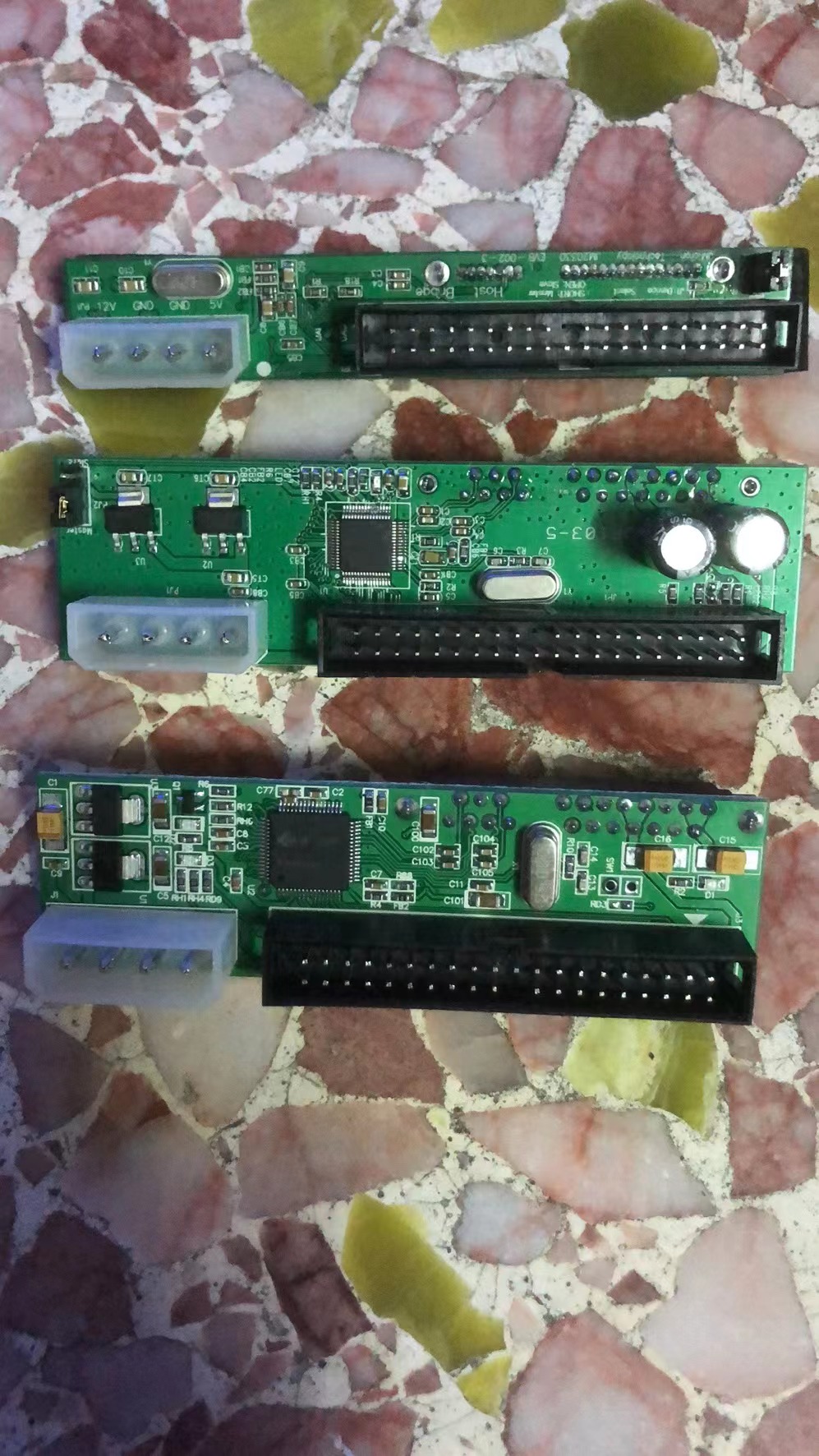

i have ordered some IDE TO SATA board as attached , hope it can be use for IDE-EXI to Sata HDD

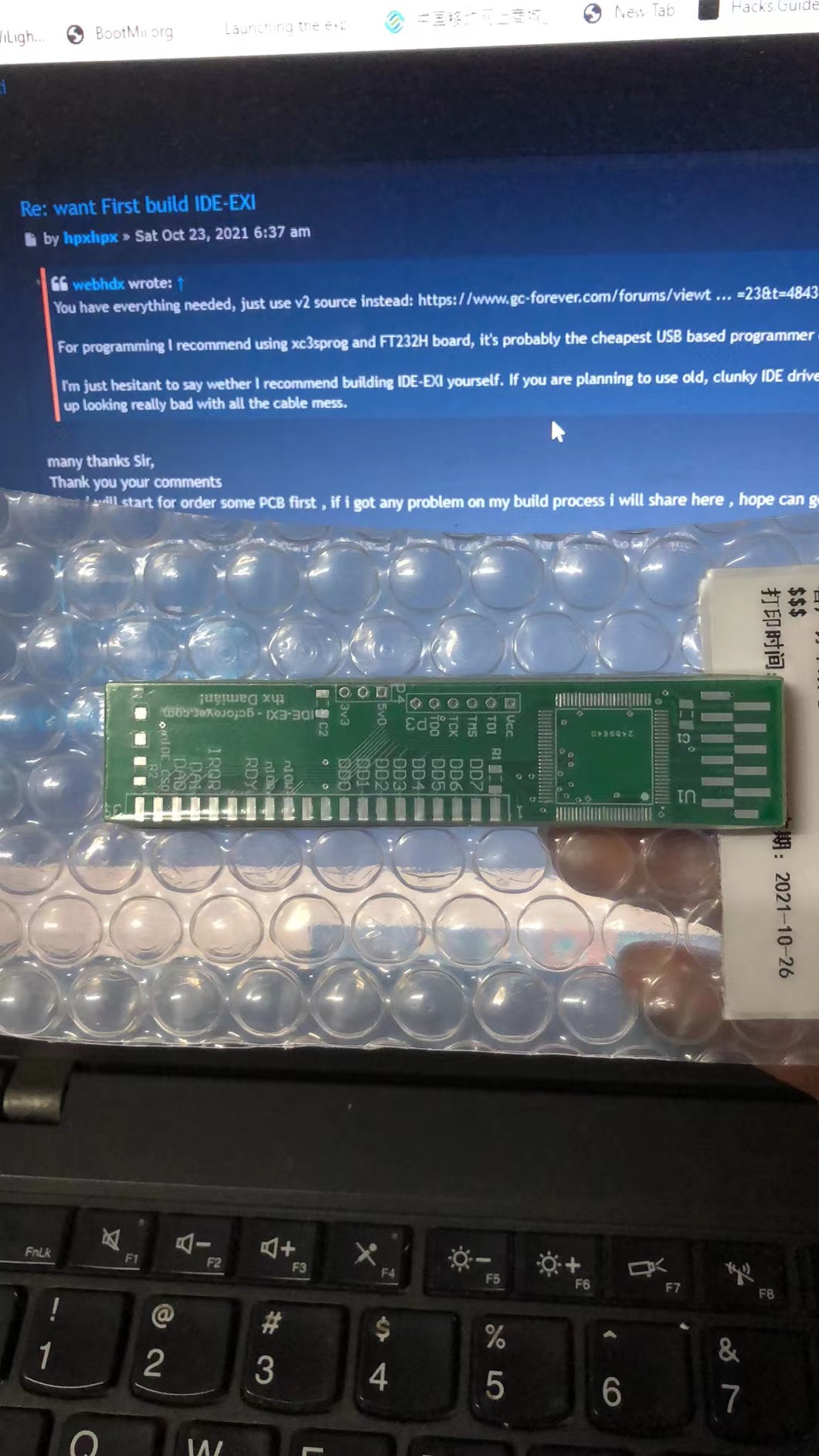

i think it may help if any new guy want to build IDE-EXI so i want to share my building process here
26/Oct/2021: i received IDE-EXI PCB, but i still has not order programmer and Elec part, i will order it in coming few days

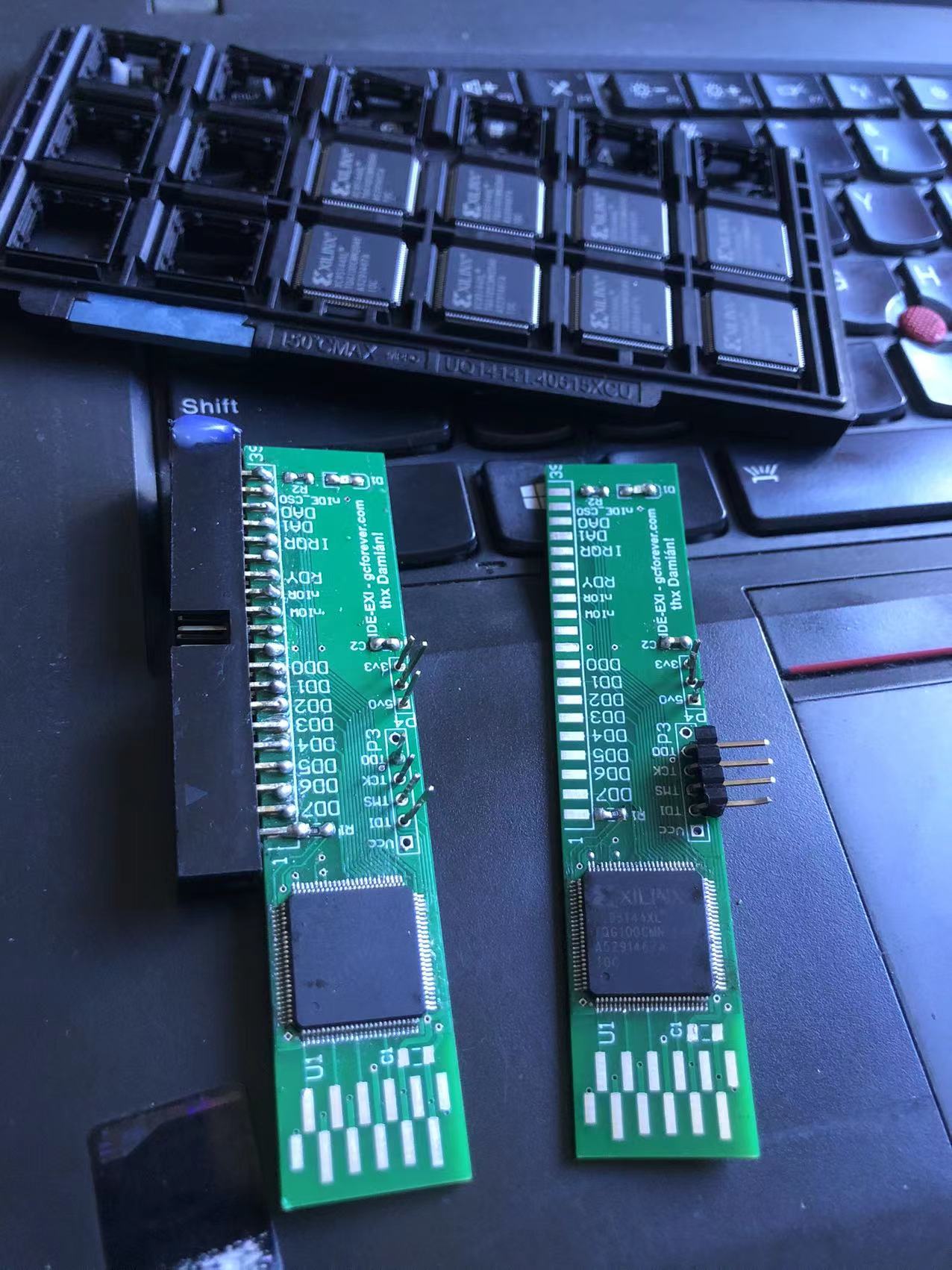

i got all the elec parts and two boards already soldered all components by hand
now waiting programmer for FW programming
- (276.27 KiB) Not downloaded yet
- (265.74 KiB) Not downloaded yet
Re: want First build IDE-EXI
I'd recommend using flux and probably higher temperatures to make better connection. IDE header seems to be barely soldered in. Maybe consider posting in a single thread, no need to post photos in 3 different topics

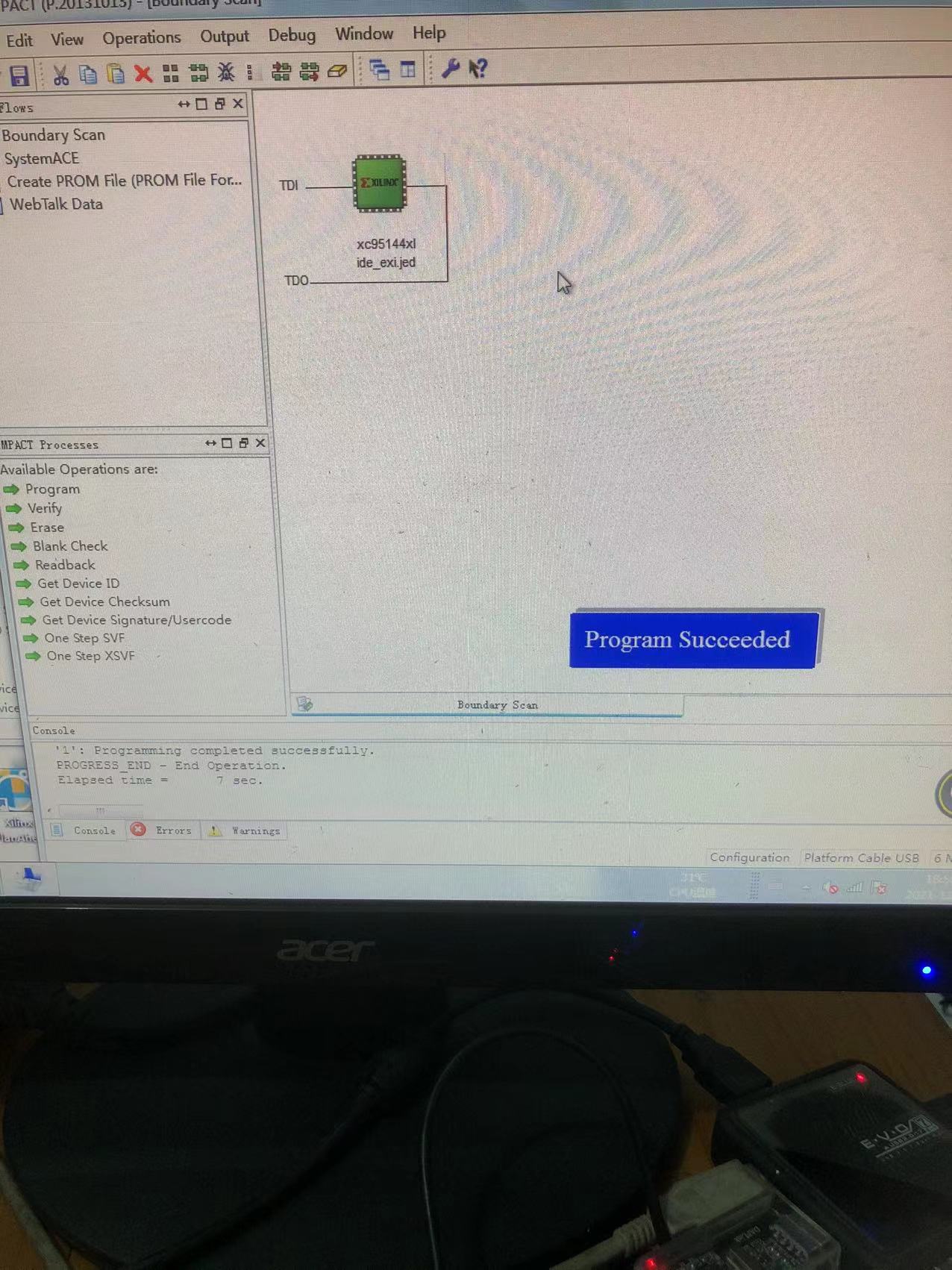

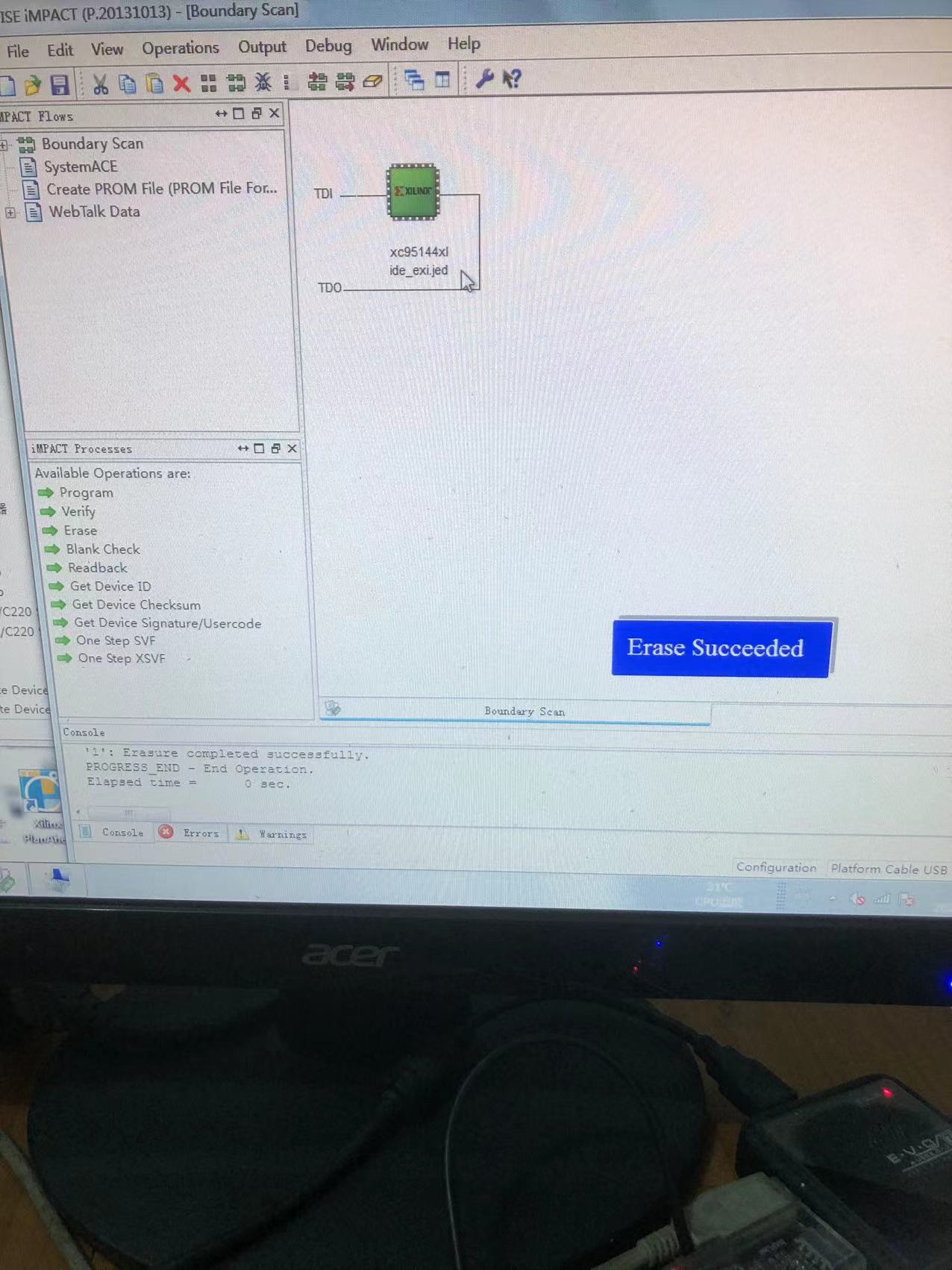

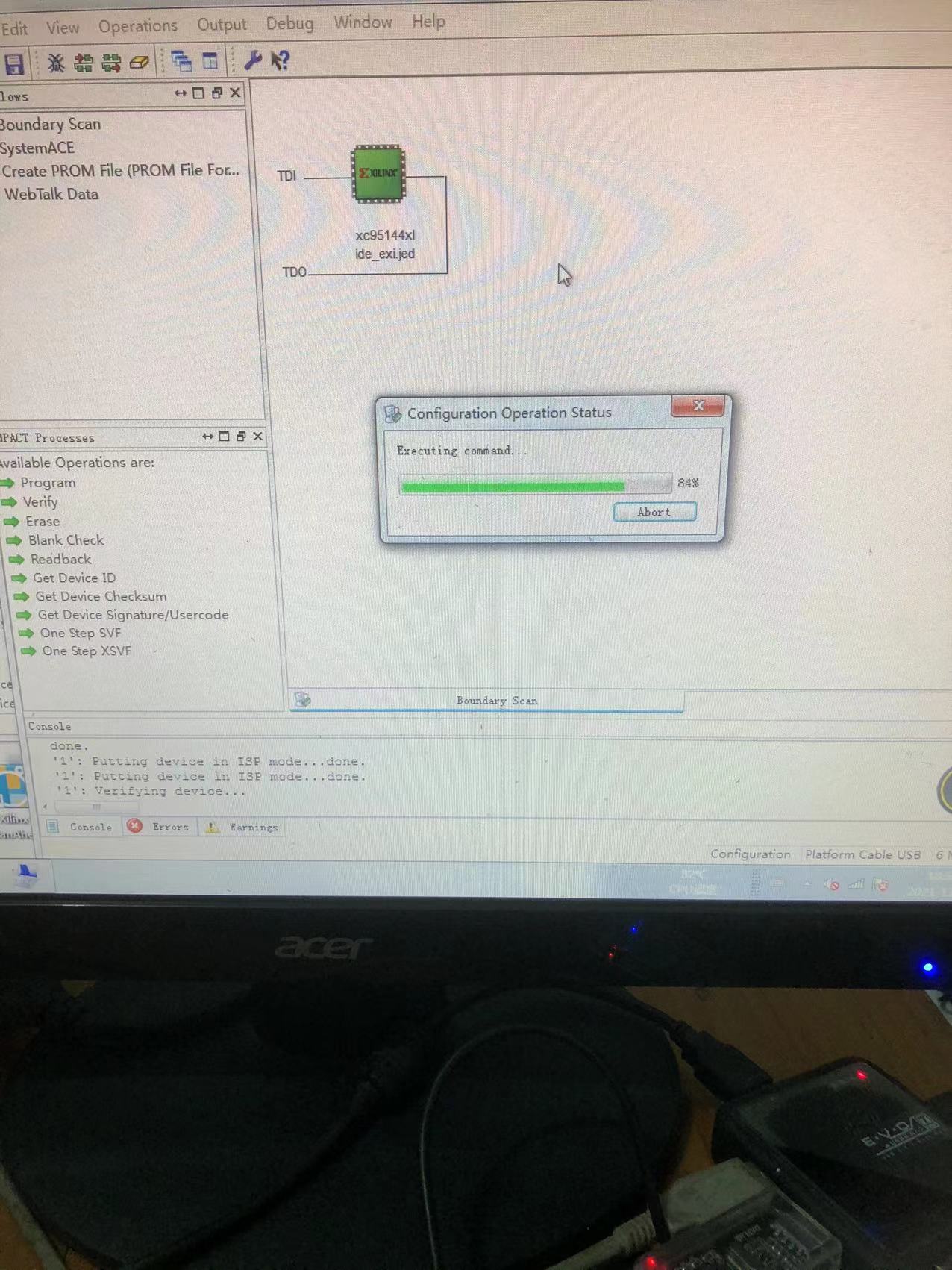

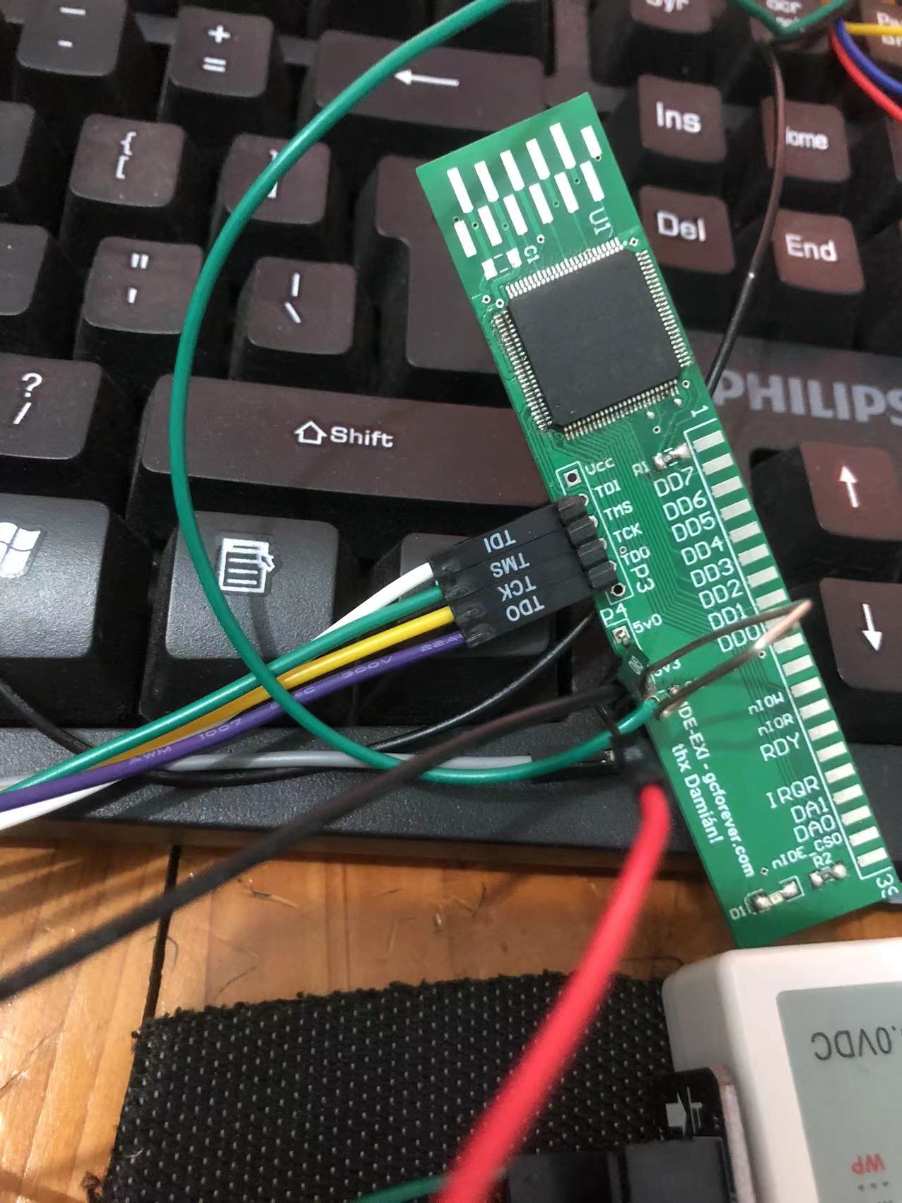

Dears
i got problem for use IDE-EXI, Please any one help me you if have any idea
I finished my IDE-EXI board build but it can't working
use Xilinx DLC9LP usb programmer for programmed IDE-EXI-V2 and the programming was succeeded
my connection as the setup flow picture (NGC-->IDE-EXI Board-->80pins IDE cable-->IDE to SATA board-->HDD)
HDD Format FAT32, Copy Swiss 1086 to HDD
By the way ,my NGC can boot by sd2sp2

picture part2
Your soldering looks really bad, you should work on the joints on the IDE connector. Does Swiss detect your IDE-EXI?

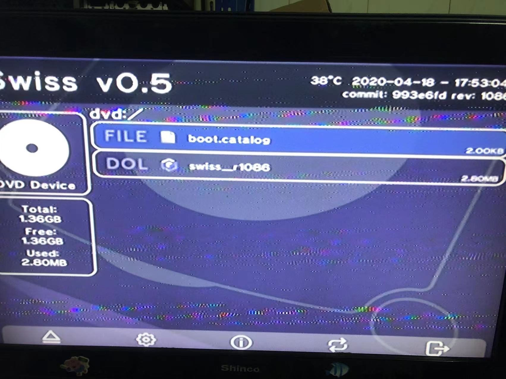

Seems my IDE-EXI board can work now
i can see the HDD in swiss by boot from SP2(attached picture)
i think the swiss also can boot from IDE-EXI ,right?
i had copy swiss to HDD but still can't boot from IDE-EXI
where i can find the IDE-EXI use guide?
At least the CPLD-EXI connection is working. Now you need to check if you can see the files on your HDD. There is no user guide because it's really simple. It works just like any other device, select it from device selection menu and choose ISO to run a game.
I'm not sure what you mean by "boot from IDE-EXI". It's not possible. If you have an IPL replacement modchip with something like iplboot then it's not compatible with IDE-EXI and you still have to boot Swiss from SD card.
