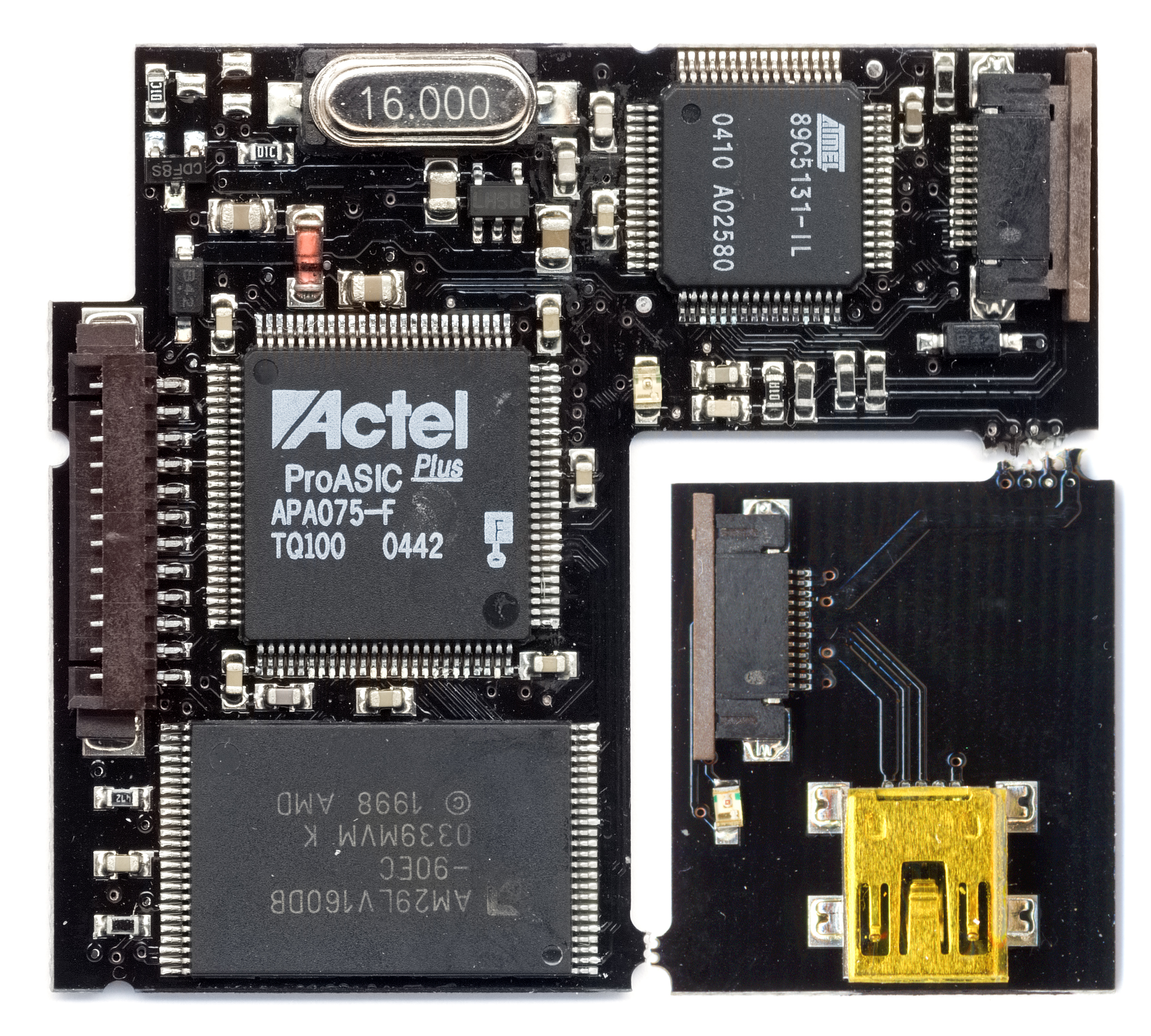

What part of this chip is the flash memory?
webhdx
Posts: 116
Re: Qoob Chip
Post by webhdx » Fri Jan 31, 2020 7:17 am
The part labelled AM29LB160DB.

Undead Sega wrote: Fri Jan 31, 2020 12:21 amWhat part of this chip is the flash memory?
It is quite obvious, you have three big chips on this board, a µC in the MCS-51 family, an Asic, and a Flash memory.
Undead Sega wrote: Fri Jan 31, 2020 3:52 pmAnd is that chip where the Qoob bios is contained?
That depends on what you mean by Qoob bios. The way the "chip" behaves is dictated by the code contained in the 89C51 rom (it is internal flash, as suggested by the 9, 80C51 would be a OTP one, for example) combined with the ASIC configuration and board topology. If you want to know where the payload (the code injected in the gamecube to "fool" it, it is probably somewhere in this 29xx chip.
Still, I don't know what is the available space for the IPL boot thing on it, but among 16Mb (2MB), there should remain enough.
Swapping such a chip may be quite a hassle and overkill compared to writing a file to an SD. :roll:
It can be done, sure, but you can fry the whole thing as well, it's you to decide if it's worth it. :|

Post by Undead Sega » Fri May 29, 2020 1:53 am
Also, I just did this earlier today. I took the opportunity of some free space downstairs at home to disassemble my Gamecube and remove the Qoob Pro.
I decided to make a high quality scan of the mod chip and its USB counterpart.
Look forward to your thoughts and hope to hear back from previous posts too :) 🙏
