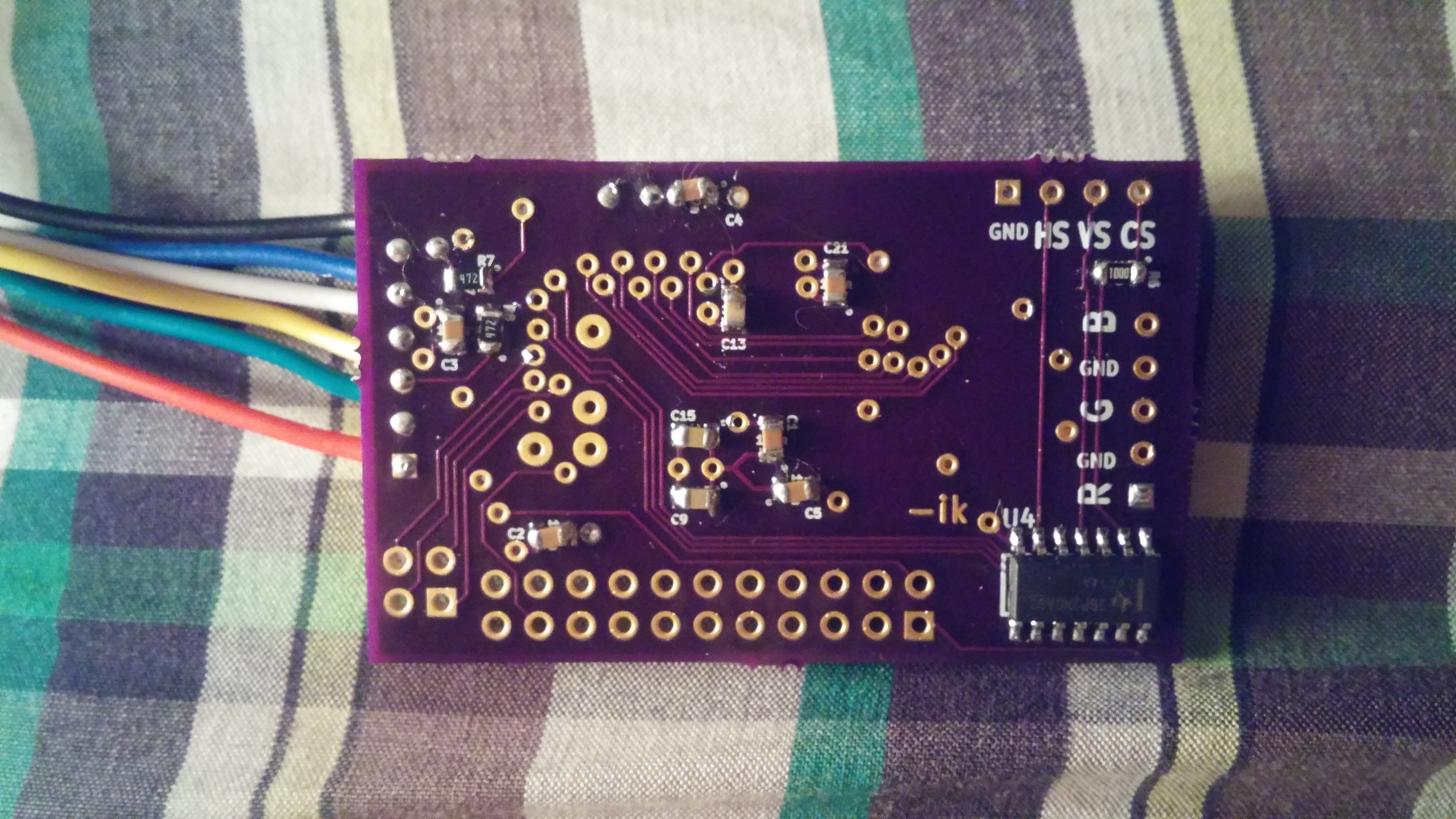

Thanks, yeah the soldering was a pain for me also, but in the end it worked. I just ordered some of the shuriken boards also. Im exited about them I really just wanted the GC-video Lite to try and use with the 5" good display in VGA, installed in an old intec screen case. Hopefully that turns out okay.andre104623 wrote:Very nice I just built one lite version last night and it was hard soldering this thing. After comparing both DVI and analog version I can firmly say that picture quality is much better with the DVI/HDMI. I'm still waiting for the Shuriken video V2 PCBs to come back from the fab. I'll see how it performs compared to the pluto 2x since I'm using the 200a FPGA instead of the 50a.marcus9199 wrote:Finally got around to building my own. Excited about installing in the rest of my cubes.

Here is my build of the gcvideo-lite. Came out ok I want to make it a little neater next time. It really is hard getting the caps and resistors to fit the FPGA and DAC are the easy part of this board.
watch out with all the solder splatter you have on the board, it could lead to a short somewhere if one of those blobs come loose...
remember how your other board blew up? could have been from solder splatter falling and shorting PWR GND
Also it might just be the camera angle with light and shadow playing tricks on the pic, but the RED 75ohm resistor looks like its floating over one pad. This might cause some interference or noise to display on screen.
Also take a look at the Lattice pins next to C10 and C12...
might just be the camera again, but it looks like there might be a faint string of solder shorting some of the pins on the FPGA
also you should avoid soldering to the JTAG pins...you have no idea how pissed i was when you sent me that board to fix...
it is such a pain to try to JTAG a board that has previous solder on the pads...you are forced to solder wires or header pins just to update the firmware.
Instead attach header pins to your JTAG cable. Insert the header pins into the board and flash it that way with no solder method...
you will find it much faster and easier....also anyone who might buy one of these from you will thank you rather than cuss your name all night...

andre104623
- Posts: 694
Its just the camera. The debris your seeing is from the qtip i used to clean the flux. I check everything with a meter to make sure there are no shorts and are making contact. I will say that it wasnt easy soldering the caps or resistors in place but all in all I think it came out ok I will do better next go around. As for the jtag cables being soldered I have a better setup for the Shuriken video but the programmer was cheap and the connectors were not making contact.megalomaniac wrote:watch out with all the solder splatter you have on the board, it could lead to a short somewhere if one of those blobs come loose...

Don't judge my soldering skills with that ide-exi it was my first time and I was using improper tools. I have gotten much better this lite board was my first next one i will take more time to align components better
If you look at this pic you will see that every time i solder a fpga or hdmi connector i take a hd pic with my camera then i can zoom in to make sure that all pins are making contact.
Also I'm not making these for profit or mass production. I just wanted to try again since last time i wanted to build one of these i failed. I also made a few yet another usb gecko clone and shuriken video with xc3s200a. I solder for hobby and i enjoy building them only 2 people here bought a pcb i made. They are happy with them and i informed them that Im not a professional i just build for hobby thats the reason i sold them at cost. If either person had a problem with anything i would take care of it.
I said nothing about your skills on that ide-exi pcb...only pointing out a better way to JTAG using a no solder method
stay away from q-tips or anything that will leave behind all those strands on the board
try using a toothbrush...i prefer soft bristle...
...not the ones that have those massaging rubber bristles, just a cheap generic 1$ toothbrush
you might also want to consider a smaller tip for your iron. This will really help to decrease the amount of solder that stays behind on your components/pads...those pads are small enough and when you use a larger size iron tip it really makes it difficult to properly apply the heat onto the pad. A smaller tip should allow you to really get in close and make proper pad contact so you can eliminate any possibility of a cold joint....just make sure you also use a high enough heat setting when using smaller tips...
not sure what gauge solder wire you are using...something like 0.022" or 0.015" solder should also help

andre104623
- Posts: 694
Yeah i was using a chisel tip for everything thats because I couldnt find my 0.2 pointed tip. I have since found my other tip and can try soldering again with the smaller tip. Most of my stuff was everywhere becuase of the move out of my old job and into the new one I still haven't moved my toolbox from the shop thing weights over 3000 pounds because I tried putting it on the truck lift and it couldnt move it. Crazy how many tools I have after taking them out of the boxmegalomaniac wrote:I said nothing about your skills on that ide-exi pcb...only pointing out a better way to JTAG using a no solder method
