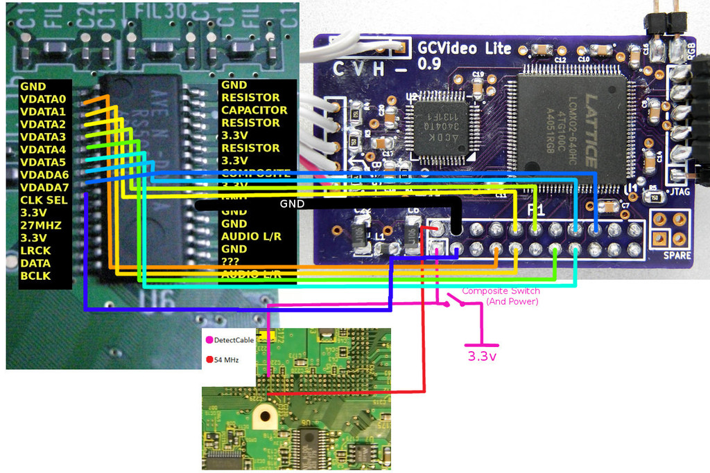

I made a little diagram for the sake of portables. Just a 5 minute wiring diagram using dirty portablizing tactics such as removing extra ground and voltage lines. I have yet to test it but it should work just fine. I excluded the csel and the 3 audio lines. Not sure if I needed csel though.
I'll be testing this later. Feel free to rip it apart.
EDIT:
Ok I added the CSEL Line so this should work with 12 wires, I'll update again after testing.

I am pretty sure you need csel.

Ok I updated the diagram and I have a GC-video lite wired up at home, I'm hopefully going to successfully program it tonight and wire it into a cube tonight.

the kicad render on the first page agrees with how you have your board wired for the jtag header. I think i may have read somewhere in this thread about the knock off programmers not really working, but I could be wrong about that. It was ages since I have read this entire thread and I am not up to the challenge right now. You could always look to the data sheet of the fpga and start there.

Yea the wiring all looks good, I can't get it much better with hand tools honestly.
