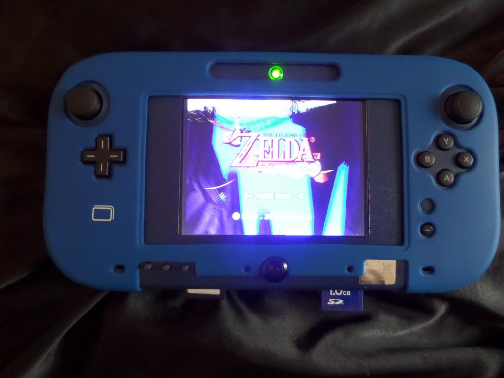

Here are some pics;

Specifications:
-Gamecube Revision B CPU 30 Motherboard with Medium Cut
-Thinkpad Heat-sink running off of 3.4 volts

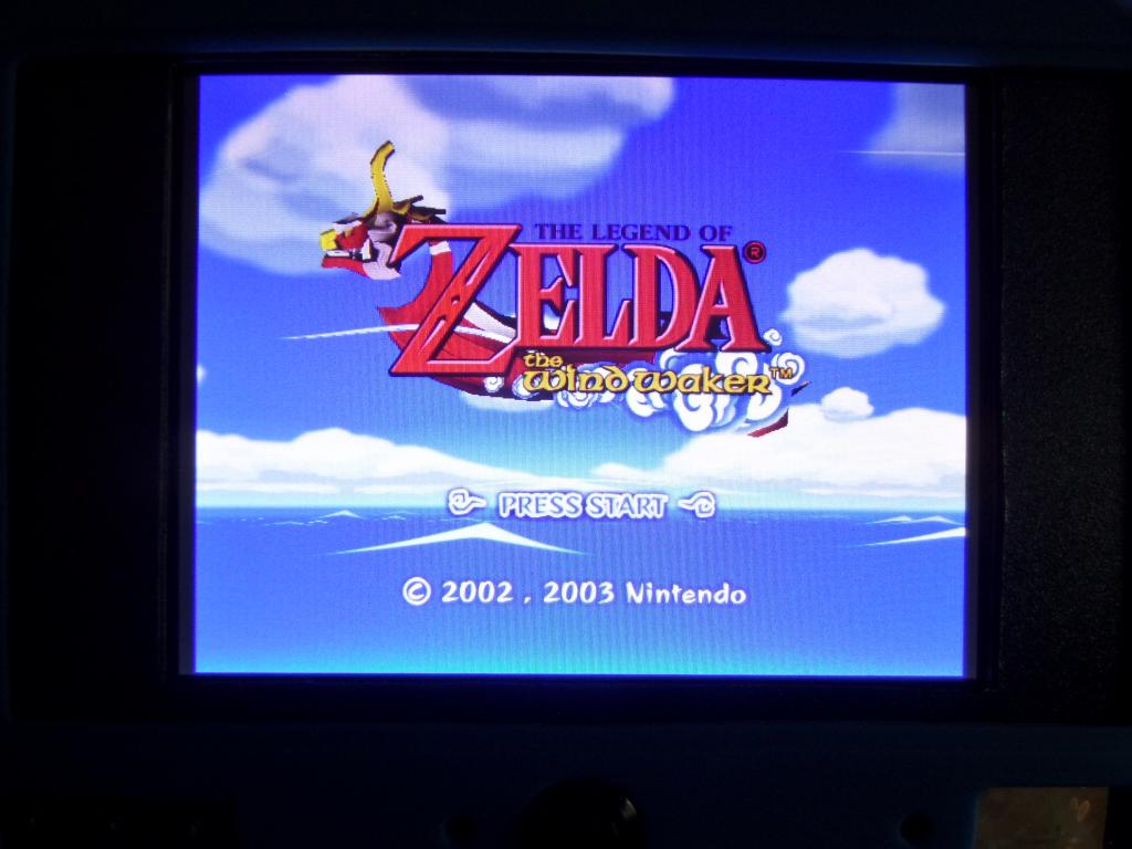

-Gamecube Component Cable chip wired in for gorgeous 480p Video
-5" Dalian Good Display with 640x480 native resolution for the best picture possible
-Wasp Fusion Flashed with swiss .3 Rev 275 (Props to Ashen, Megalomaniac and Emukid for this)
-Megadrive v5 (Props to Megalomaniac for this)
-32 GB SD card for storing games
-Internal 64MB Memory card (I already owned it and I didn't feel like buying a 128mb)
-SD Gecko
-7.4 Volt 4000mah Lithium Polymer Rechargeable Battery

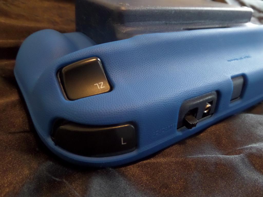

-Independent switches for controlling where power comes from ex: from battery or from power adapter and for turning the CubePad on and off.
-Fully functional switching stereo Headphone Jack
-Official Nintendo Wii U Gamepad Shell, Thumb Sticks and Buttons
-Official Gamecube Controller board cut to Ashen's specifications (Props to Ashen for this)
-L and R buttons modded using single tact method (Props to Zenloc for this)

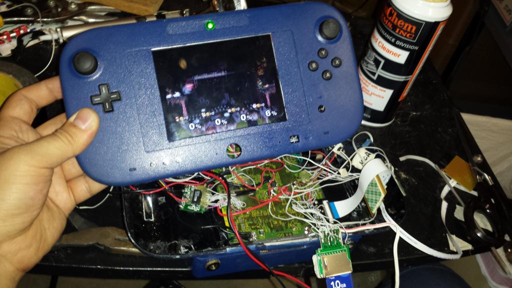

Fun Facts:
-I spent a total of 180 hours making this portable.
-I broke night a couple of times trying to resolve a few issues that came up.
-I went through a total of four motherboards while building it. I fried the first two and one mysteriously died on me. The fourth one was the charm.
-This is actually the second revision. With the first one, I had attempted to frankencase a shell for it from scratch using PVC. It didn't work out as well as I had hoped, so I got a broken Gamepad from a buddy of mine and used that instead.
-I must have burned myself at least 50 times while working on this
