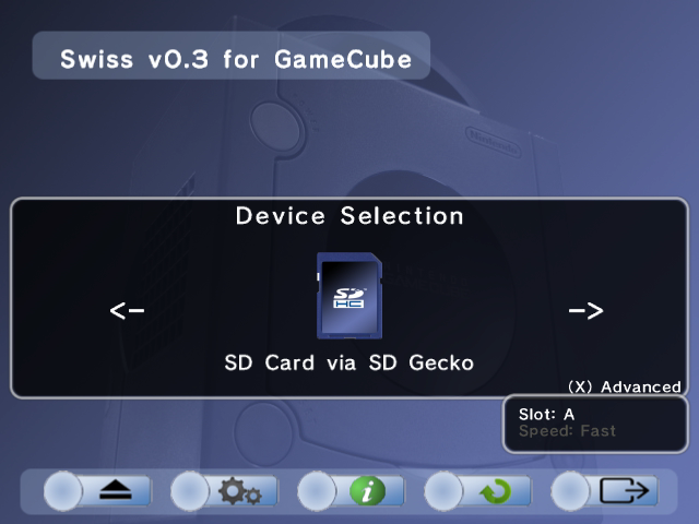

Setup:
GameCube PAL + Viper GC
DVD drive - No Disk unless specified otherwise.
SD Gecko Slot B / FAST / 32 GB SDHC
Swiss 0.3 R253 DOL
All games are Version 1.0 and "redump.org compliant" clean rips unless specified otherwise.
All isos have ben defragmented (using contig) as I have notices some games would not start otherwise (and swiss sometimes could not detect the fragmentation).
