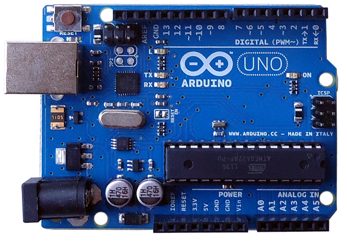

I had a frustrated idea in an experiment from another post ... but after I took apart the welds I realized that something was wrong ... :roll:
I saw that the atmega 238 can behave like the atmega8, at least that's what I understood when reading the datasheet ... :!:
do you think your fork would be written on atmega 328? :?:
is it ready for use already?
I have this equipment for the flash:
arduino for NGC
(185.51 KiB) Not downloaded yet
