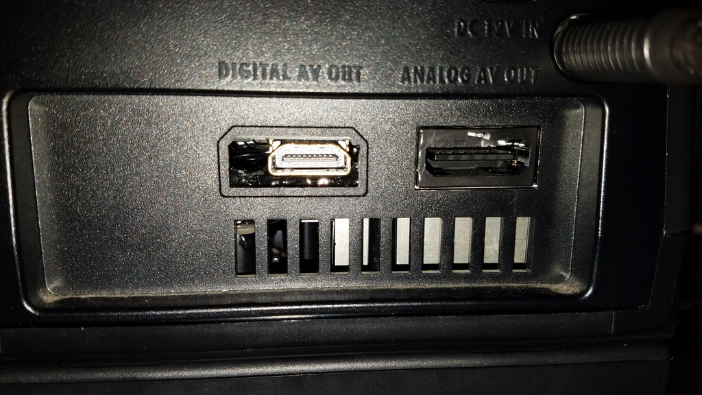

Personal preference and I got mine within 2 days of ordering it. I think the Pluto board looks just fine... Also you don't HAVE to remove the digital port (though I have no idea why you would want to keep it since you will now have hdmi), you could do some cutting around and mount it above the digital port and just make your attachments with wires on the bottom side of the digital port. I think mine turned out really well, the open area doesn't really bother me and if I cared that much I would just pump some black caulk around it.
