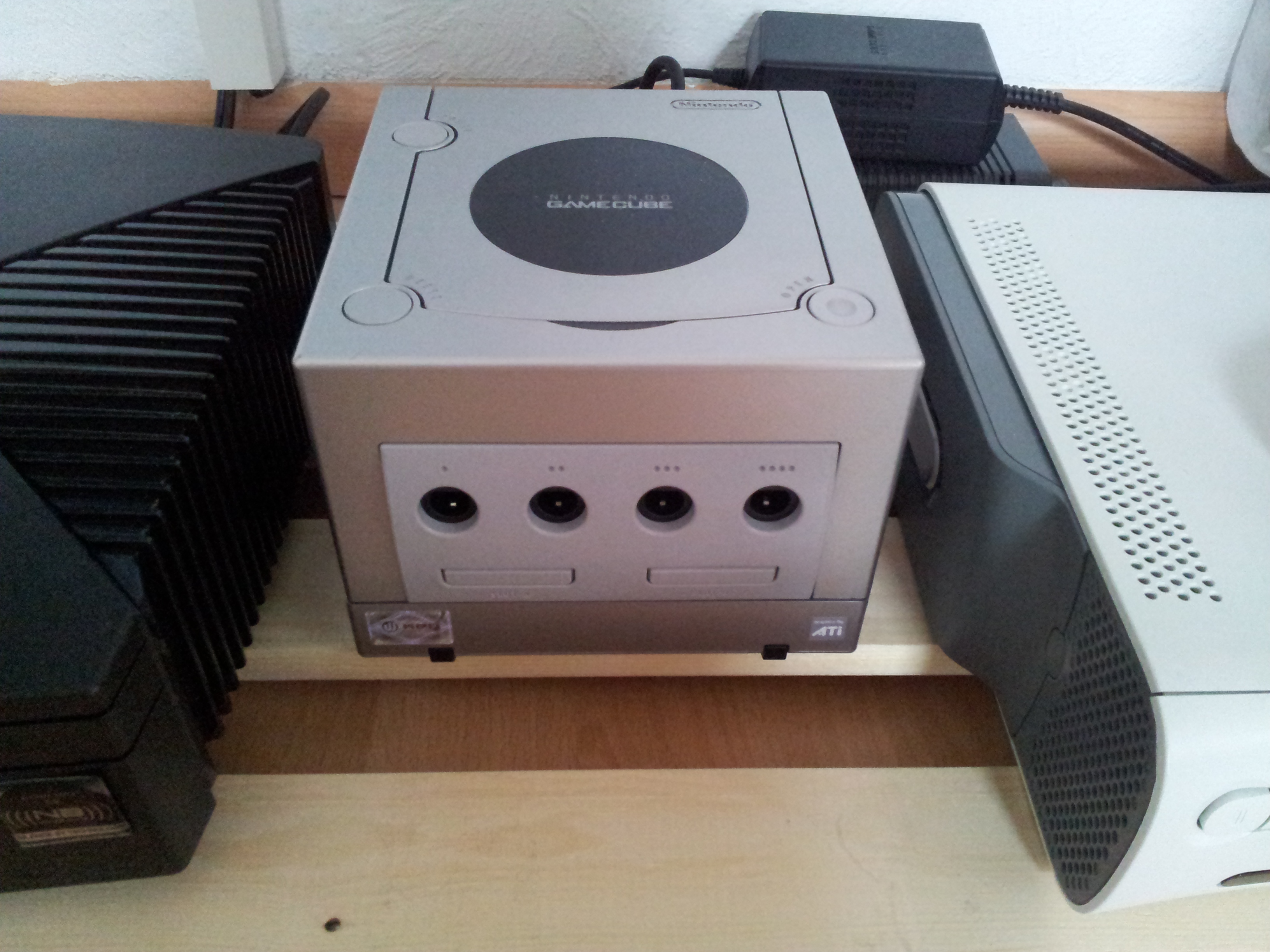

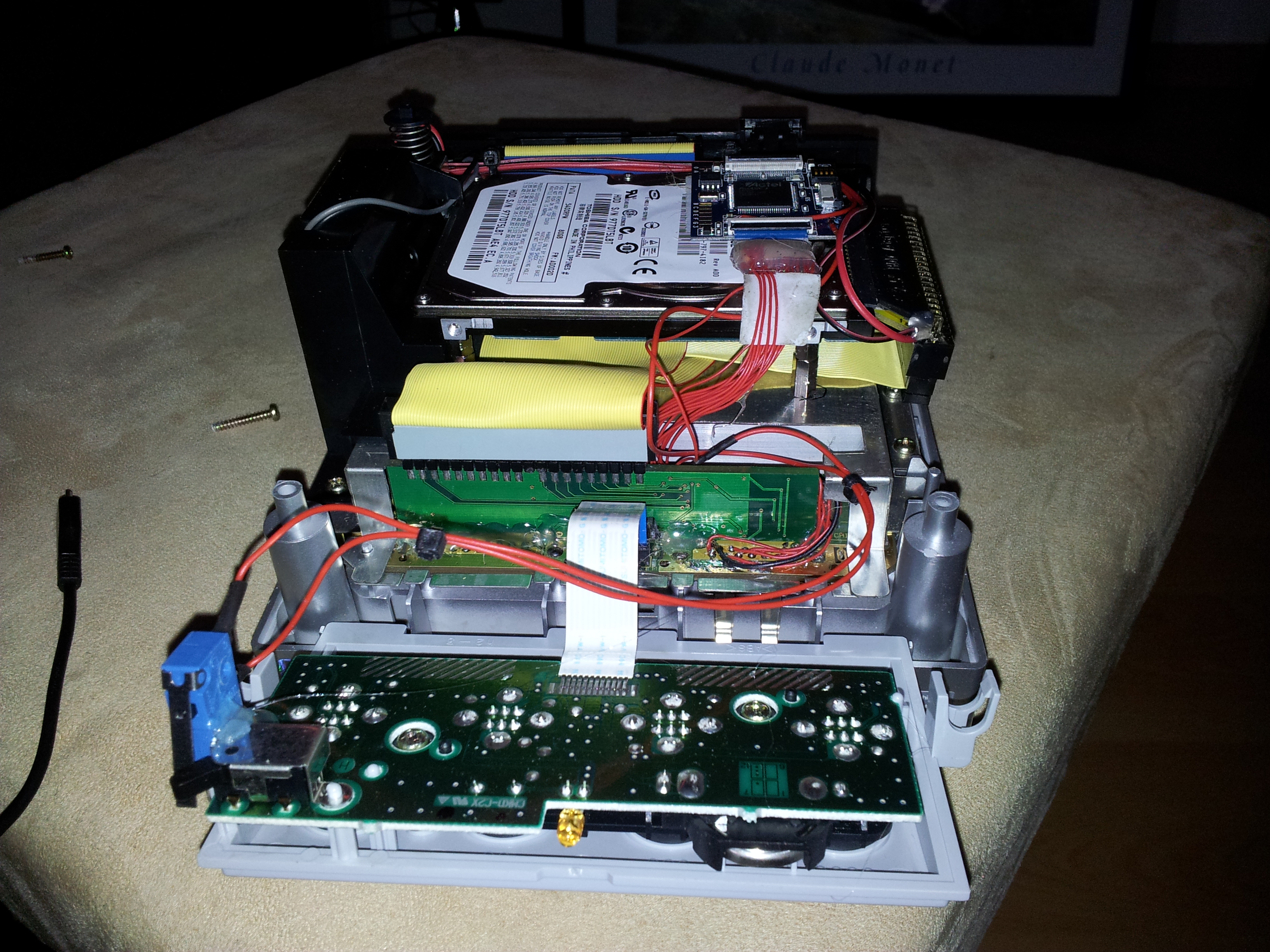

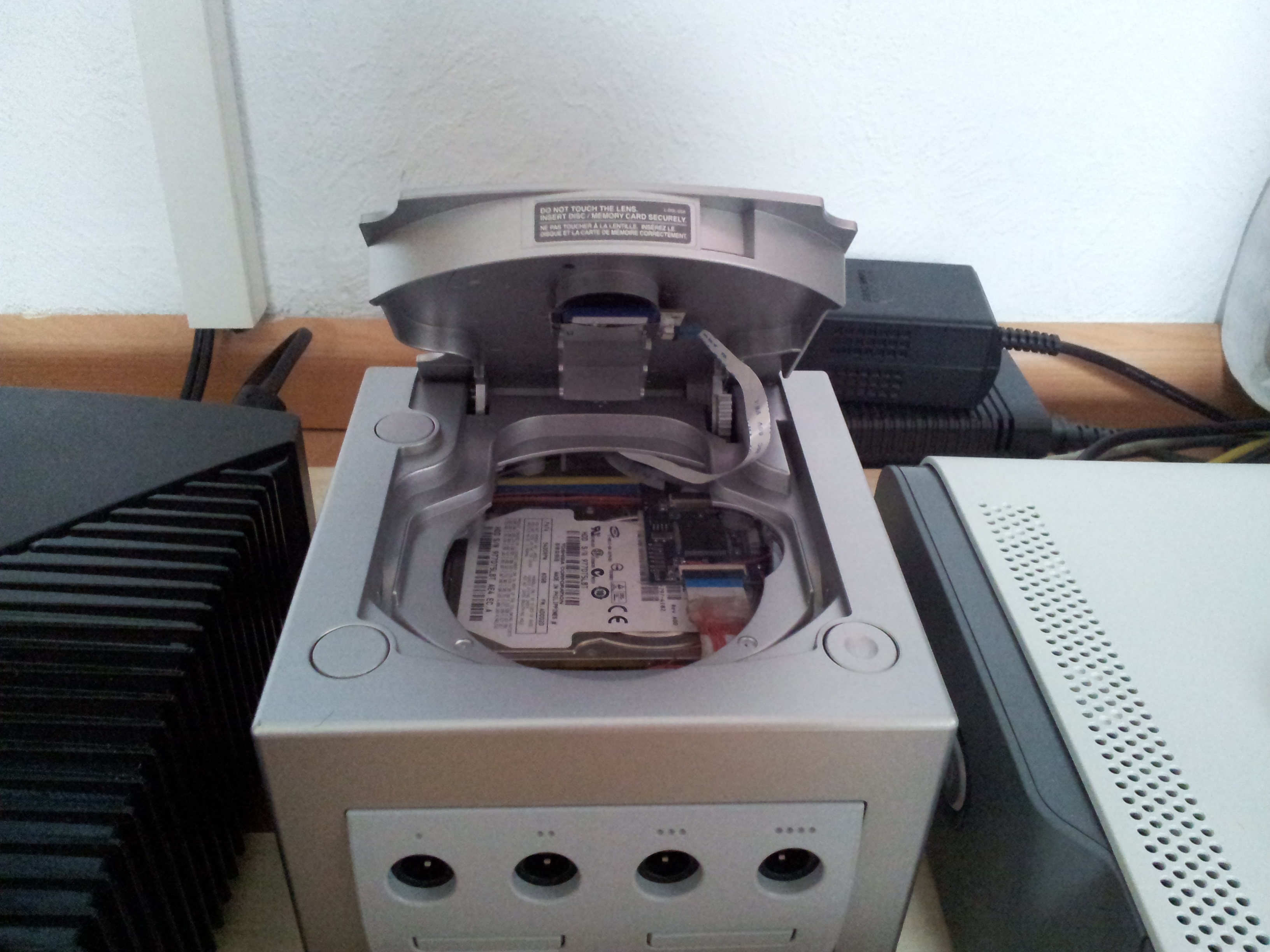

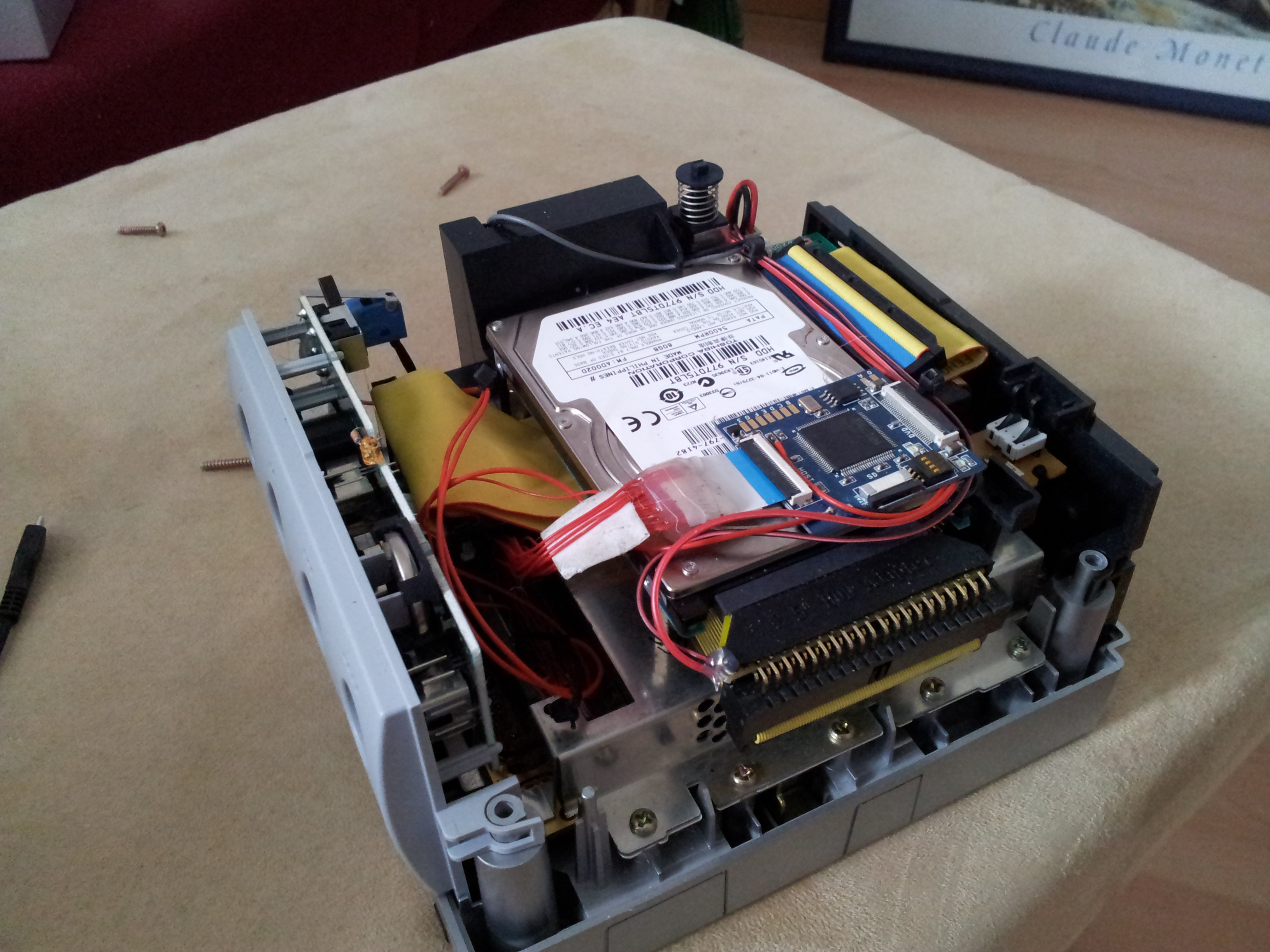

here is an other fusion cube from me:
specs:
integrated ide/exi
integrated 80GB IDE HDD
integrated 256MB memorycard
integrated wiikey fusion
Only waiting for DMA support.
specs:
integrated ide/exi

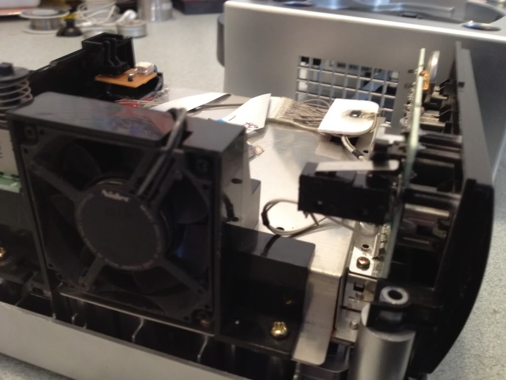

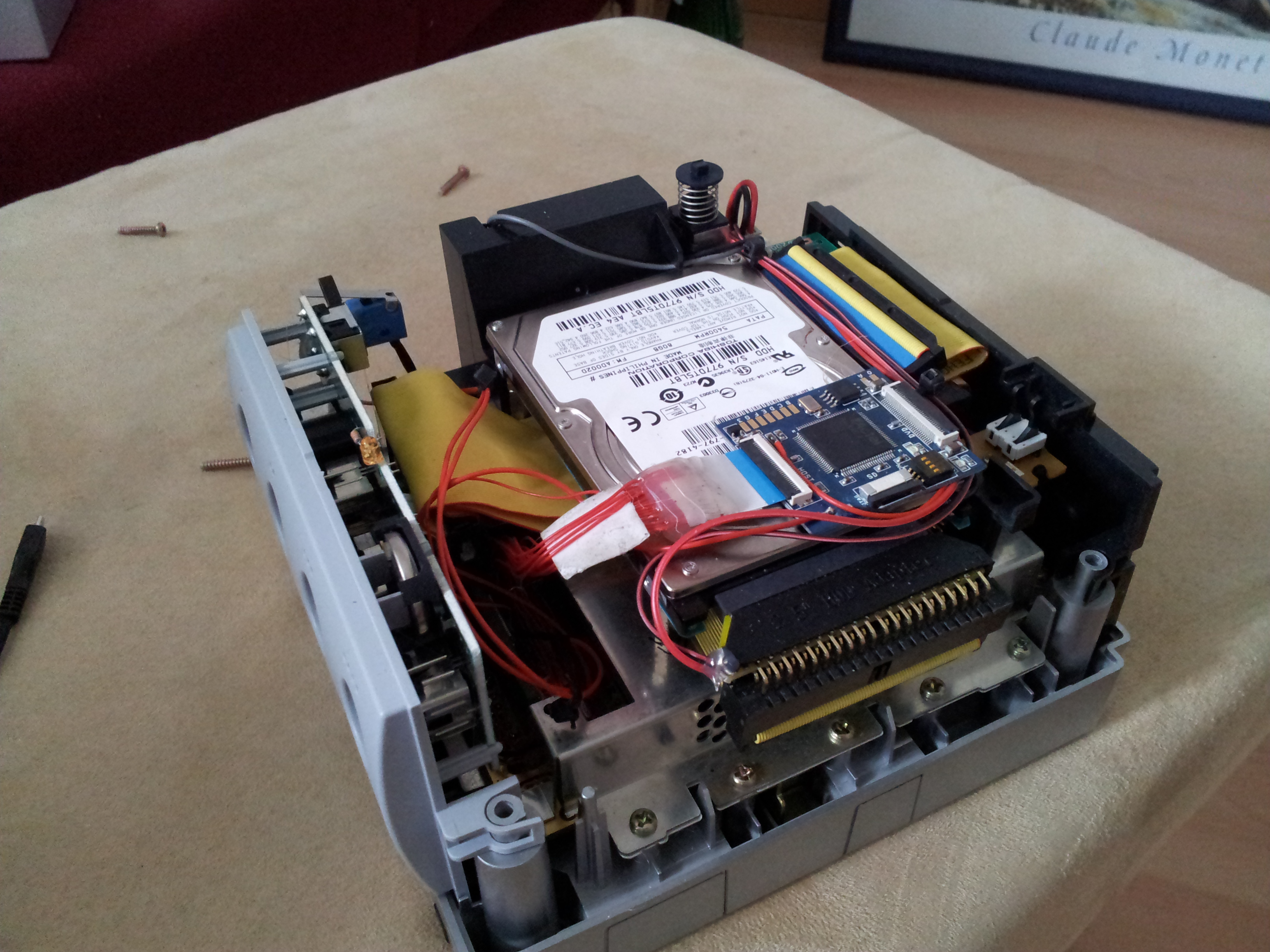

added two more pics from the inside. only the memorycard isnt visible because its soldered on the bottom side of the mainboard.
- Posts: 448
- Location: Germany
no, I put another switch with hot glue directly under the reset button of the gamecube. when I press the reset button both happens. the gamecube resets and the wiikey fusion too.
Looks awesome man! I love the reset button trick. Does that allow the GC to "autoboot" to the wiikey menu after the reset then?
- Posts: 448
- Location: Germany
sometimes, not at every reset.
very freakin' nice!
how do you access the hdd?

yeah thats the problem. I have to open the case everytime when I want to put new things on it. maybe swiss gets in the future file browser then I could copy things from the sd card of the Wiikey via the IDE/EXI to the HDD.
But until this happens I have to open the case, disconnect the IDE/EXI and connect the IDE/USB adapter.

how do you use usb?
Y-IDE cable, a switch (toggles ide-exi/ide-usb mode) and an usb2ide adapter.

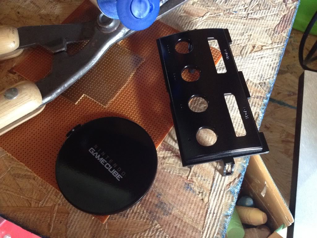

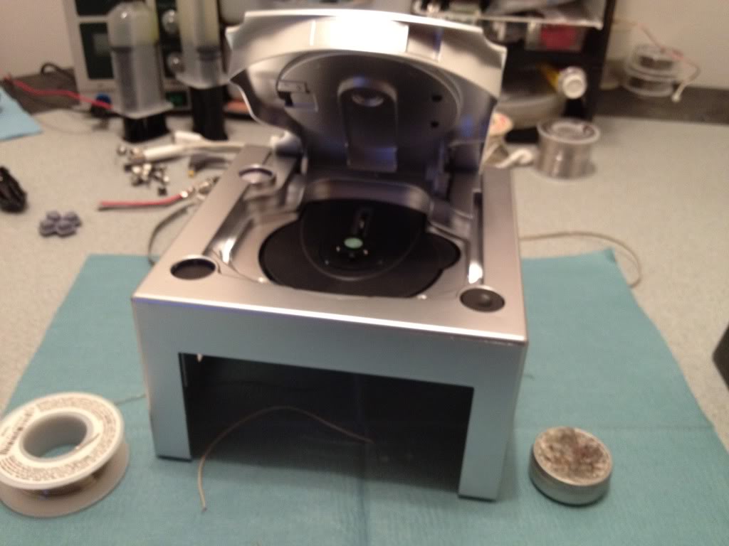

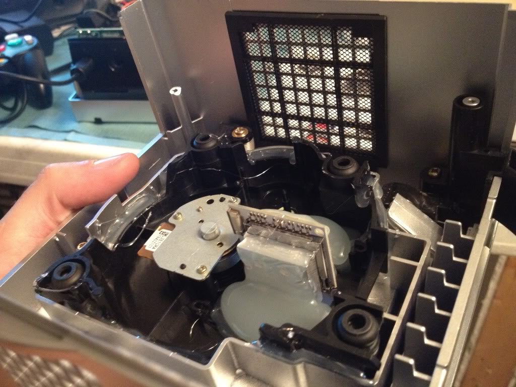

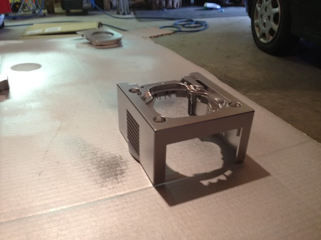

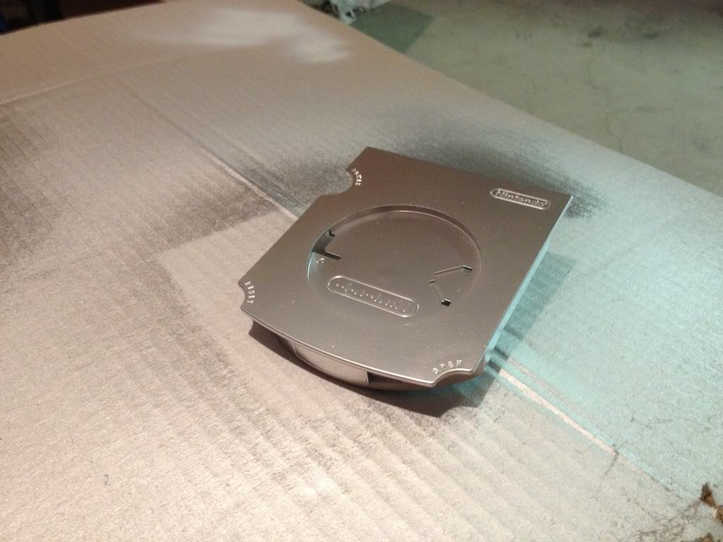

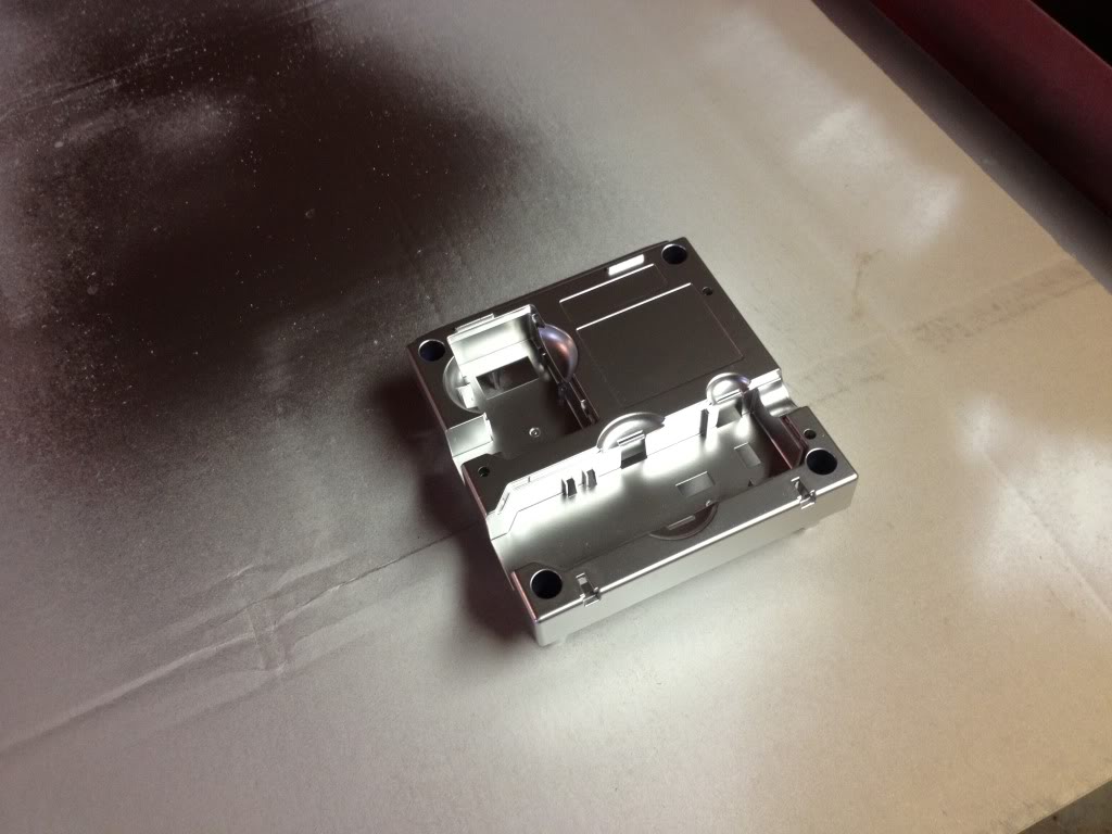

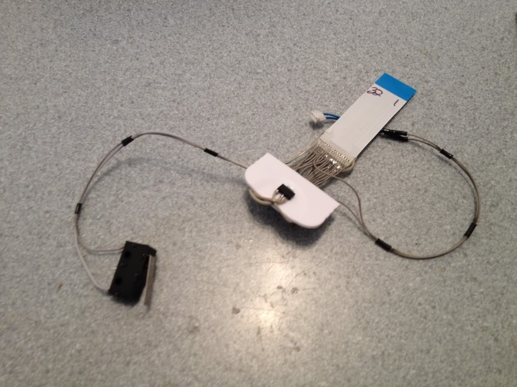

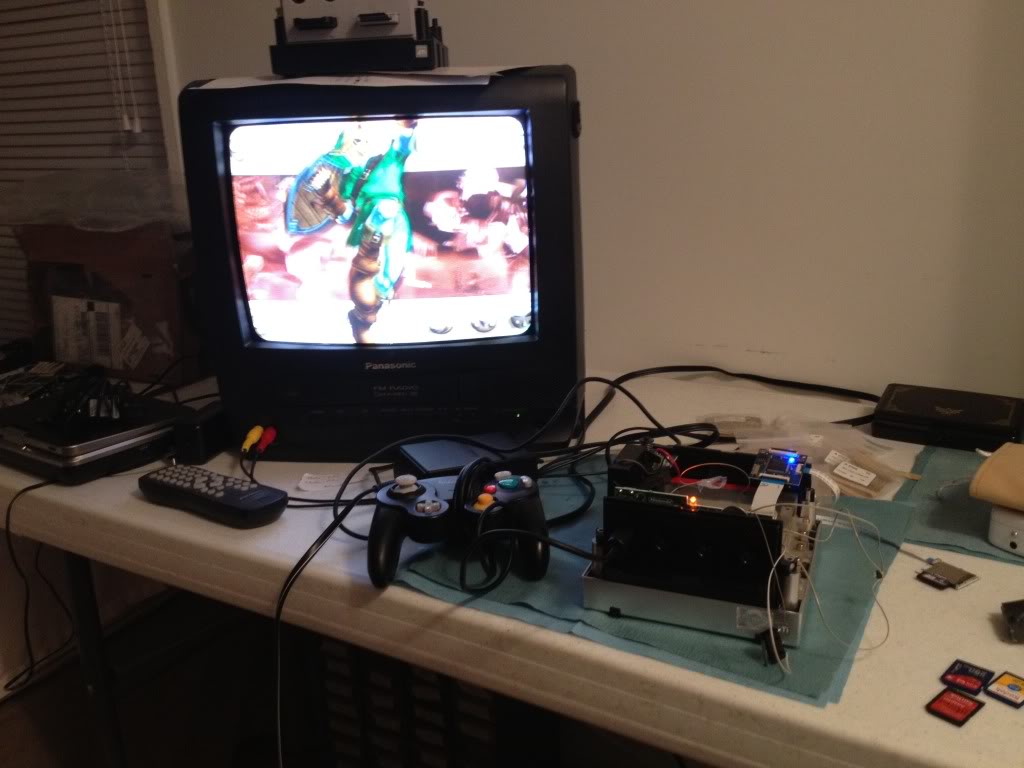

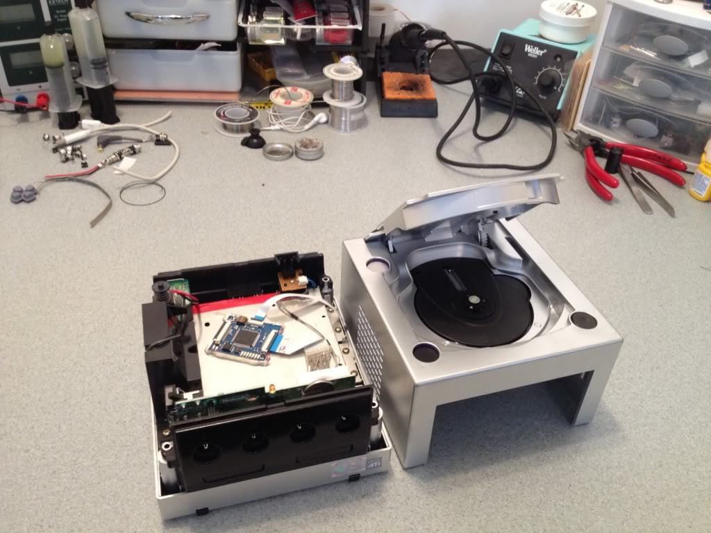

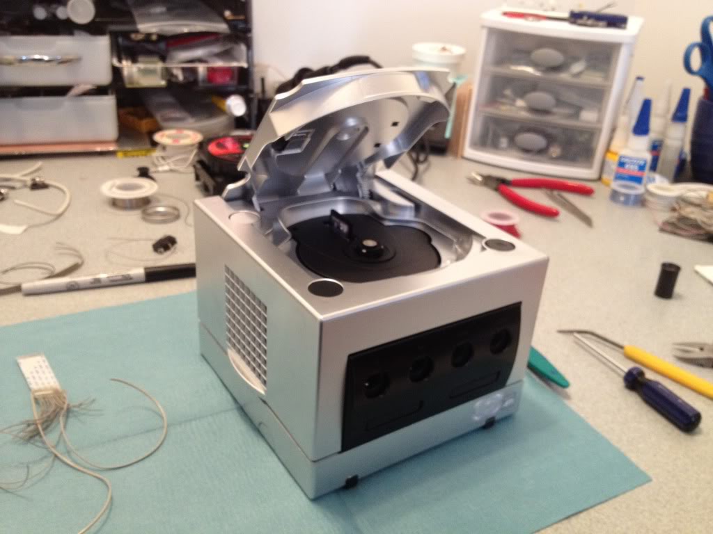

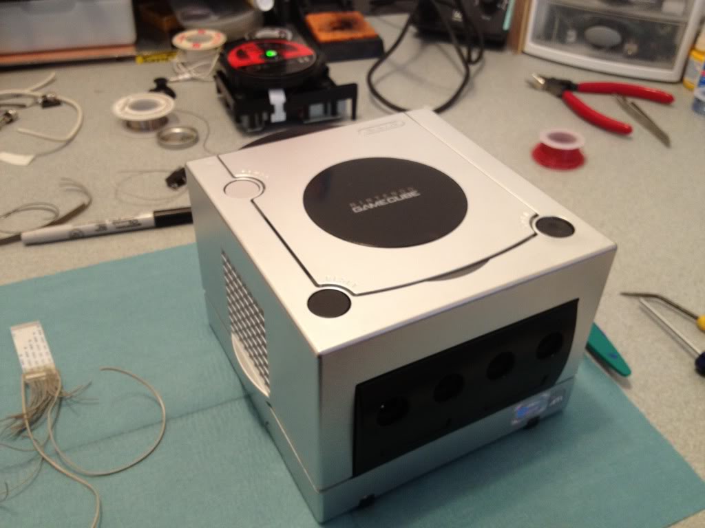

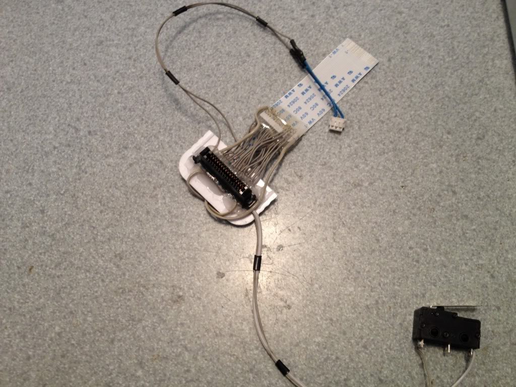

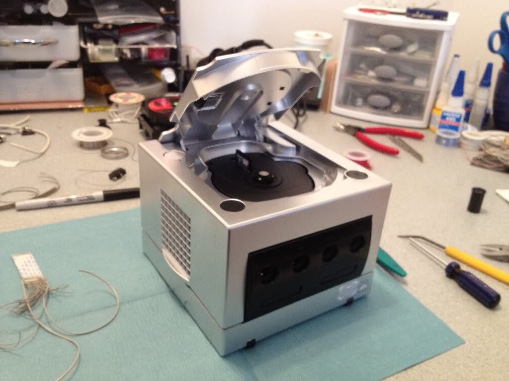

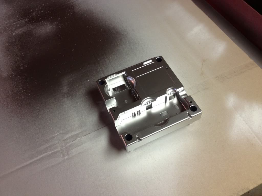

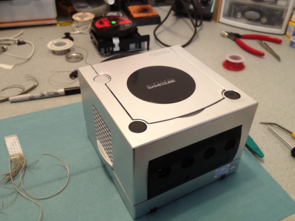

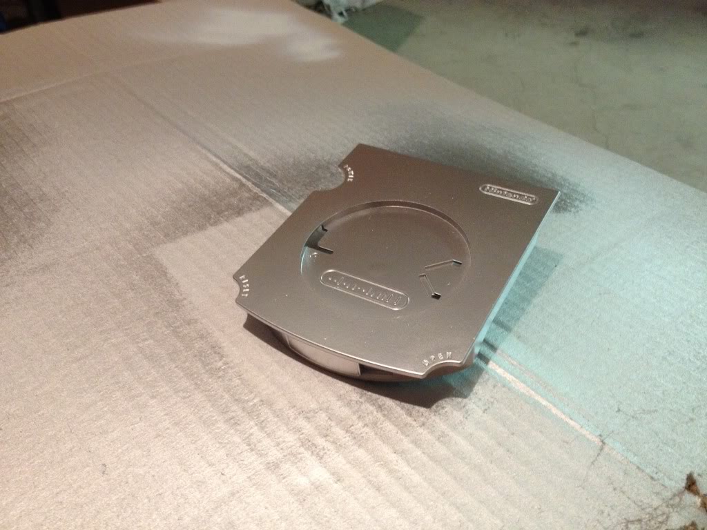

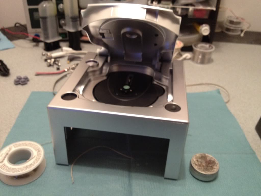

MRTN's super hot manlove Melee sessions left Bud wanting more when he got home. This is what I came up with to fulfill Bud's desires.
Not really much Bud specified besides wanting a platinum cube, and having the Wiikey's SD slot mounted the way Hail did his. I didn't have any decent platinum cases, so I took the sexiest indigo case I had and gave it some new life.

I'm glad I've got an awesome portablizing pal to hook me up with a kickass GameCube
I can't wait to get it!

damn ashen...every time you post pics i tend to look more at your clean and tidy workspace...
so organized...
when i organized my stuff i cant find anything....
i leave everything scattered all over and still cant find anything...
nice paint job...
