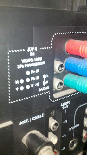

I just noticed that my tv has this
cannot wait to test it!
- (84.86 KiB) Not downloaded yet
