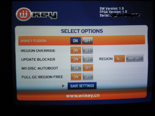

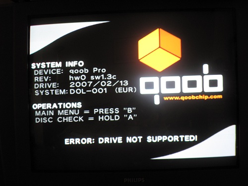

Installed a Wiikey Fusion, not yet the drive, but I have questions:
- Qoob Pro is not compatible, because mine says with Fusion 'DVD DRIVE NOT SUPPORTED' ? : edit: oops, bioschips and drivechips, ofcourse...
- How can I enable 'flat mode'
? This is my options screen, when 'Wiikey Fusion' set to off, Fusion still loads (or maybe when it detects a DVD-drive it is passing the signal through)?:
- Can the Fusion give 480p on a PAL Cube? Because everytime the output is a true PAL signal, no matter if a PAL or NTSC game is loaded. And I need NTSC, before enabling 480p with button B I think? edit: maybe Swiss can help, trying.. Ofcourse not, can't load Swiss after Fusion loaded a DVD
Edit:
Maybe a more easier solution for this problem: A switch between 3,3v wire towards Fusion and 5v wire towards GC-drive, so you don't have to switch between, like 19 data-pins? And we have a vanilla drive again.
But, does the GC-drive need so many 5v lines (there are 4 lines)?
- (69.49 KiB) Not downloaded yet
- (57.5 KiB) Not downloaded yet
