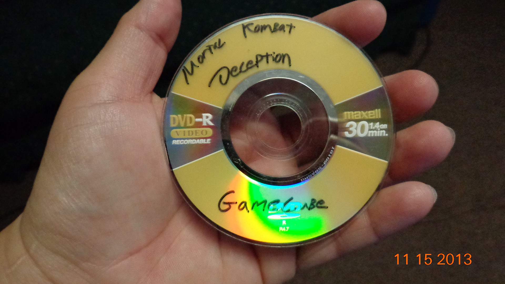

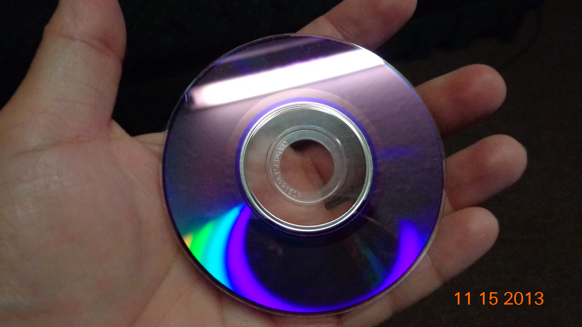

These are the Mini Discs i use for my GameCube, currently ran out.
has dark color to it.
i tired full size Philips DVD-R i noticed it has a slightly brighter color and my GC will not read them at all.
