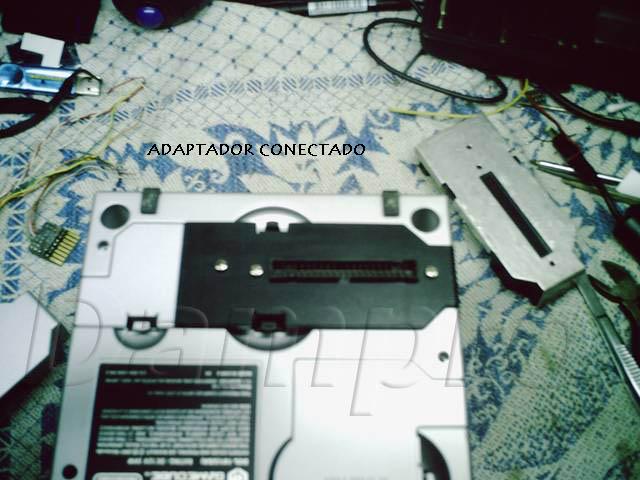

A fellow Gamecube enthusiast has created a DIY HDD (IDE only) adapter for the EXI bus on the Nintendo Gamecube!
It's a simple device, but something the GC could definitely use .. I know I'd love to see some GC-Linux support for this thing :)
Best part of all is that once he gets around to it, instructions on how everyone can build one from a few parts easily found (even certain old PS2 modchips can be modified to do the job - it's that easy) will be released.
Click here to see pictures!
It's been tested so far with a unofficial modified SD-Boot 0.3, and the speed is quite good in games. I haven't built one nor know how to yet, but I'd say it probably reads at about 1mb/s from the HDD, which is not bad considering the code isn't very optimized. Regardless, I'll add in support for the adapter in the next version of SD-Boot (working title) which is coming up nicely.
Note, the HDD adapter is not a DVD replacement, and as such, cannot be used to play backups. The author has simply modified an older version of SD-Boot to add in support, so the compatibility with backups would only be as good as the software (0.3 wasn't too great).

kevstah2004 wrote: 1. EXI bus you say which port?, i'm guessing the memory card slots with a hdd adapter since you mentioned sd-boot are the serial ports any faster? was serial port 2 ever used for anything? is the Game Boy Player Hi Speed Port faster than serial 1 or 2?
2. I'm suprised no one has tried anything like this before or butching a sdcard to usb hdd adapter given that people have made ide to sata adapters for the ps2,
3. What ever happened to that sd adapter for the dreamcast? I saw a pic of one for the master system or mega drive too at some homebrew scence meeting, it was during a bbc interview for Click with Clive Sinclair a few weeks back http://www.bbc.co.uk/programmes/b00t1c1x
1. It will go where the BBA goes, but it should work from any port depending on how you build it, and where the software looks for it. (It can be Memory Card Slot 1, 2, or Serial Port 1 or 2). Serial Port 2 was never used for anything and was later removed on the last generation (Platinum) DOL-001's and all DOL-101's. The Gameboy Player Hi-Speed Port is much faster than the EXI bus as it's an extension of ARAM (81Mhz) vs EXI(27MHz). Using the Hi-Speed port is an undocumented and difficult process, this is why no one has used it before (for Homebrew).
2. It would be quite difficult and expensive to make a SD to USB HDD adapter.
3. The Dreamcast SD adapter was made, and so was software to play backups from it: http://www.dc-swat.net.ru/news/16/
It loads homebrew isos and now with this update it loads "backups", it still doesn't support cdda but the game will just run fine it has some minor lags when loading but nothing important.

darkzero wrote:Diagrams? Author site? Fake? DVD Emulator?
Diagrams will be released soon, 4 units have been built without any issues so far :)
The author doesn't have his own site, but his alias online is "Dampro" (Damián) and he's from Cuba. His english isn't too great, he's decided to publish his work on this site "because it's the only place devoted to GC homebrew after tehskeen died".

emu_kidid wrote: 1. It will go where the BBA goes, but it should work from any port depending on how you build it, and where the software looks for it. (It can be Memory Card Slot 1, 2, or Serial Port 1 or 2). Serial Port 2 was never used for anything and was later removed on the last generation (Platinum) DOL-001's and all DOL-101's. The Gameboy Player Hi-Speed Port is much faster than the EXI bus as it's an extension of ARAM (81Mhz) vs EXI(27MHz). Using the Hi-Speed port is an undocumented and difficult process, this is why no one has used it before (for Homebrew).
Thanks! how does this tally up against the dvd drive emulator? which provides the quickest.

Re: Homebrew HDD adapter for Gamecube
Post by emu_kidid » Thu Jul 29, 2010 3:27 am
Yes there should be some update about this after the weekend, and possibly installation pictures and diagrams.

Post by sm4rty » Thu Jul 29, 2010 12:09 pm
it would be damn cool if the diagrams and the software are looking for the adapter in memory slot B because you can use this adapter on wii when its connected to slot B
and this would be awesome :)
yamaharacer
Posts: 448
Post by yamaharacer » Thu Jul 29, 2010 1:18 pm
it will be connected to the seriel port, I think.
Post by emu_kidid » Thu Jul 29, 2010 1:45 pm
Slot A/B are also possible.
