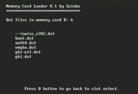

- McLoader: this program will search the memory card for dol files converted using dol2gci and allows booting them.

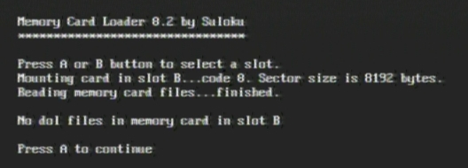

McLoader seems to have an issue with either searching for .dol's on PAL consoles or searching on the memorycard it is on.
I use the Homebros exploit to get into McLoader. My memorycard gets detected and all, but doesn't contain any .dol's according to McLoader - even through that program just booted from it. I need to pull the MC out and in again. So far this happened every time on my PAL console with the homebros exploit and the McLoader on the same card. Haven't tried yet to boot from Slot B on a PAL console with another card containing the exploit. (Will update on this)
The memorycard is a 1023 blocks 3rd party one.
On my japanese cube it works without much issues. I have an official card in Slot A and the above mentioned 1023 blocks card in Slot B.
suloku
Posts: 60
Joined: Wed Mar 31, 2010 12:55 pm
Re: DoLaunchers: McLoader and Brosexec
Post by suloku » Mon May 30, 2016 4:27 pm
Strange, my setup is PAL, so that shouldn't be an issue. I can't remember in which slots I tested, but it was probably both. In any case I don't have the hardware or the time to re-test, but I don't remember experiencing this issue.
I did have this issue before though some years ago, and workarounded it by trying to mount the memory card, if it fails, all memory card subsystem is reset and the program tries again. I tries to do this 10 times until reporting a mount failure, but when I coded that it always succedded in the second attemp. (https://github.com/suloku/dolaunch/blob ... main.c#L90)
That was many years ago, I just copy pasted the code from gcmm, so maybe swiss has a better way to mount the card. May you check if you have troubles with gcmm or swisss too?
Still, it's strange that it does not happen on a Jap setup.
Sierron
Posts: 161
Post by Sierron » Mon May 30, 2016 6:32 pm
That's the text when it detects the card but can't find things. *
Now with an official 59' Memorycard in Slot A and the 3rd party one in Slot B it detects the card and lists all the files.
I pulled the memorycard in and out multiple times with multiple restarts and was working good.
* It's showing B because first time with the setup above it didn't worked but that was probably only a temp issue.
