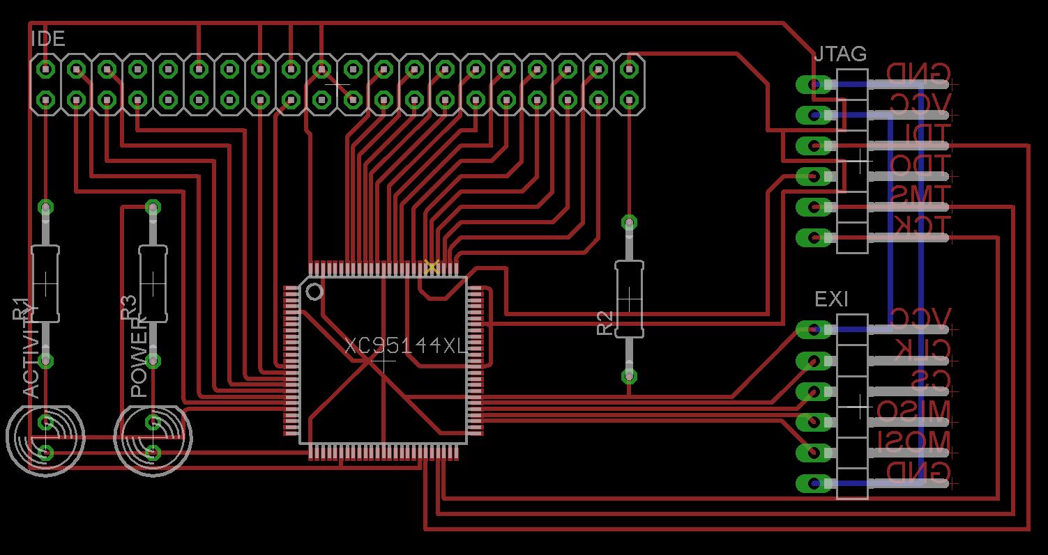

i cant help you with the schematics byt i can tell you what you need to make it as easy as possible.
your gonna need:
kynar wire avg30 something like it.
experimental board of your choise.
solder iron, solder and flux.
1 X 20x2 pinheader.
1 X 330 Ohm resistor (2 if you want a power indicating led).
1 X 10k Ohm resistor.
1 X led for activity (or 2 if you want power indicating led).
1 X XC95144XL-based chip, i used bluechip v9.
1 X GC memory card to sacrifice (or solder the exi wires inside the GC).
JTAG-programmer compatible with your chip.
maybe something more, but i think thats all.
if you use bluechip v9 or v10 i attached some pictures i got from emu_kidid, i modified one of them.

if someone want to etch a pcb to use, i made a design and posting it here. i think it is good but you have to change the pins in gc_ide.ucf.
it´s my first pcb design ever, but i hove you will enjoy it.
GC_HDD.rar
and here is the pcb design made in eagle layout editor 5.6.0
(26.8 KiB) Downloaded 1374 times
this is how it looks like
(170.72 KiB) Not downloaded yet

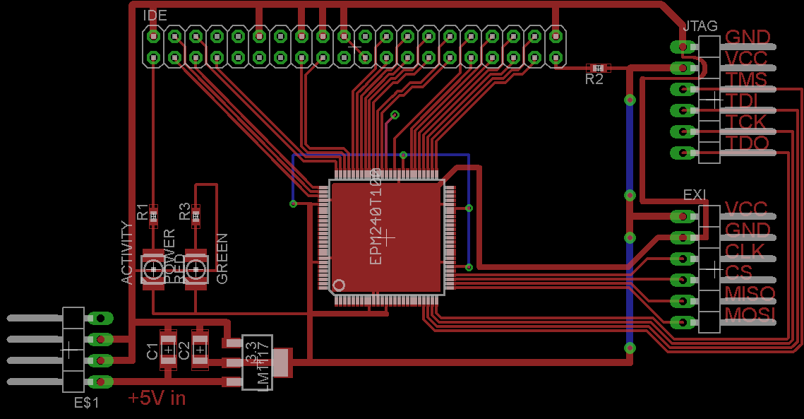

hi guys!
i am working on a port to altera epm240t100 right now, i tried with xc9572 but the code did not fit inside. as soon as my 500 uv-leds arrives and i can make my pcb and test it, i am going to post it here.
this is how the first layout looks like, it might change a bit later.
(23.88 KiB) Not downloaded yet
