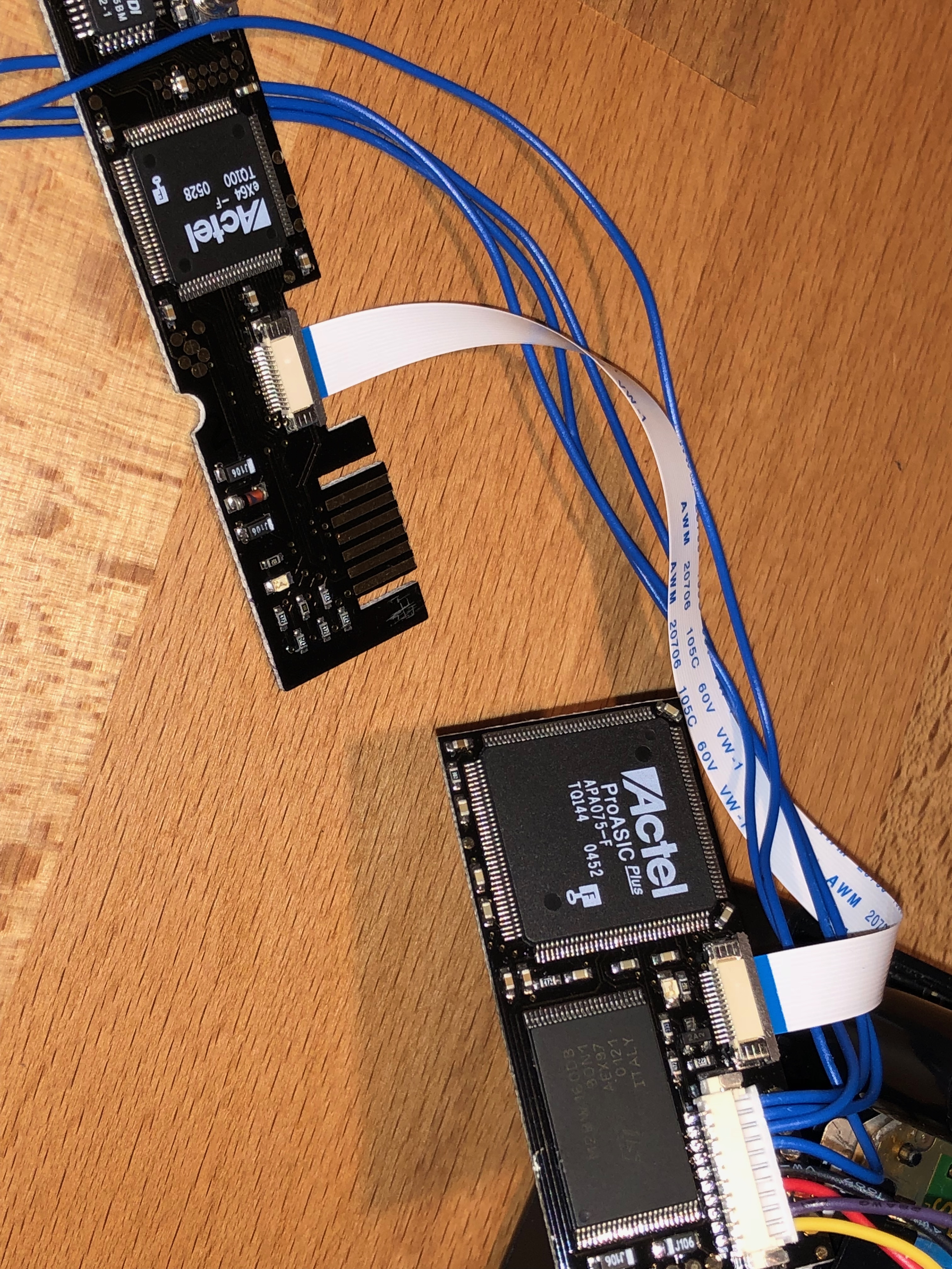

I'm still having problems with my Viper Extreme. I still can't determine if the chip/programmer is bad or something else is wrong.
Does the programmer need to be plugged into the serial port to program the chip? Obviously the FFC cable needs to be connected between the chip and programmer but does the programmer need to be inserted into the Gamecube serial port?
So far I've tried:
1) Re-soldered the chip to the Gamecube motherboard (and removed the heatsink to make sure the solder connection was good).
2) Purchased new FFC cables.
3) Created VMs for Win XP, Win7 x86, and Win7 x64.
4) Tried different combinations of dip switch settings.
5) Tried the Cobra Manager and the flash loader.
The loader says it detects the USB adapter but can't communicate with the Viper chip. (yes, the Gamecube is turned on)
The Viper Extreme has a solid blue LED if that means anything.
I don't want to give up but I'm not sure what else to try!

Is the FFC in correct orientation?
Re: Viper GC
Yeah... the blue tape side is facing away from the board and the other side is making contact with the board. (like this picture: http://ngc.scorpei.com/post2_images/sec ... w(big).jpg)
I've also purchased new FFC cables from Amazon (0.5mm pitch, 14 pin) and they also don't help.

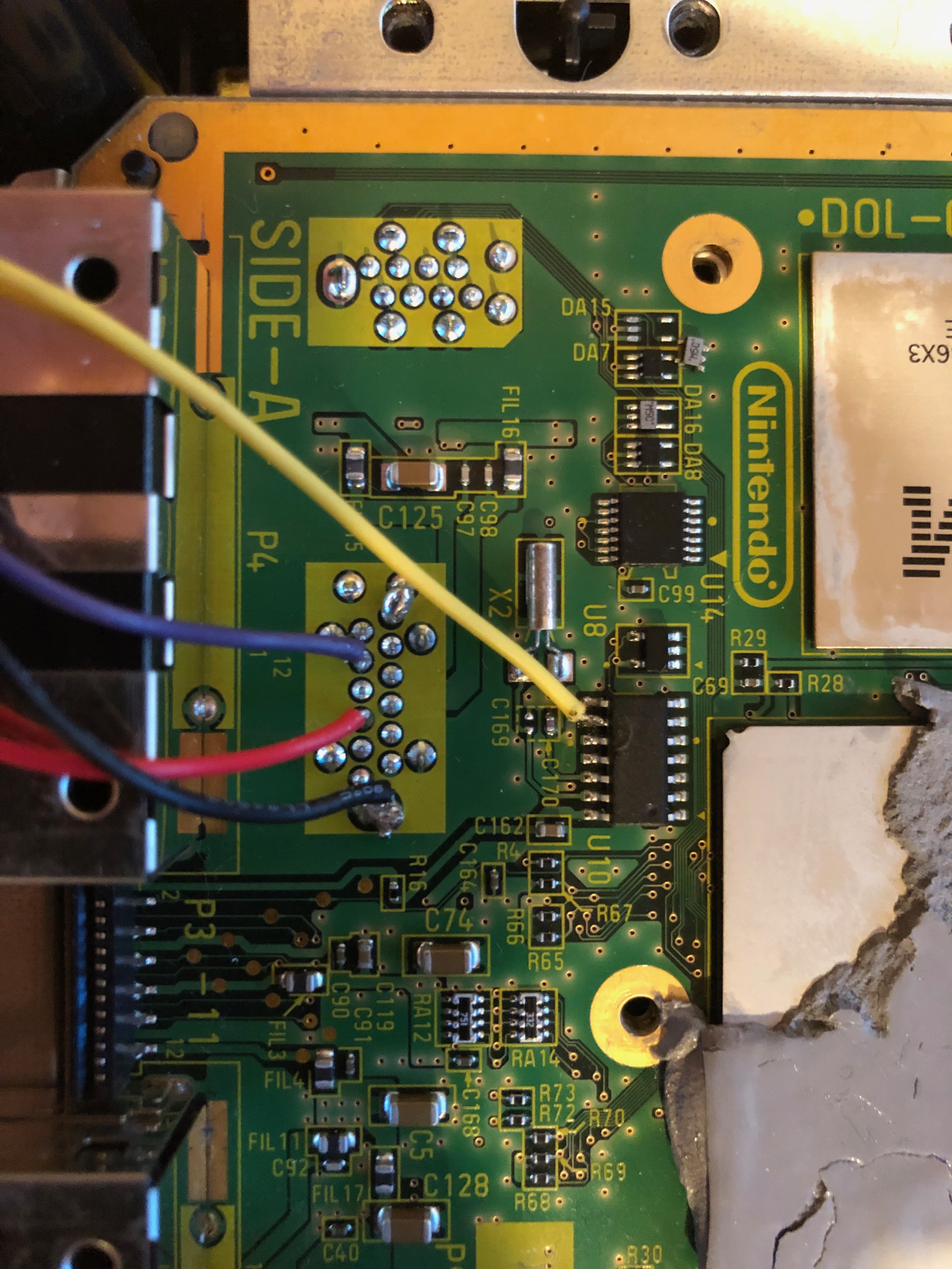

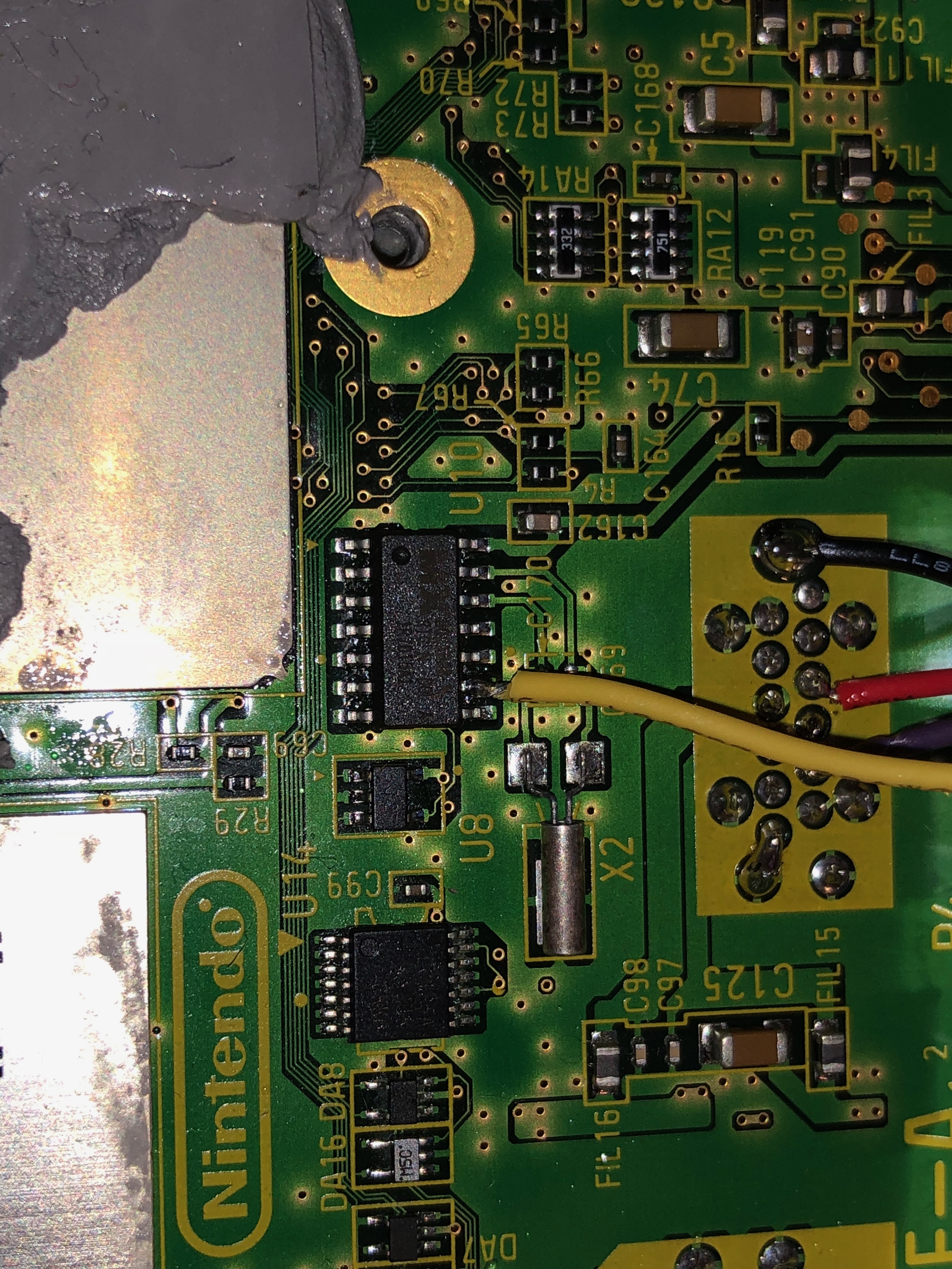

I've attached two pictures of my install.
If anybody has any last minute ideas please let me know ASAP. Otherwise I'm going to return this Gamecube with the chip to the person I bought it from.
EDIT: These pictures were taken after I removed the heatsink and disconnected the DVD drive cable to get better pictures. When I'm testing everything is connected as normal.
Thanks so much for all of your help everybody.

Looks like DA15 on your mainboard has been ripped off, though that shouldn't affect the chip. The wire harness solder joints don't look too great though so you might wanna try to fix that.
Re: Viper GC

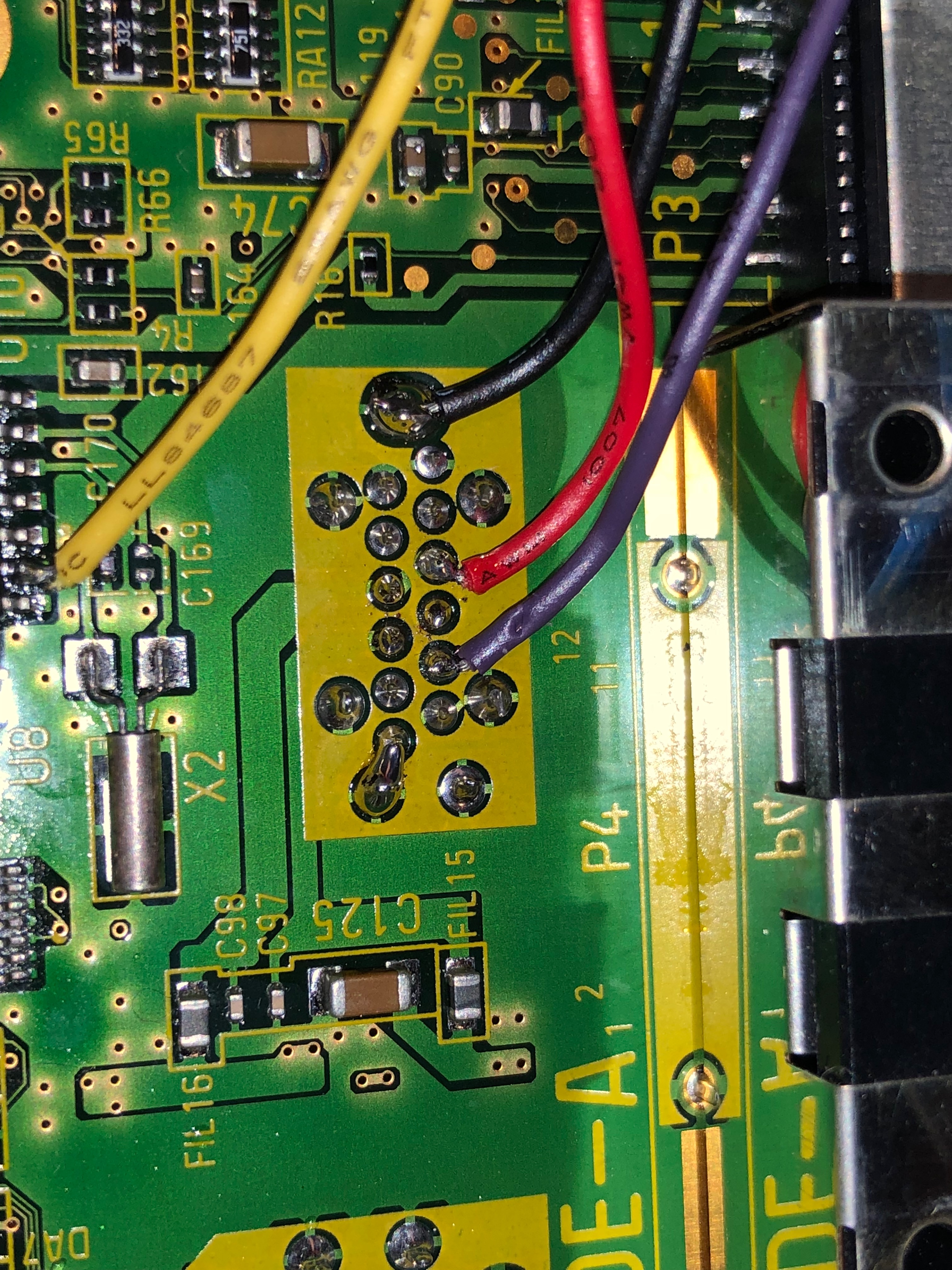

Thanks. I noticed DA15 right after the pictures were taken and I fixed it. I've also tried this chip on two different Gamecube motherboards. Also, that solder job was a little quick and dirty because I've desoldered those points several times.
Here are some more recent pictures of a much cleaner solder job but it didn't help at all.

At this point it's safe to assume that the chip has a problem. Since you said you could return it, you should probably do that and look for another one.
