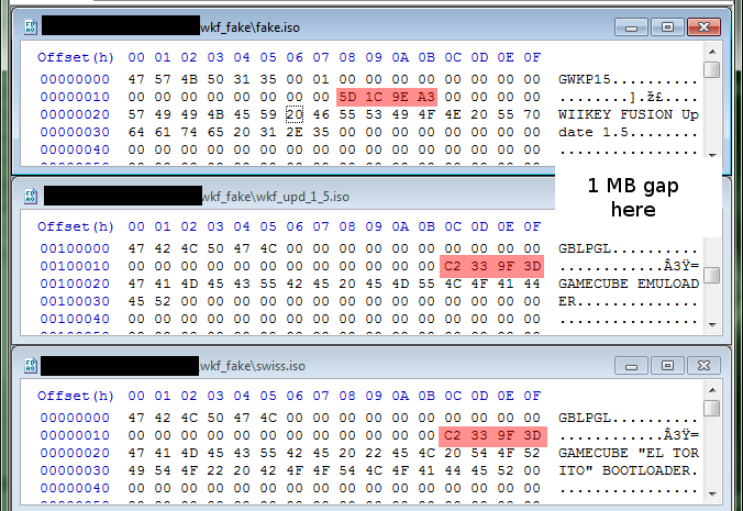

Well it is not a secret at all.
The Wiikey Fusion(->wkf) guys used it and I just used my hexfile editor to do the same.
But let's start with what I (and probably some other people) noticed:
- When we use a gamecube iso image on a wbfs sd card with wkf, the gc/wii resets and the wkf then loads the image.
- The wkf update discs act the same.
- When we add a gc iso image to the wbfs manager, it will take 1,36 gb regardless of the actual size, but a wkf update disc will only take 2 mb.
Have you ever opened a homebrew gamecube iso with a program like 7zip? You can view the files inside, because the iso file follows the ISO9660 standard.
I wondered why i couldn't open a wkf update disc in 7zip and looked closer at the ISO9660 file signature, which is "43 44 30 30 31"(hex) or "CD001"(ascii), also called magic word.
This signature usually occurs at byte offset 32769 (0x8001), 34817 (0x8801) or 36865 (0x9001) (said here).
So I opened a wkf update disc iso and a swiss iso with my hexfile editor and looked at the three adresses given. The swiss iso says "CD001", whereas the wkf iso only has empty bytes at these adresses. I searched for the string and found out that the wkf iso includes them at 0x108001, 0x108801 and 0x109001 which is exactly a 1mb gap to the standard.
The attached picture shows this. If you look at it you may notice that the content after the first 1 mb of the file will much look like the swiss iso. So I removed the first mb of the iso file and now 7zip successfully opens it and reveals the "FLASHERz.dol" which will update the wkf (nice to save this to sd card for update through swiss/sdload).
When I tried to add the cut wkf image to sd card via wbfs manager it will take the usual 1,36 gb.
So what is this first mb of the iso all about?
It may be easy: I think it is to trick the wbfs manager. Because it uses the wii disc magic word (0x5D1C9EA3, marked red in the attached picture) and not the gc magic word (0xC2339F3D, also marked), wbfs manager will add it like a wii disc.
It begins with disc header stuff (id, region, etc.) = first bytes (GWKP15). Then the disc title. The rest is zero fill bytes.

What I did to create the test iso for Ashen
It's easy: Create a swiss iso and add the wkf iso header. (Okay I changed the disc id and name, but that's it)

No, in fact not yet.
Let me tell why:
Because it is only a faked wii header, that the wkf team added to the images, the wbfs manager won't identify the file size and structure of this disc. So it will (speculation!
) use the smallest size available, which is somehow 2 mb. I tried it, it will only add 2 mb. Maybe if we fake the header a little more to include the file size, it works.
- picture showing the file differences
- (48.52 KiB) Not downloaded yet

you can't use the fake header on shrunk GC games (but you can for homebrew gcm files) because the games wouldn't be able to find their memory card files you've created before, let alone other issues that would occur (they use the disc id in 99% of cases).
I don't get your point.
As far as I can see, the wkf sees the fake header and skips it. So there should be no problem at all.
Ah, right you are! Never mind me, I didn't realize they slapped on a fake header and the real one was later on
I should stop browsing the web using text only and look at attached pictures more often :p
