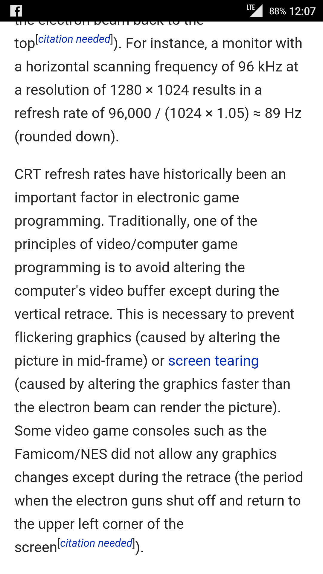

I may or may not have found the culprit. According to the wikia the horizontal tearing i am facing is due to the framerate of the ULL version. Some crt could be damaged because of framerate.
-------EDIT-----------------
- (306.27 KiB) Not downloaded yet

The problem you describe is not related to the refresh rate of the display, but because the GameCube and GBA hardware are not running perfectly in sync, and will slowly drift into and out of sync. What you're seeing is the effect of the cube starting to send a frame to the TV when the GBA is already part way through drawing the next frame. AFAIK this can't be fixed without a framebuffer, and the LL version of GBI is specifically intended to address this problem at the expense of one frame of extra lag. It also runs at a slightly higher refresh rate, significantly improving compatibility with display devices.
In other words, the solution to the problem is the LL version, if you want the lowest latency at all costs, put up with the tearing.
You're not going to damage a PVM with any of the refresh rates supported by GBI like the ~59.7 Hz of ULL: the PVM is designed for both PAL (50Hz) and NTSC (59.97Hz), and 59.7 falls within that range. The compatibility issues come with the timing on the colour signal not being quite what is expected of NTSC.
