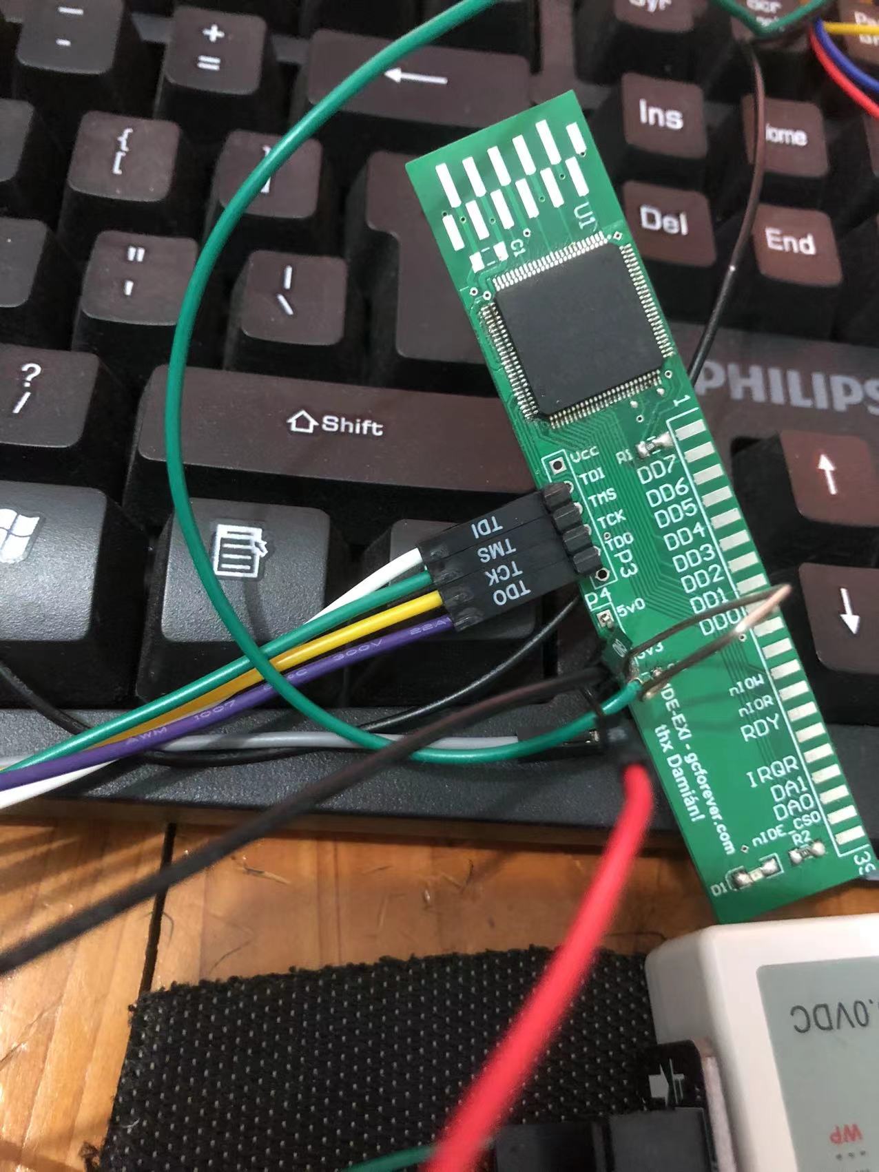

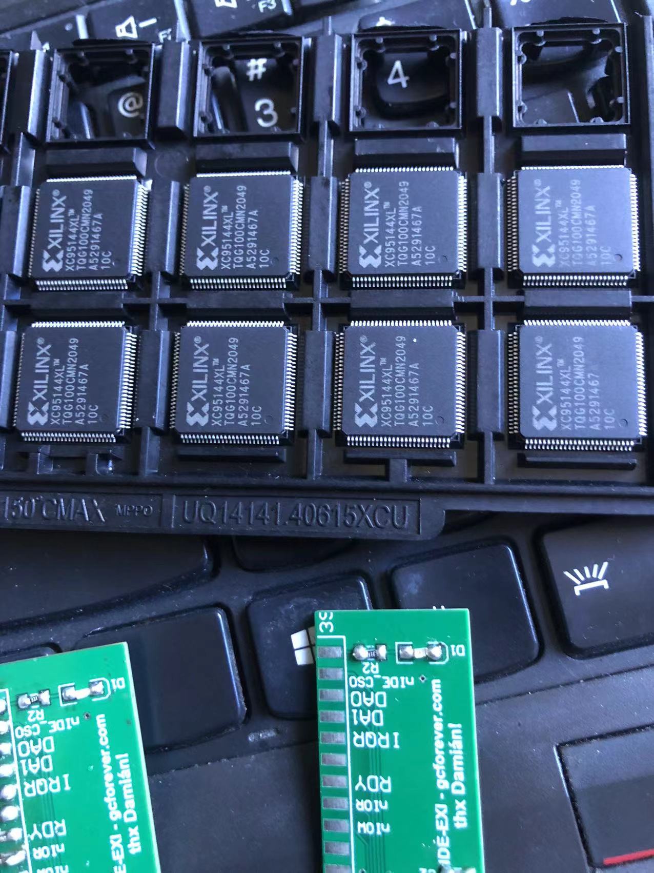

by hpxhpx » Sat Nov 06, 2021 12:59 am

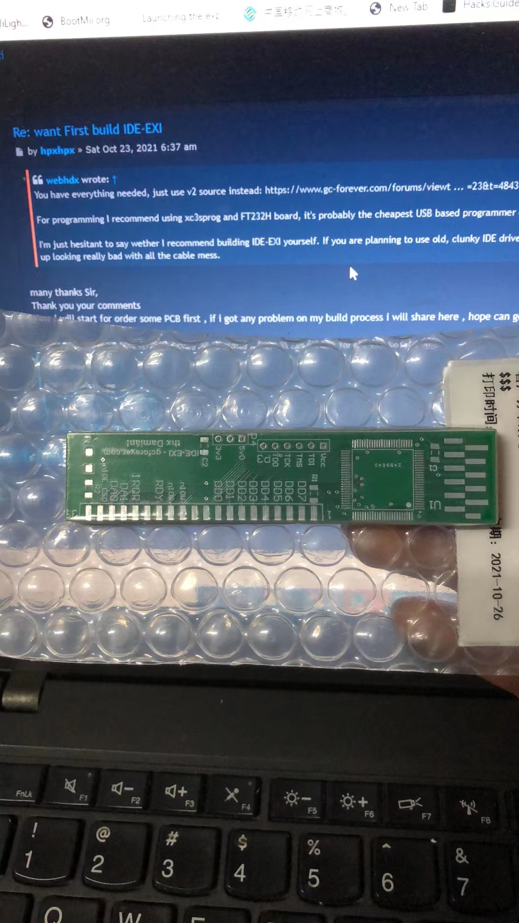

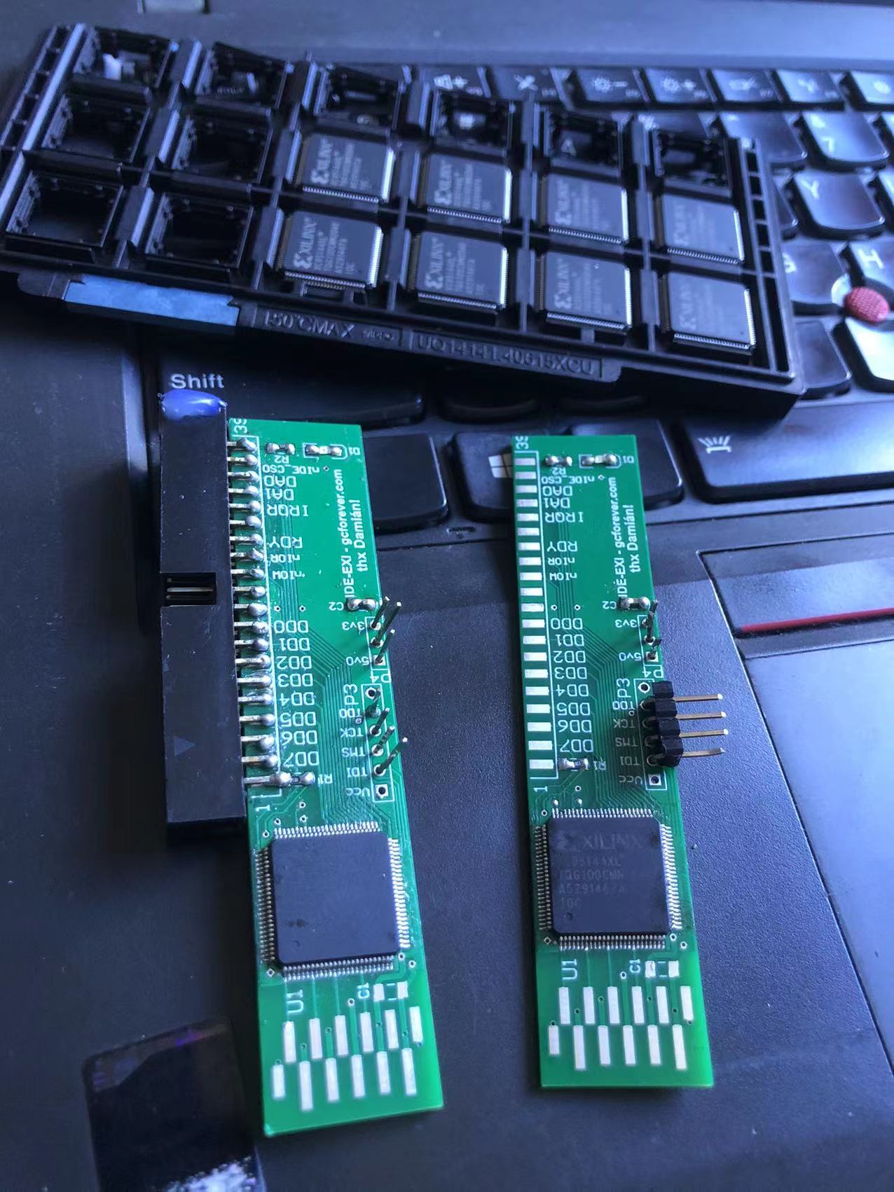

two board already completed the components soldering
programmer on the way ,waiting programmer arrive for FW programming

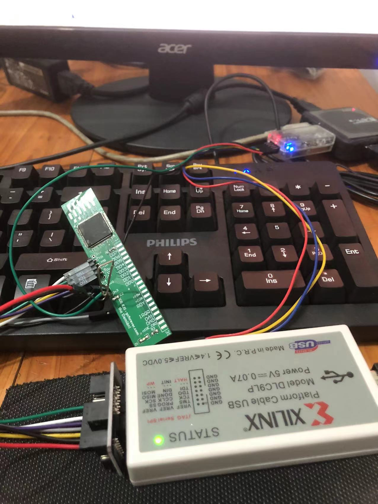

by hpxhpx » Thu Dec 09, 2021 11:37 am

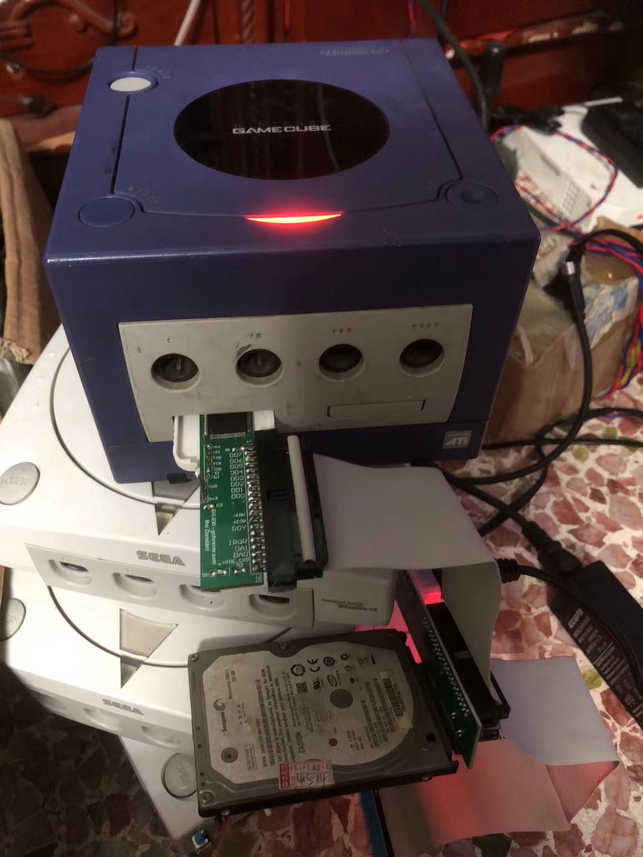

seems my subject was closed and unread so i'm here and need your help
Dears

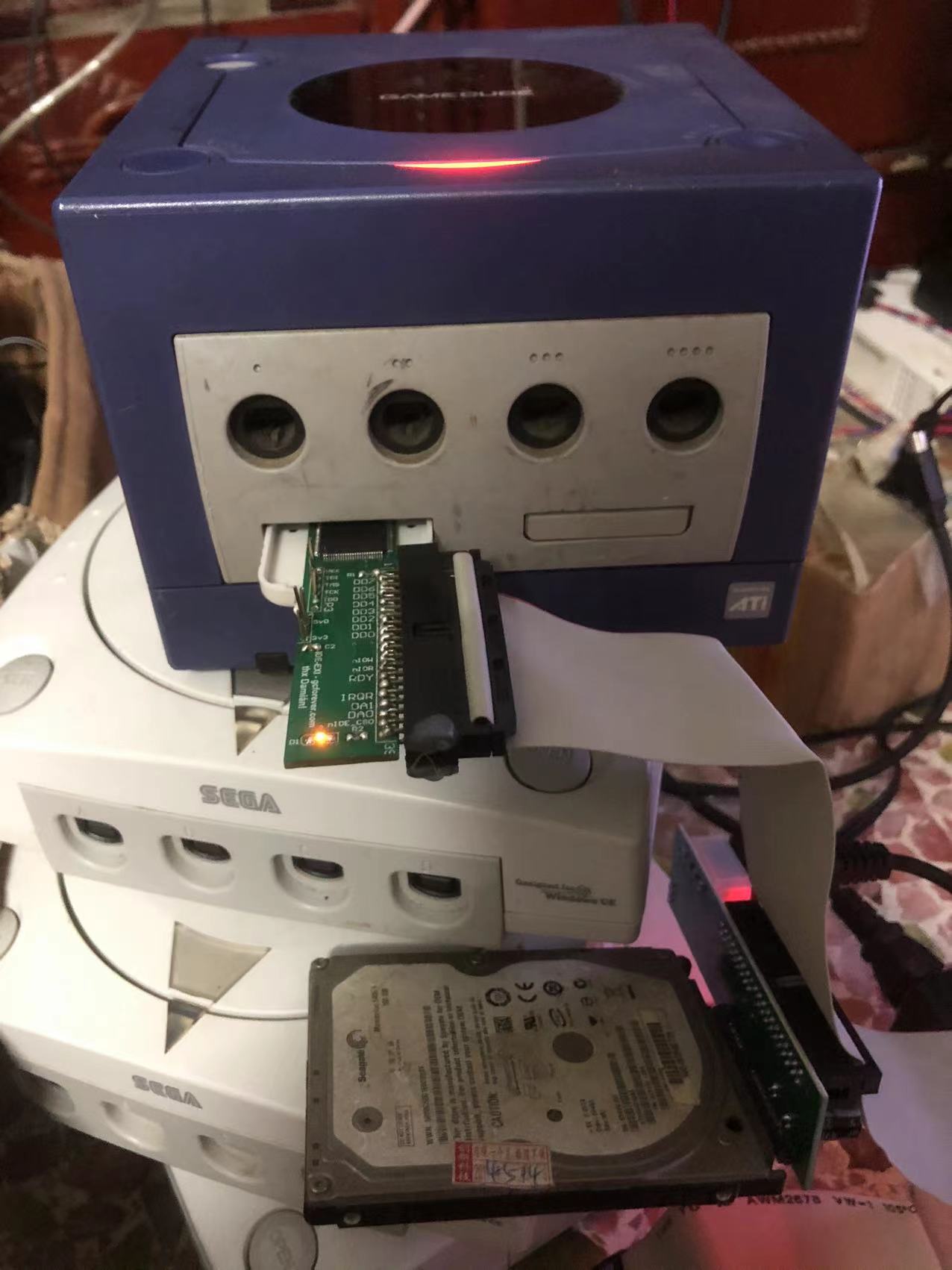

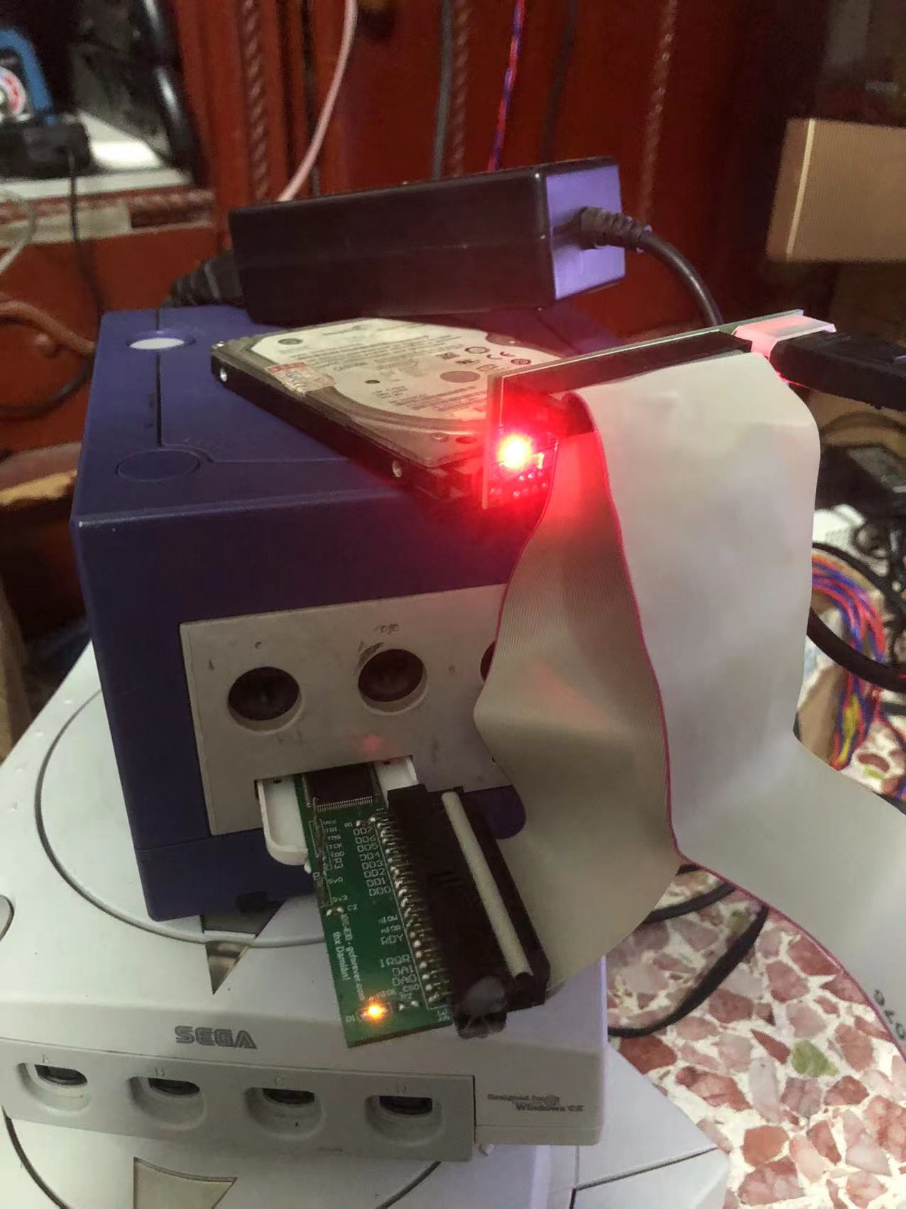

i got problem for use IDE-EXI, Please any one help me you if have any idea
I finished my IDE-EXI board build but it can't working

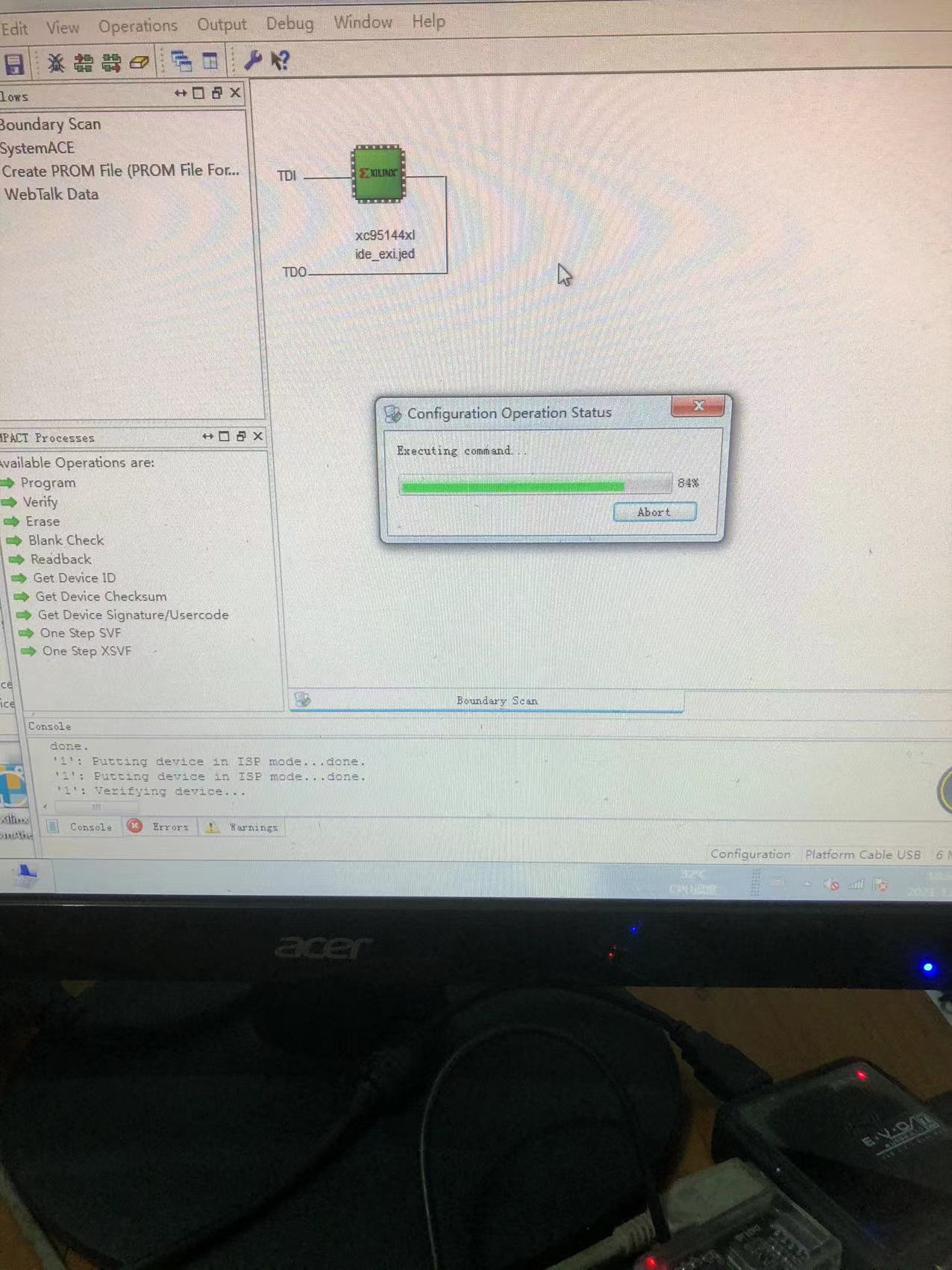

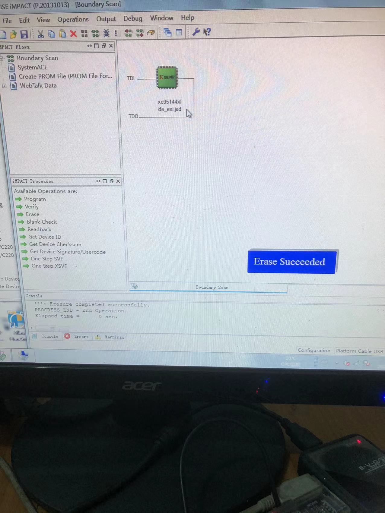

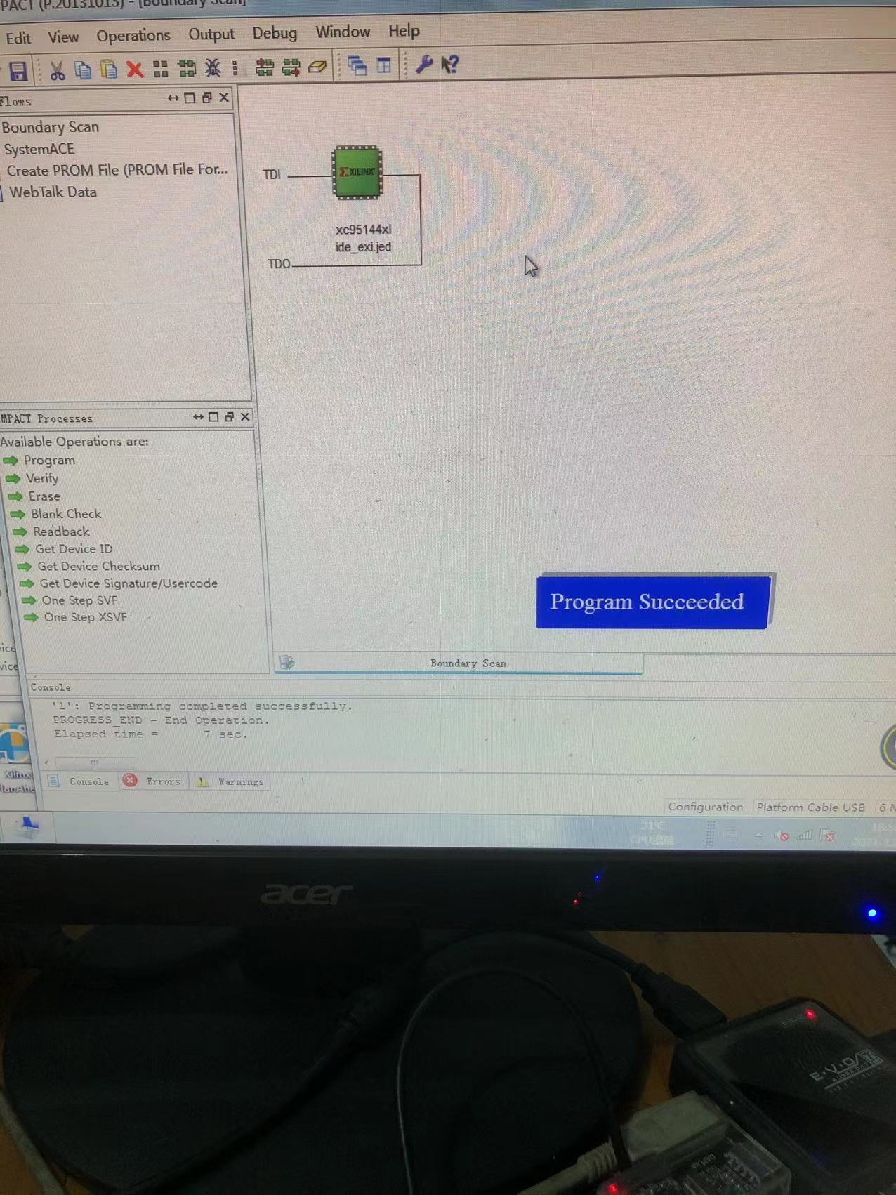

use Xilinx DLC9LP usb programmer for programmed IDE-EXI-V2 and the programming was succeeded

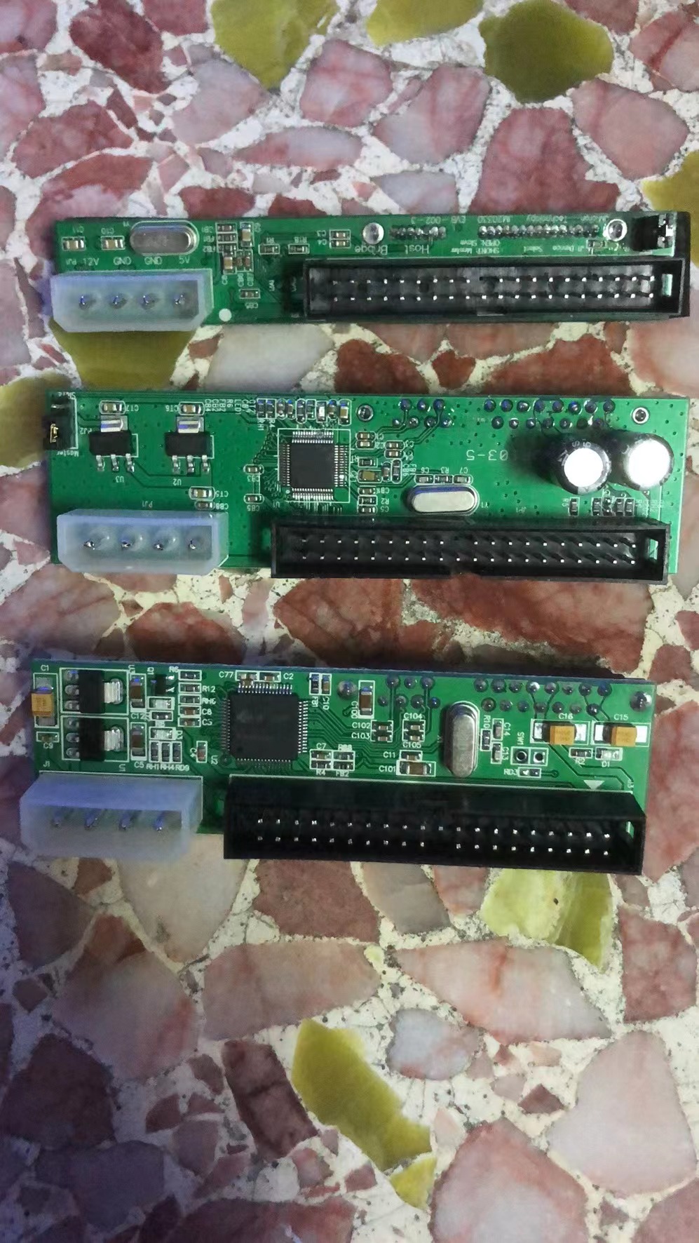

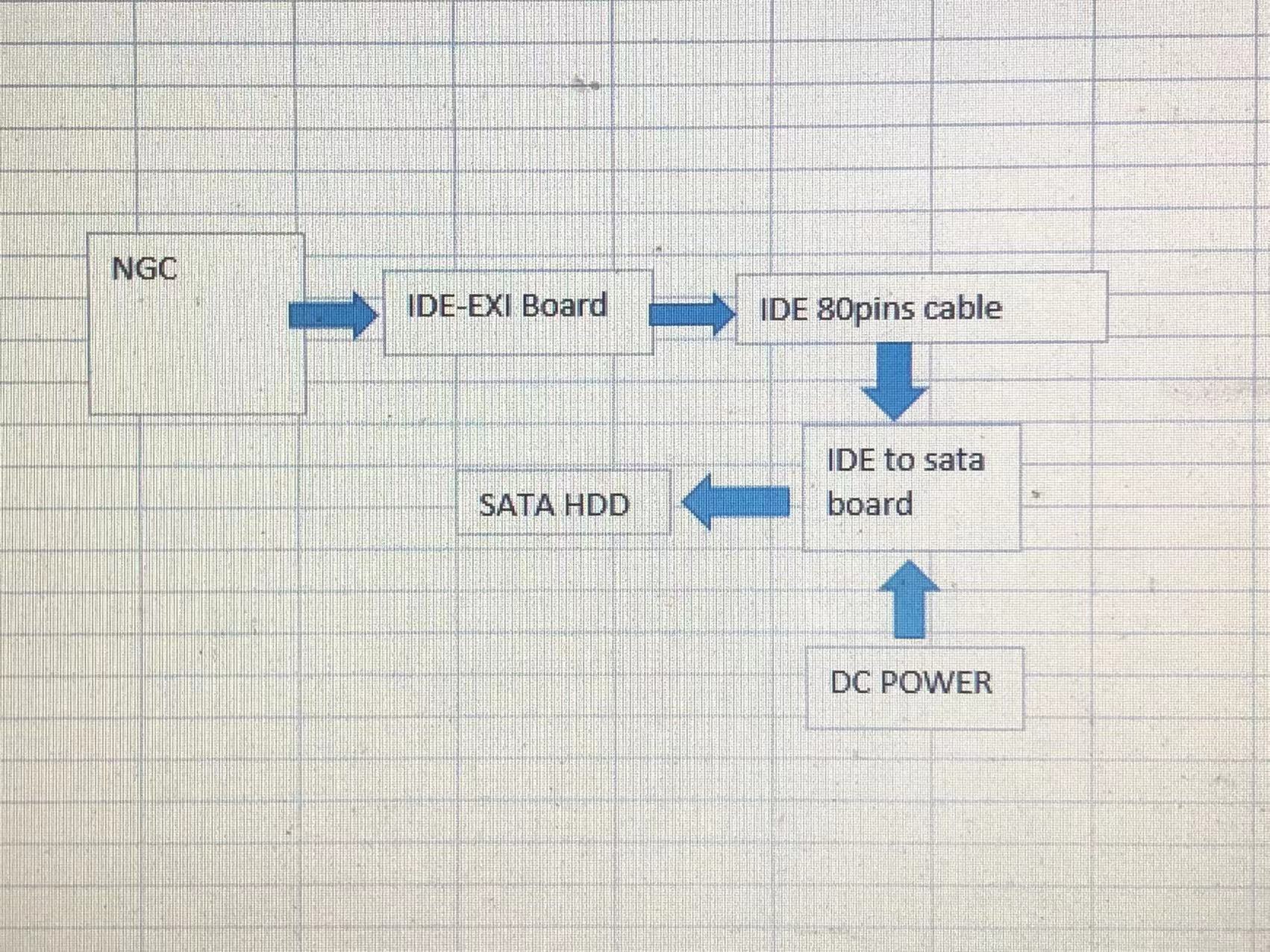

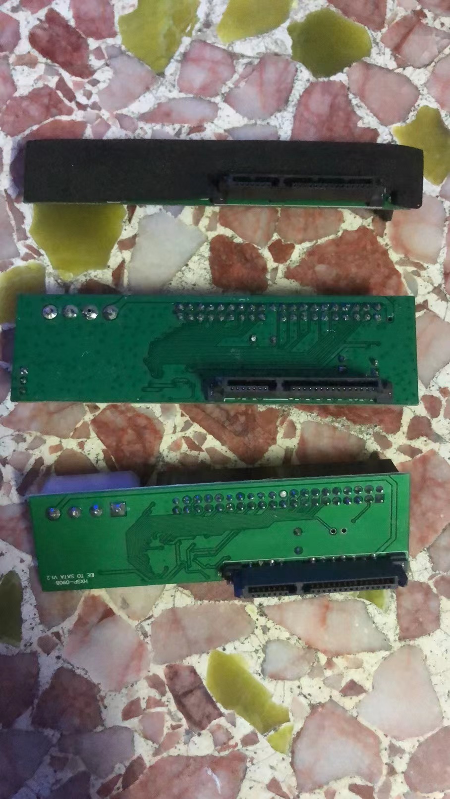

my connection as the setup flow picture (NGC-->IDE-EXI Board-->80pins IDE cable-->IDE to SATA board-->HDD)
HDD Format FAT32, Copy Swiss 1086 to HDD
By the way ,my NGC can boot by sd2sp2
picture part1
- (149.54 KiB) Not downloaded yet
- (301.77 KiB) Not downloaded yet
- (430.83 KiB) Not downloaded yet
- (239.21 KiB) Not downloaded yet
- (208.71 KiB) Not downloaded yet

by Papy.G » Thu Dec 09, 2021 11:57 am

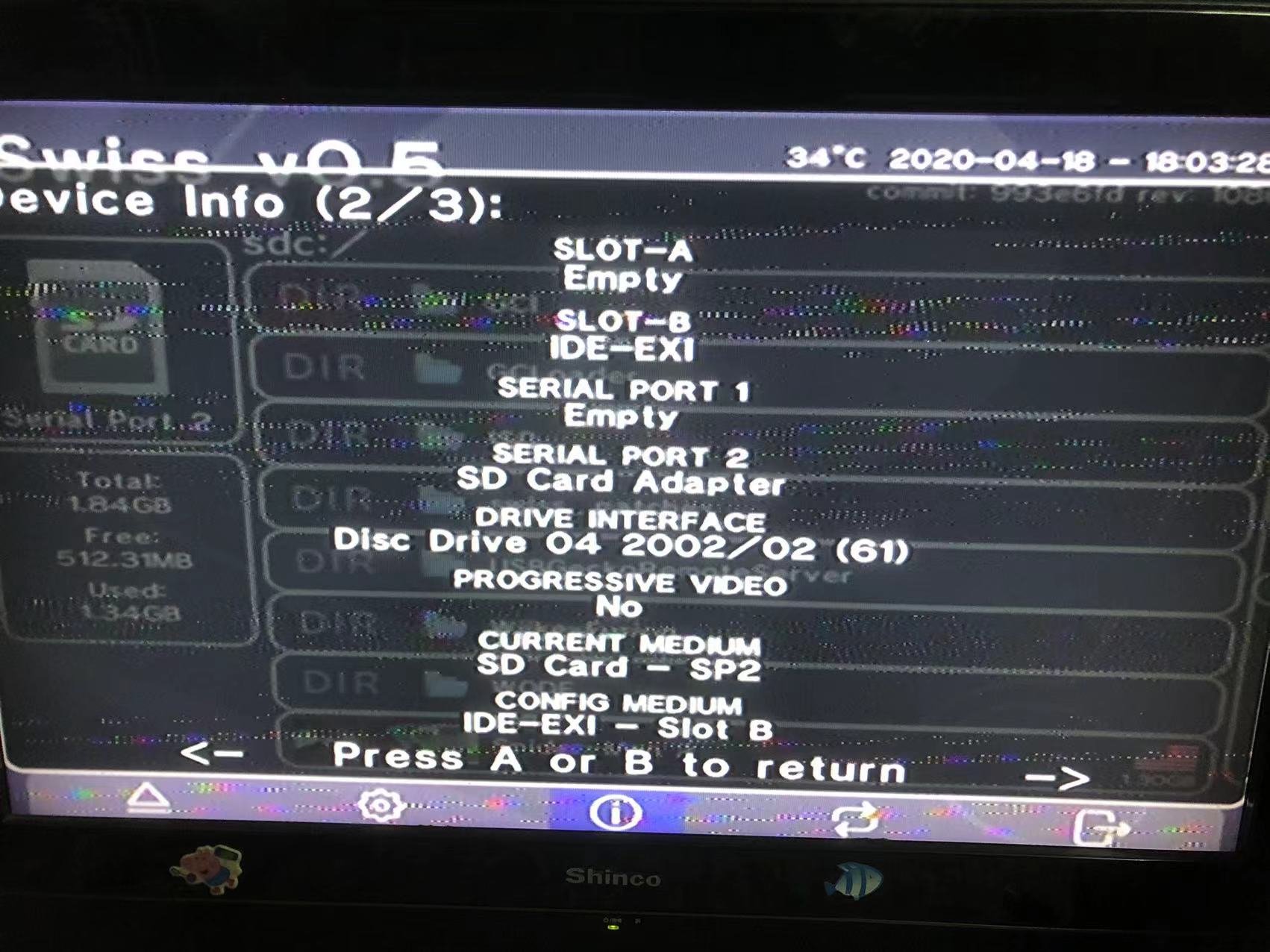

Are you sure your boot method can boot off IDE-EXI?
Try to boot SWISS off your SP2 device first, then see if it can see your hd.
Check github for updates.

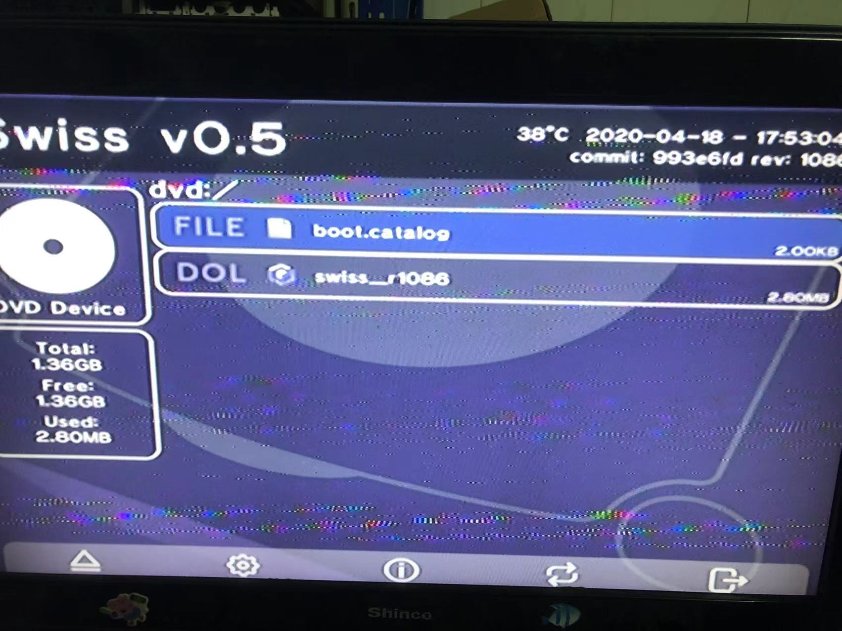

by hpxhpx » Thu Dec 09, 2021 12:23 pm
many thanks Sir
the IDE-EXI can detected from swiss by boot from SP2
seems i don't know how to use IDE-EXI Board
i just format HDD FAT32 and copied swiss file to HDD same as SP2
- (232.53 KiB) Not downloaded yet
