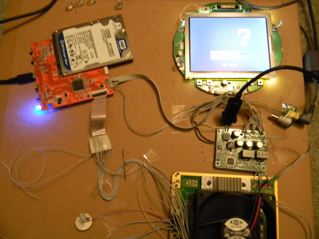

Now that I'm home for a bit I've gotten to do a bit more testing. The GC is actually toggling between the "please insert a nintendo gamecube disc" and "reading disc" message when I go to the "gameplay" tab. I will install my viper tomorrow and see what happens I guess. It seems now like it knows something is there but it just wont boot it. Maybe the viper will fix this?

Post by liquitt » Tue Dec 07, 2010 7:51 am
nice setup there :) keep us posted!
Post by emu_kidid » Tue Dec 07, 2010 9:06 am
That's pretty awesome.. I'm going to wire it up tonight! (even if I'm up all night :D)

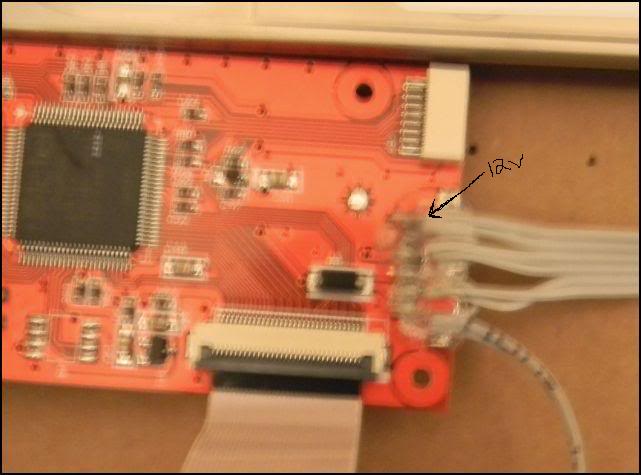

First thing is to make sure that all the switches on your sundriver are set AWAY from the LED. If even one of them is out of position I get a black screen when I power on my GC.
This is how I wired up my power:
Looking at the board like in my picture I have marked where I have 12v wired, from there it goes:

Of course I just bridged all like connections together for ease of soldering.

Hope this helps ^_^

Post by emu_kidid » Tue Dec 07, 2010 9:53 pm
yep that makes perfect sense, I never tried all switches in one direction :P
Also, I'm using a DOL-101 so I've just randomly taken the 3.3V from the EXI bus and the 5V from pin 2 of the DVD connector. 12v I'll take straight from near the fan someplace.
I'm a bit worried cause I didn't wire up the 12v yet, but I checked that spot with a multimeter and it was getting 5v already?
Almost there, I'll have to post up pictures of my monstrosity later on. I wish I'd wired it up like you with the flex cable and not by removing the connector :p
