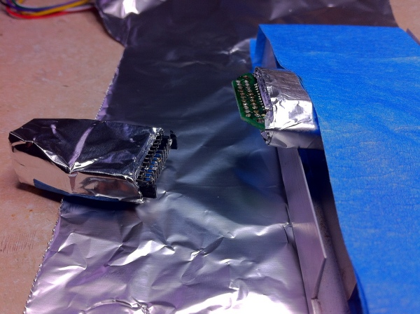

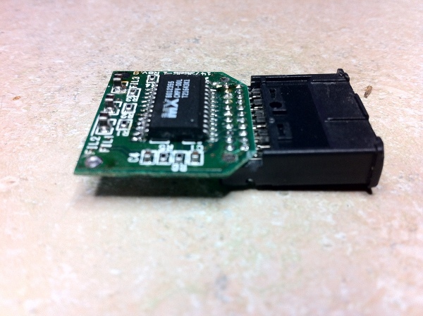

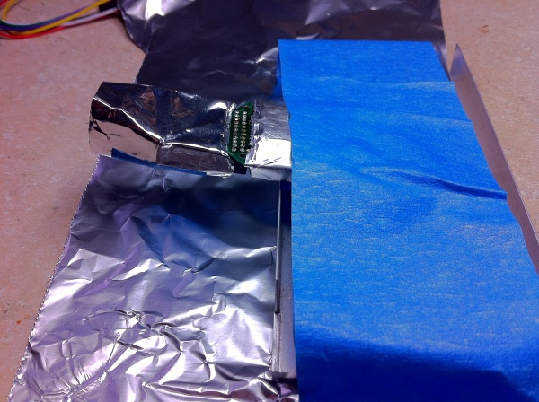

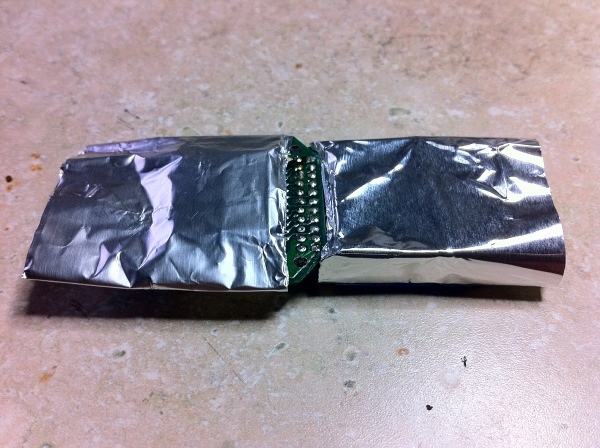

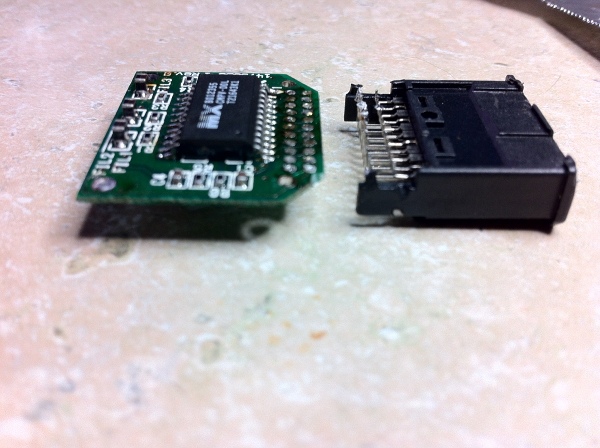

Component Connector Removal
removing the connector is a really simple process....
wrap in foil, blast it with hot air, slide out the connector, done!!
the connector will melt with hot air so make sure to protect it...
1. wrap in foil to protect the connector from melting
2. use good foil, not the cheap stuff
3. wrap as many layers as you want...the more, the better
4. secure the board to something stable...i used a GC heatsink to help dissipate heat
5. apply hot air 385*F (~195*C) for about 1 minute and the solder should be soft
6. gently slide out the connector and keep applying hot air till its fully removed from the PCB
7. inspect the pcb to make sure you did not pull and traces
- (104.31 KiB) Not downloaded yet
- (110.19 KiB) Not downloaded yet
- (126.48 KiB) Not downloaded yet
- (133.48 KiB) Not downloaded yet
- (105.23 KiB) Not downloaded yet

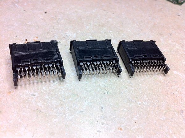

Re: Gamecube component cable
3 connectors ready to install
- (125.05 KiB) Not downloaded yet

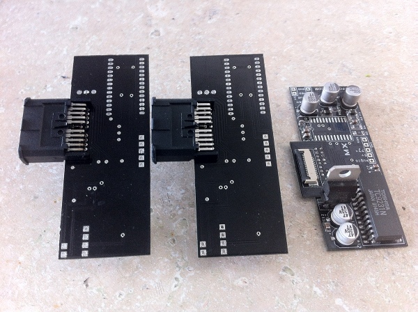

pr0ton, andzlay, ashen...your next
- (134.57 KiB) Not downloaded yet
that one to the far right, does that effectively have a FCC extension cable? I have noticed that your mega 3 with the plug covers the analog video/audio jack when the connector is attached to the main board
yea a ffc adapter is used as a substitute digital port connector...
and yes, the external MEGA3 will also reach to the analog A/V port....
since there will only be 4 maybe 5 possibly in existence ever, im sure the owners of those boards will take the next step in modification to add an analog plug onto the board as well....
DONT BE ALARMED WITH THE FOLLOWING PICTURE:
read the information to understand the purpose of this pic...
YES I KNOW, when the analog plug is connected the board is bending under pressure....
now look closely....
the analog connector has a small lip that can be shaved off at the bottom to allow the MEGA3 to sit evenly horizontal under the analog port...
shave that bottom lip...and maybe a little more if needed to have a proper fit...then epoxy the analog connector onto the MEGA3....once the epoxy dries, then you can start working on making the MEGA3 external housing...
why bother to add and epoxy the analog connector onto the MEGA3
to have an ALL INCLUSIVE video connector for GC....
YPBPR
VGA
DIGITAL AUDIO
COMPOSITE VIDEO
L/R AUDIO
SVIDEO ( OR RGB ) (or both if you wire it right for PAL/NTSC)
(careful with 5v on the analog port)
....now can i succeed in my next project down the road to turn my MEGA3 into a MEGA8??? shhhh!!!! its a secret

Has anyone found an alternative for getting hold of the Digital AV plug for the GC (other than buying the component cable)?
I haven't read through the whole thread yet, but we only need the plug itself for the HDMI version.

....and as for the connector....if there was a better alternative i would not be using official connectors...
ive looked at the possibility of getting some made, but quality, precision, and long term "abuse" will be an unknown factor with 3rd party connectors...
the safest known connector to use in my opinion to guarantee long term use is the official connector...
and until someone else shows they can make a better one or one of equal quality, i will not install any other connector on my board or use any other alternative replacement connector other than the ones i have designed and shown proven to work
