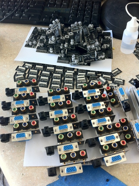

getting closer...
- (165.61 KiB) Not downloaded yet

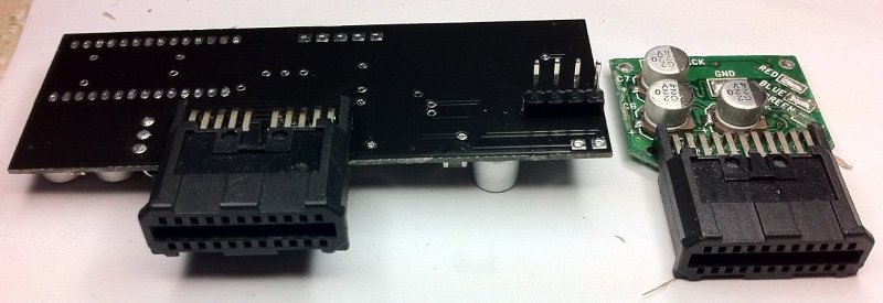

first i want to discuss the design of the digital port replacement adapter
the digital port and official component connector uses 22pins...
my FFC port replacement uses 22 pin connections to the mobo with only a 20 pin FFC cable...
there are multiple GND points which were all tied together on my adapter design which allowed me to use a lower cost FFC connector and lower cost FFC cable...
i assume its lower cost because 20 pin is more common that 22 pin???
so this simple method of "cheating" by combining GND's has allowed a cheaper final cost...
now lets talk about the main MX board
the MX board i designed uses an exact 1 to 1 pinout of the digital port / official component pcb...
...almost exact...
i am using 20 pins instead of 22 eliminating two redundant GND points...and allowing me to draw traces thru those two missing points...
i guess this also allowed me to "cheat" the design to make everything work in the end...
but as i stated...this board is special...
"more than meets the eye"
Flawless victory!
i am extremely thrilled to be able to finally unveil the last surprise about this project...
im also celebrating right now by getting extremely wasted...

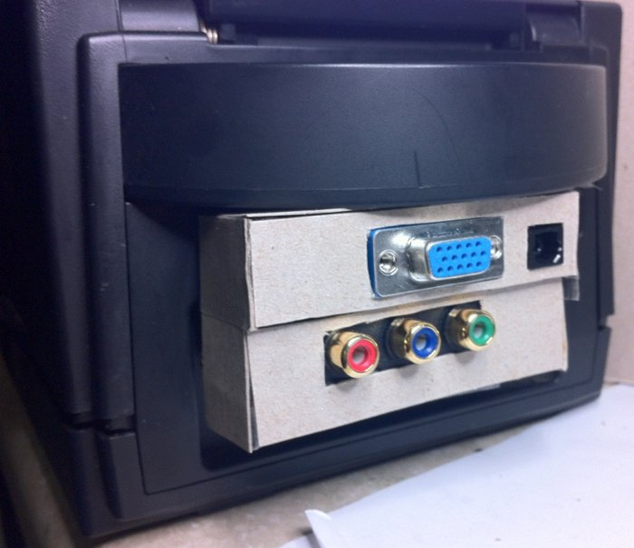

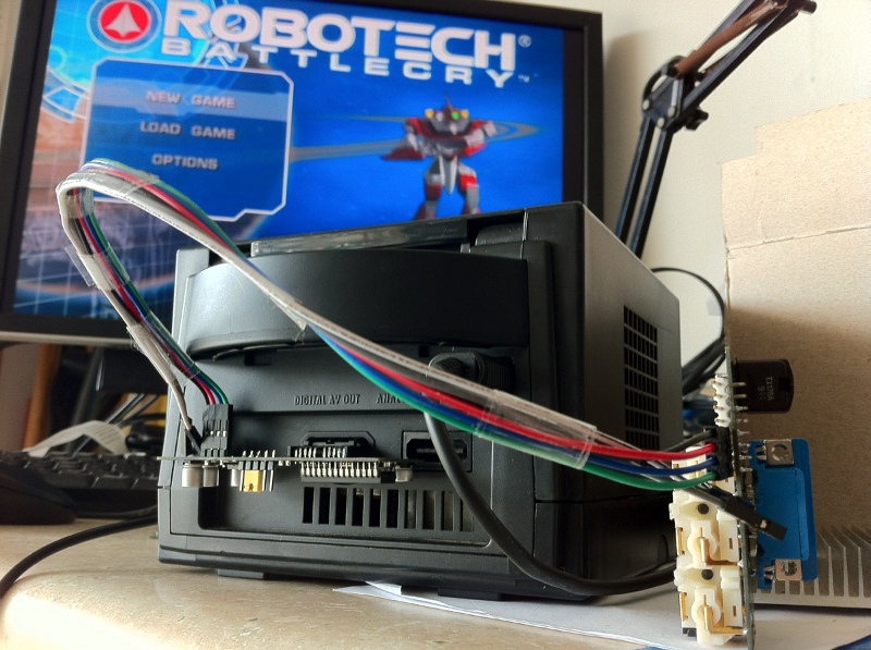

since the main MX board is an "exact" 1 to 1 pinout, this allows it to accept an official digital port connector (minus two pins which have been removed)
this is the result of a functional test of the board with the connector:
and using a cereal box to cut up and make a mock up example:
so as ive said, "more than meets the eye"
this board is able to be used as an external device...more details on the requirements to make this external will be provided later...

Re: Gamecube component cable
Wooooah! It get's back to be an plug'n'play connector! Nice megalomaniac!
Also: the picture quality makes those boards look so professional. can't wait
I would totally take that original-connecter-option, but I would take that official component cable modded to VGA, too.
Possible?
Possible?
