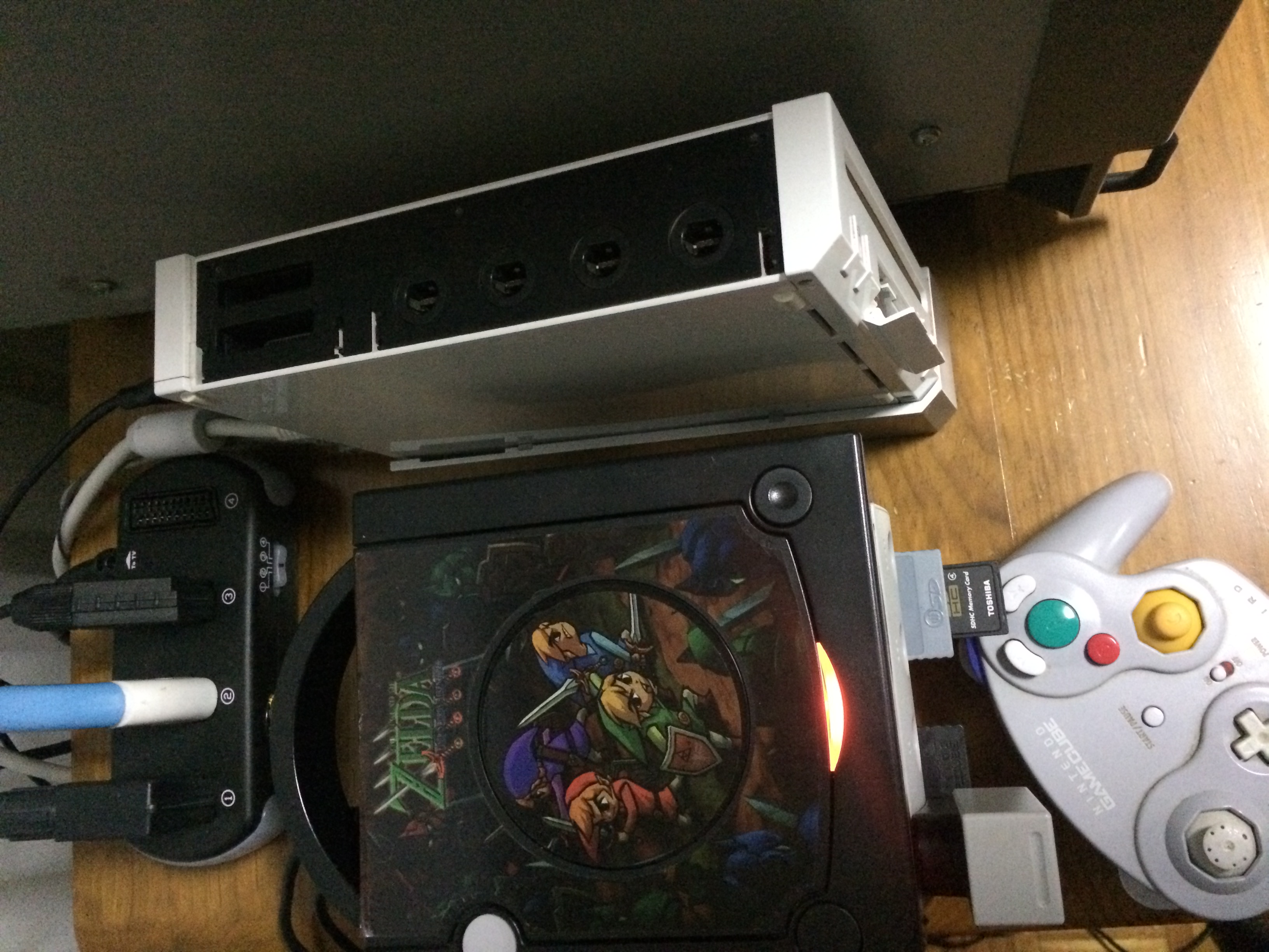

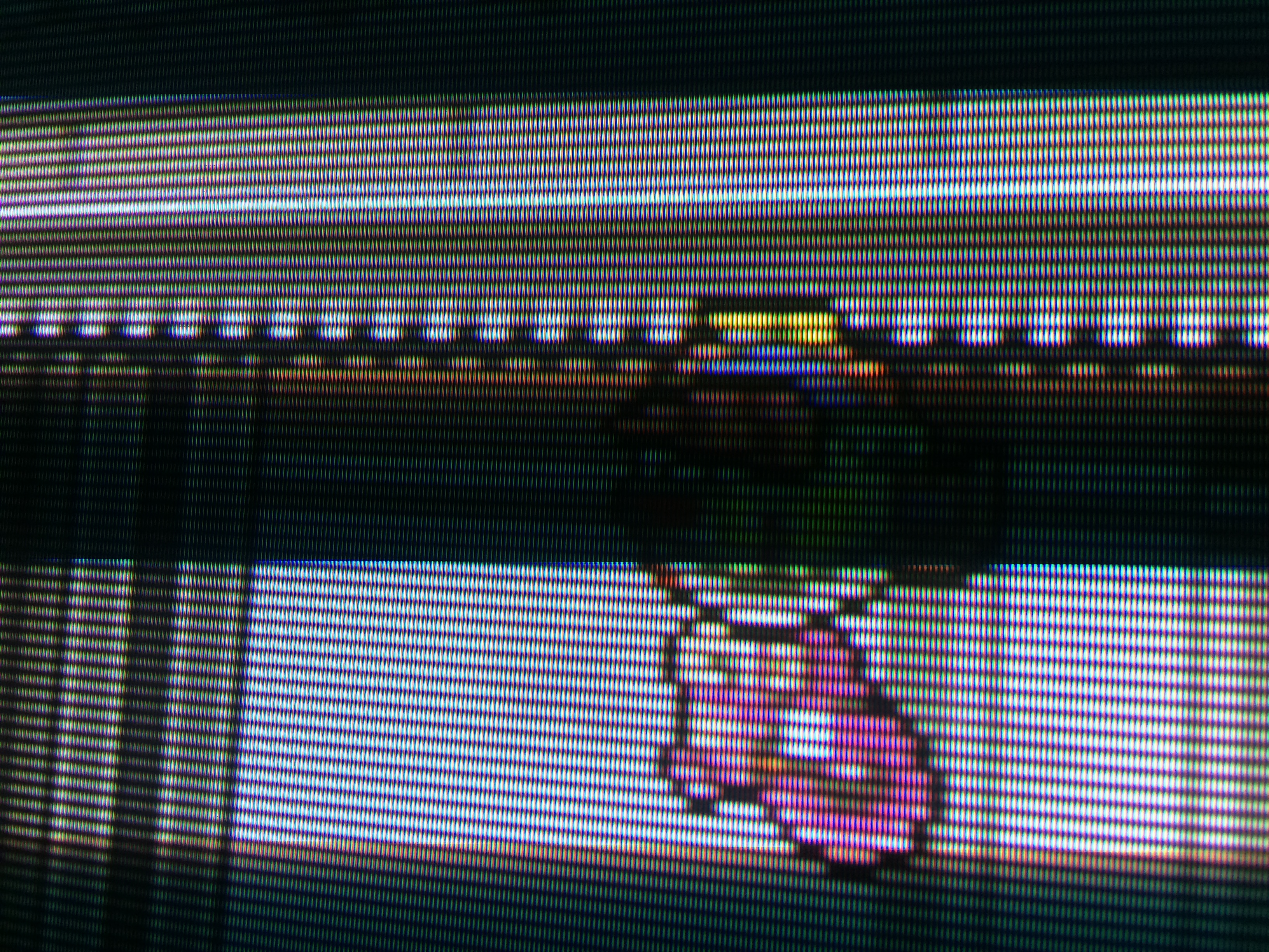

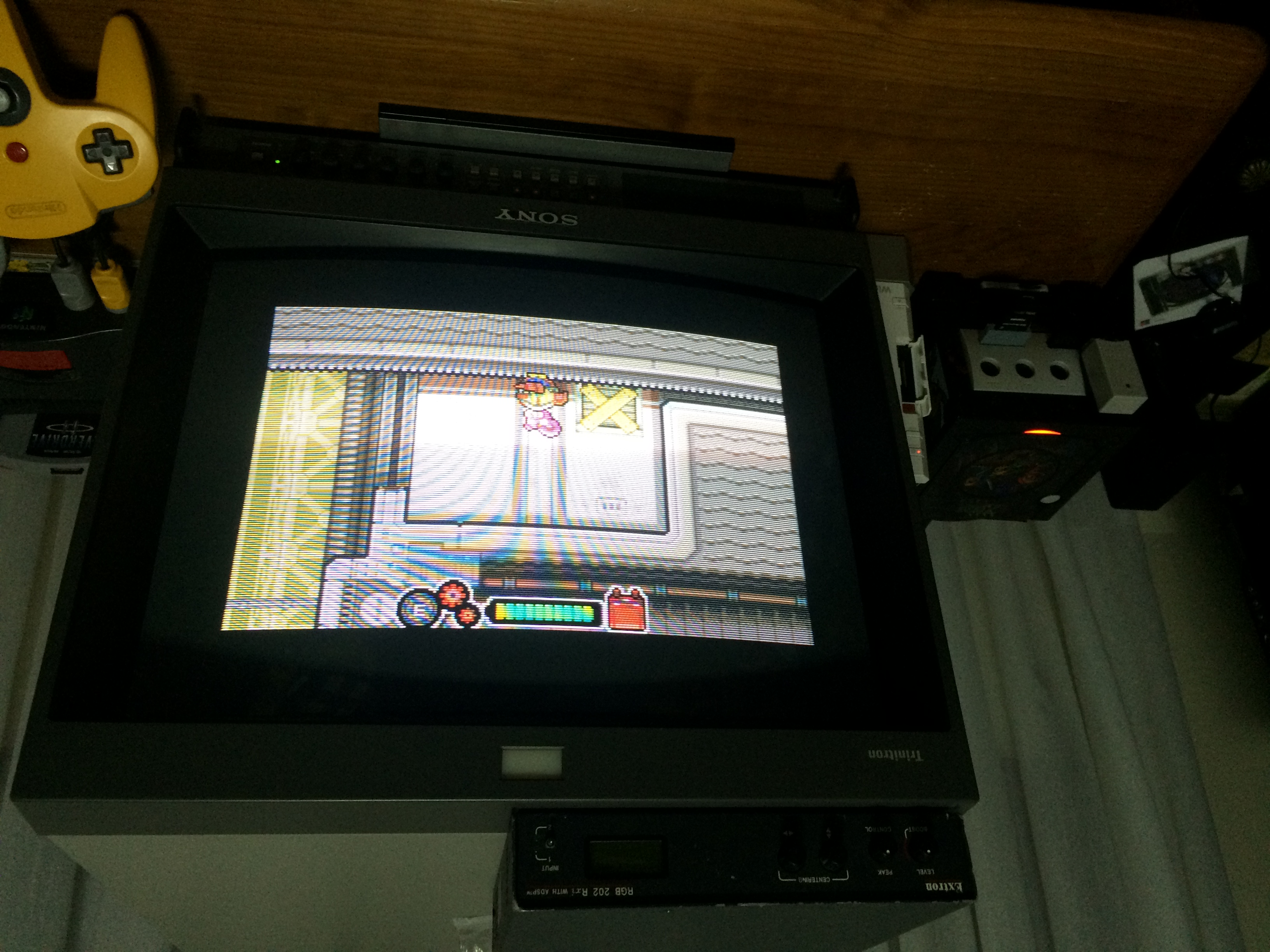

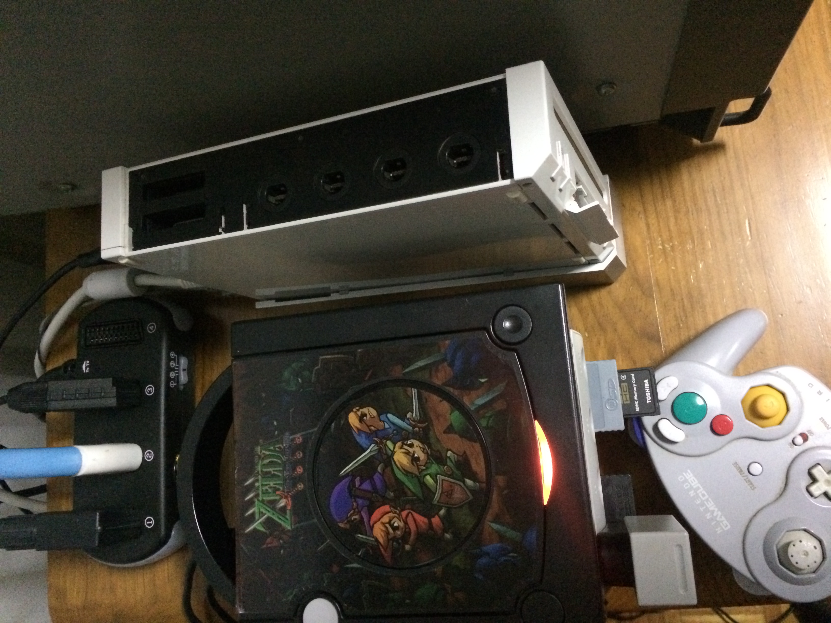

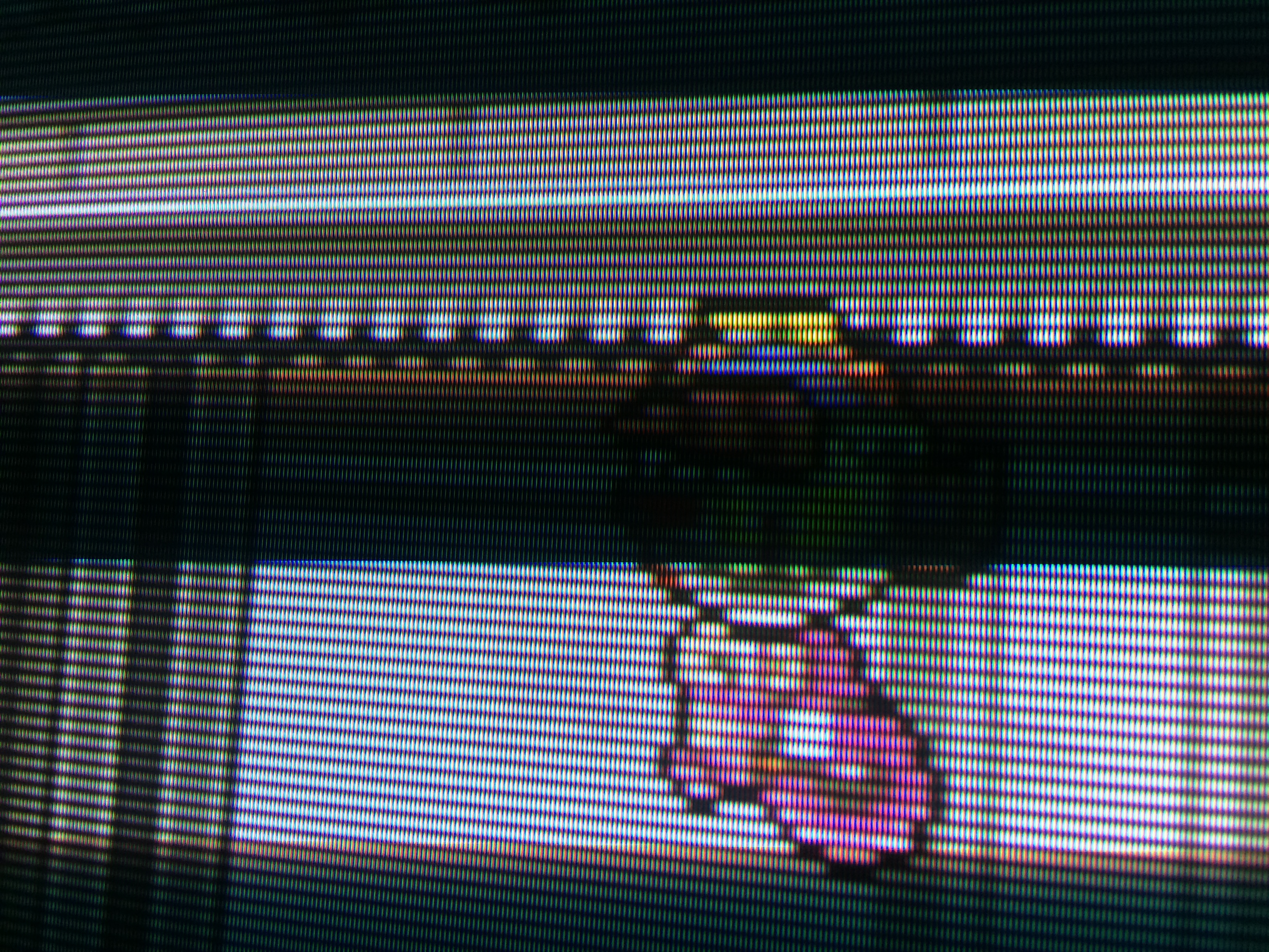

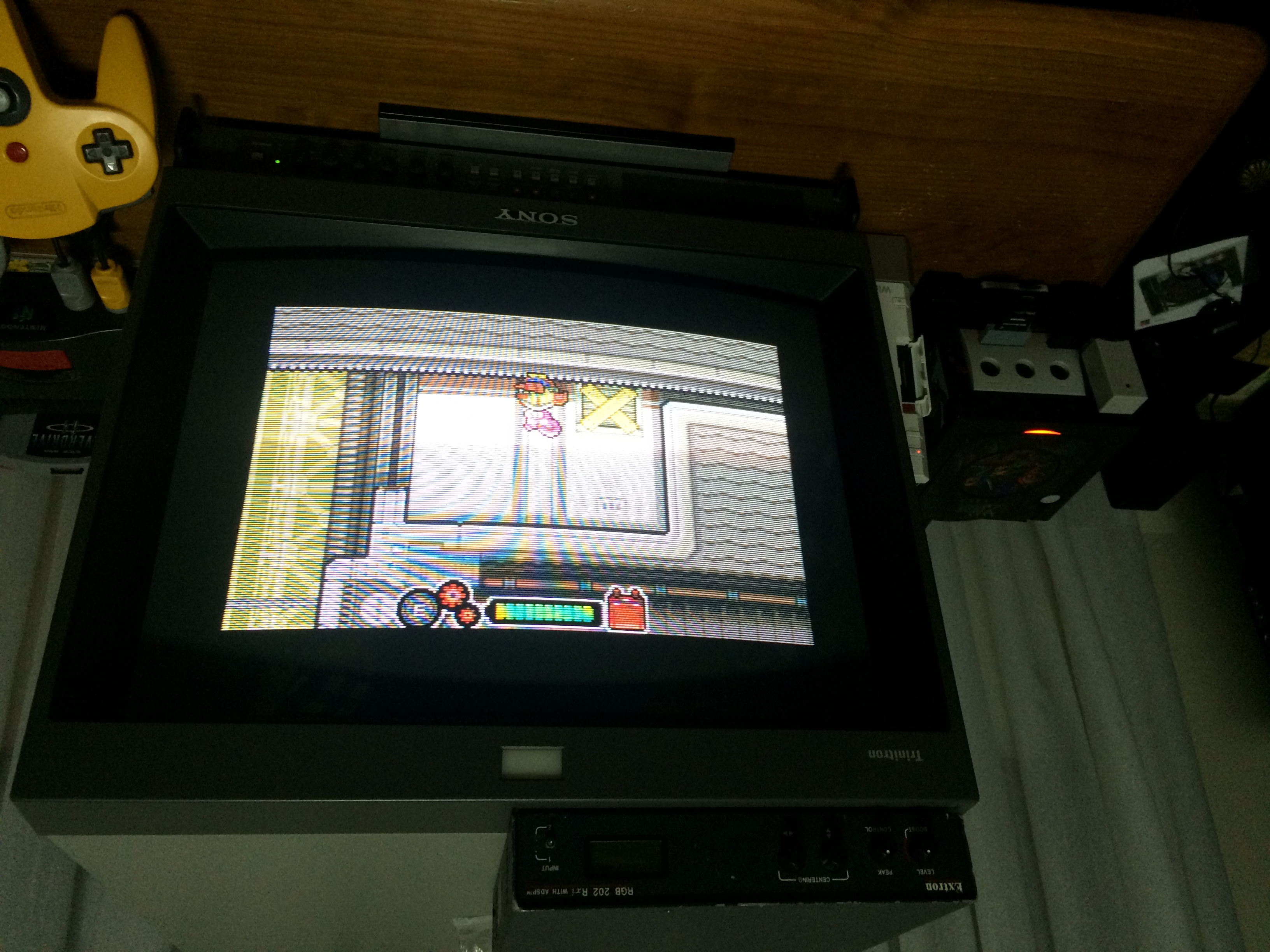

I am using GBI with my GC using a SCART RGB connected to my SONY PVM (CRT monitor). Looks MegaFantastic with ULL.
Re: RE: Re: Game Boy Interface
Got any screenshots? Which PVM do you have? I haven't seen a GC connected to a CRT via SCART.ruitunes wrote:I am using GBI with my GC using a SCART RGB connected to my SONY PVM (CRT monitor). Looks MegaFantastic with ULL.
PVM-20M2E.
I have a scart switch that connects a wii, gamecube and RGB modded N64 to the PVM.
The pictures were taken with the phone.
