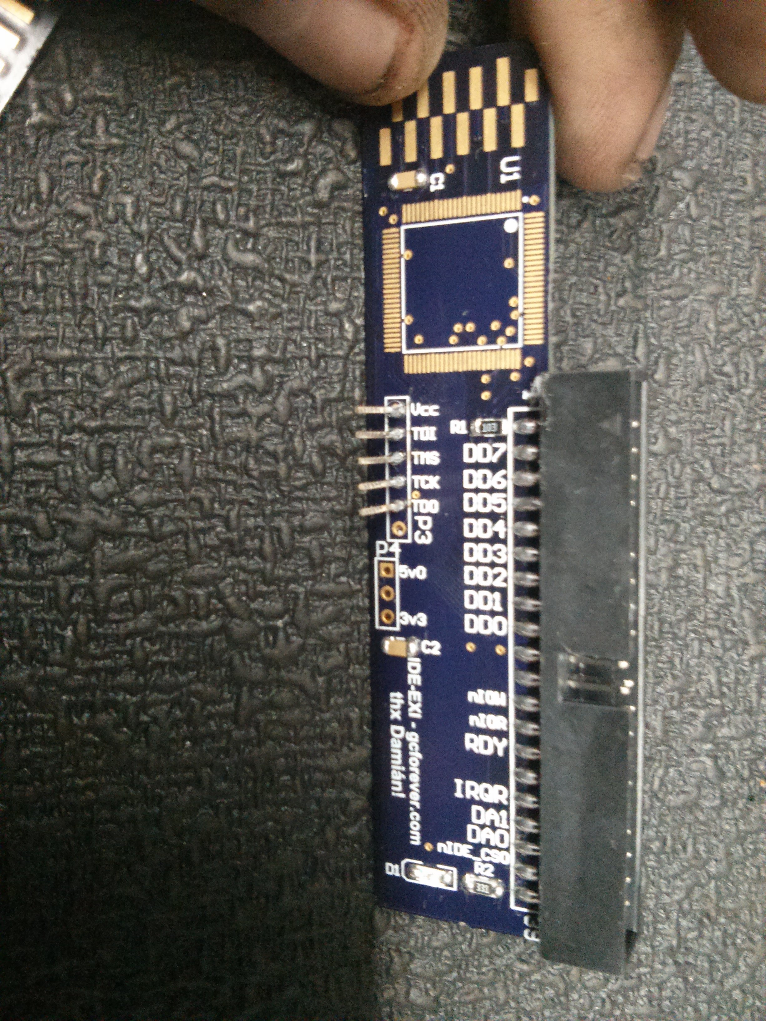

These are about 75% complete. I have completed 3 now I have 3 left to do. Tonight hotair reflow xilinx chips and flash then test. Thats it after that on to bigger and better things (GC video!!). This was a fun project and it will be missed thanks everyone

You might want to get rid of C1 if you run into problems removing the PCB from the card slot

megalomaniac wrote:You might want to get rid of C1 if you run into problems removing the PCB from the card slot
I thought it was for flashing the chip only then it could be removed. yeah I noticed I got stuck under the memory card slot :lol:

Here are two done and flashed now for testing and remove the JTAG pins. Hot air reflow is so easy for these small chips total build time 45 min to 1 hour each PCB

by emu_kidid
You don't need to solder pins in for jtag, just use a header on your programmer and hold it there whilst programming.
