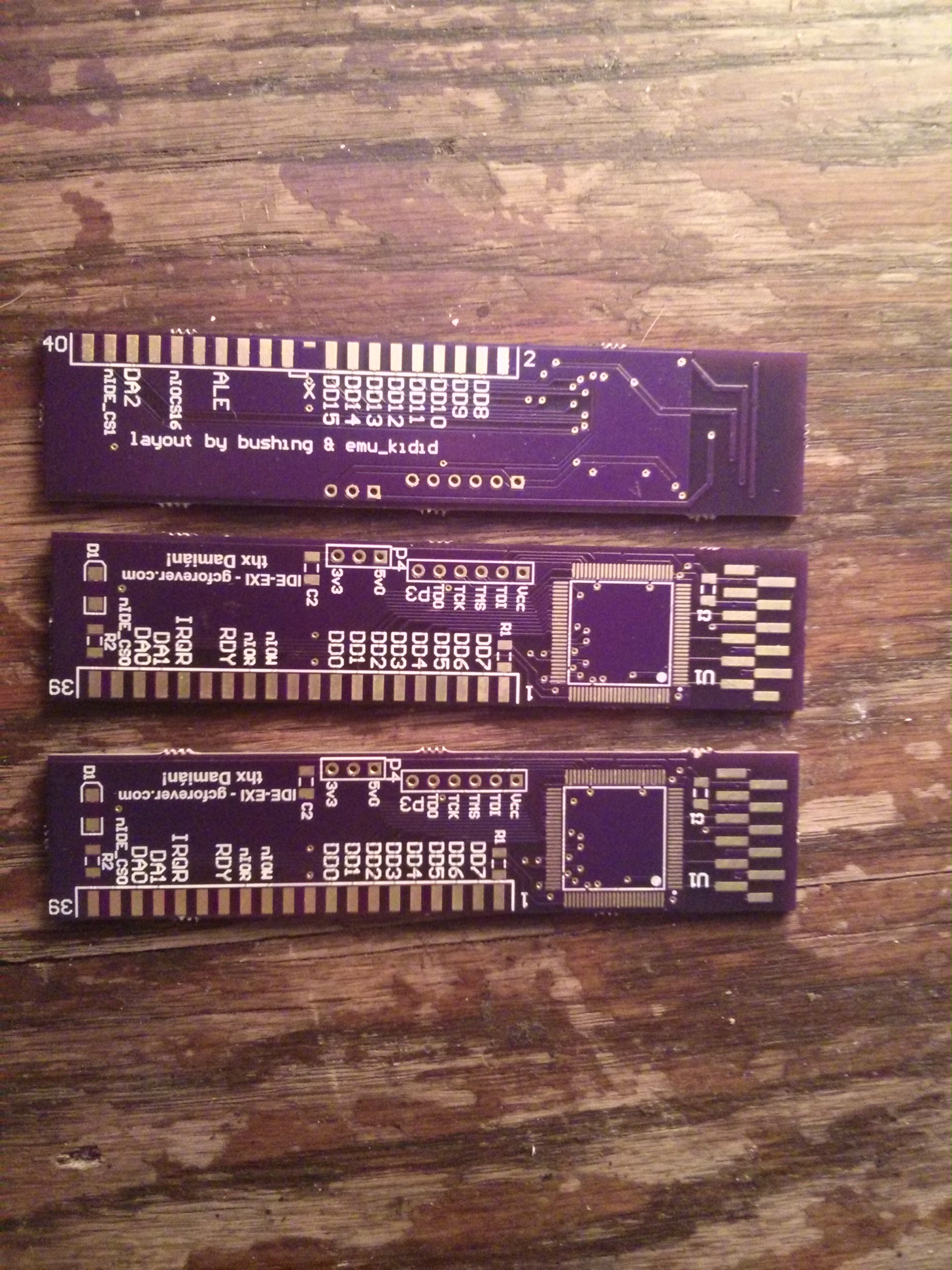

I have just ordered 3 of these boards from OSHpark. Just so everyone knows you can order 3 of these boards from them for 23.00USD with free shipping and its a shared project at OSHpark.com you can simply click shared projects at the top of the web page and look for GCvideo. I have used OSHpark for my IDE-EXI boards there great but I wish they would come in other colors besides purple.
(1.69 MiB) Not downloaded yet

Post by bobrocks95 » Mon Sep 08, 2014 10:29 pm
Let us know how putting everything together goes! I'd order a few myself, but my soldering skills are nowhere near good enough for something so fine-pitched. I'll have to wait until someone decides to sell assembled boards, or there's a manufacturing run of factory-assembled ones someone organizes.
andre104623
Posts: 694
Post by andre104623 » Mon Sep 08, 2014 10:44 pm
bobrocks95 wrote:Let us know how putting everything together goes! I'd order a few myself, but my soldering skills are nowhere near good enough for something so fine-pitched. I'll have to wait until someone decides to sell assembled boards, or there's a manufacturing run of factory-assembled ones someone organizes.
No one is mass producing these at this time it's only DIY and in beta testing. As far as I know it might not even work but I like a challenge. The only person who has one is unseen we are all waiting for the fab it will be some months but I for see great things soon. Maybe someone could get that digital audio working......
