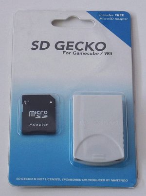

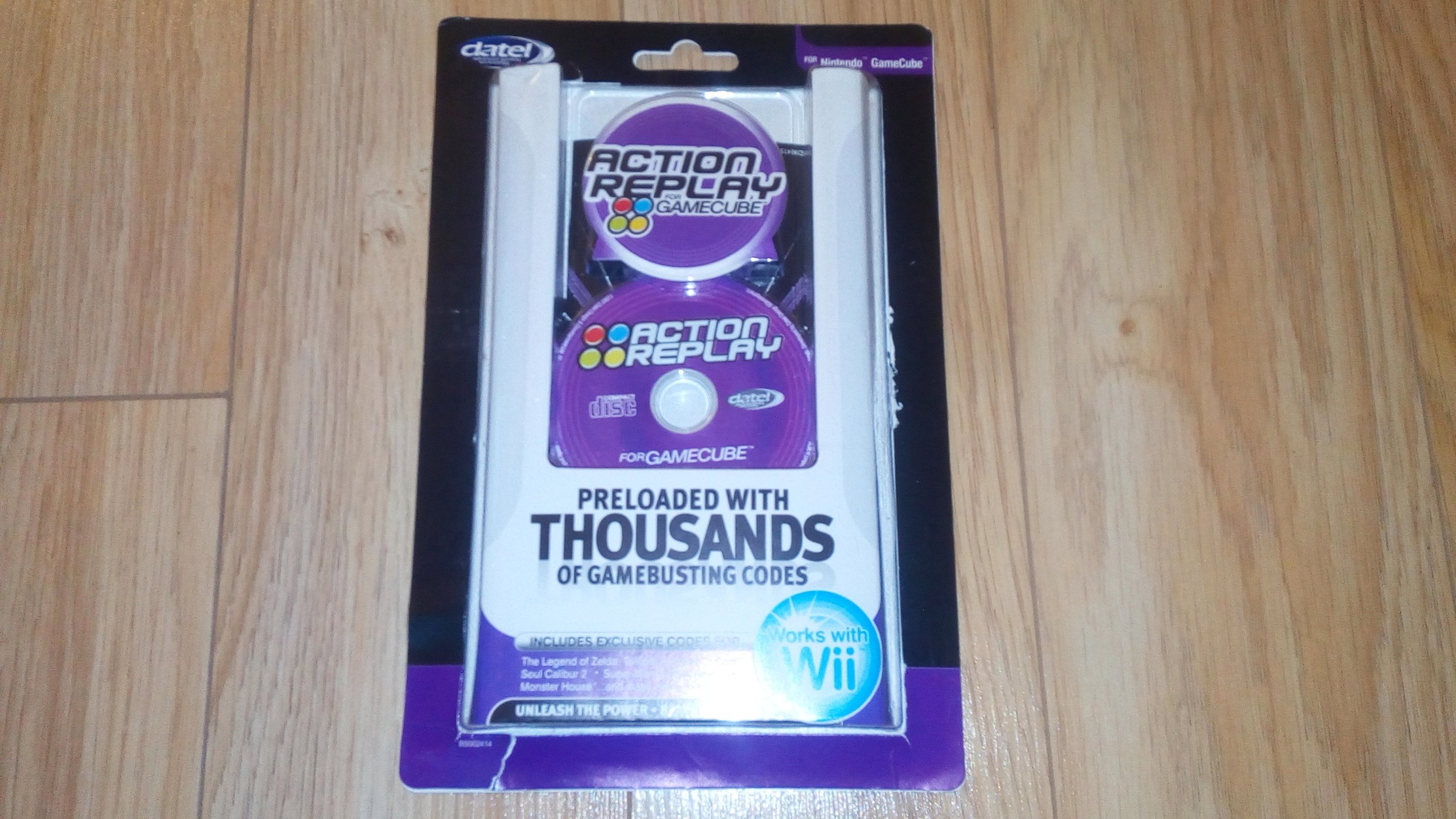

Post by cachaito » Mon Jul 09, 2018 10:26 am
Hi guys and sorry for my lame question at beginning :|
I just bought a Game Boy Player (PAL). I have unmodified GC NTSC version and plan to buy Action Replay (NTSC) and SD Gecko card reader (both attached). Will this setup allows me to run a Game Boy Interface?
Best regards, Bart

cachaito wrote: Mon Jul 09, 2018 10:26 am Hi guys and sorry for my lame question at beginning :|
Best regards, Bart
Yes, That's the set up that I have....except the PAL Game Boy Player. I have the NTSC GBP.

Post by cachaito » Wed Jul 25, 2018 10:52 pm
lilhed wrote: Mon Jul 09, 2018 10:00 pm
Best regards, Bart
Just received Action Replay. I've started a Final Fantasy Tactics Advance in High-Fidelity mode and... I'm still searching my jaw on the floor :o
Extreme you did a A-W-E-S-O-M-E work! All the best ;)
