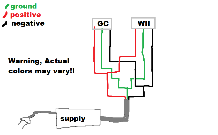

I'll upload a simple image soon, two minutes tops, k? :)
Edit: Probably not the cleanest layout, but functional.
Ground to ground, positive to positive, negative to negaive. Use preferred method to connect wires, just don't come crying at me if you use tape and staples.
Edit2: No idea, but they also may not have any color at all, and use black and gray stripes for identification. I dunno, haven't opened the cable of a wii/ngc powerbrick, but i have seen lots of different types of identification. Check the powerbrick as mega said to make sure you identify the wires correctly.

(The tape was a part of the plan...)iamdablasta wrote:I'll upload a simple image soon, two minutes tops, k?
They don't have colors, but they're quite easy to identify.
Well, i'm not really used to manipulating wires and stuff, but a friend of mine does. I will ask him the tools to get the job done. Don't worry, the worst case scenario would be that the brick wasn't the problem since the start... crap. Pretty weird, actually.

The power brick outputs DC so there's only two wires coming out of it.iamdablasta wrote:I'll upload a simple image soon, two minutes tops, k?
And yeah, Wago is awesome stuff. I have some at home.
