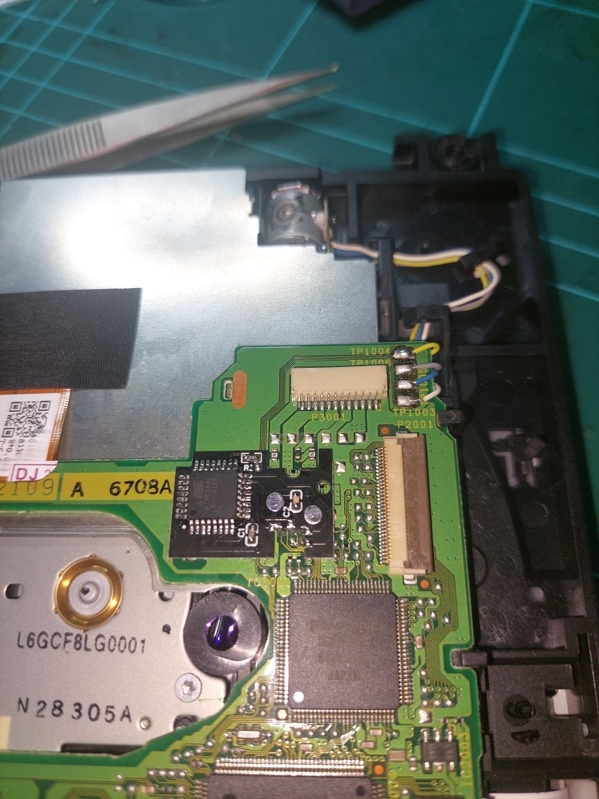

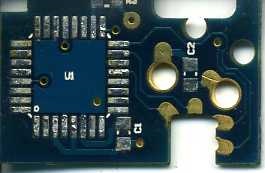

uploaded this to archive. collection of drive mod stuff, limited with updates n config discs. main draw is the hex and sources of some commercial chips. hex only ones appear to be ripped by others, sources appear to be released by dev as few have gnu license in them. did cad a wiikey v1 clone and has been tested working 100% using the 1.9g pack then update disc to 1.99beta. the 1.99beta dump was me when playing with dip atmega8 in socket so dumped once flashed upgrade.
pcb cad been tested with atmega8l and atmega8a but all atmega8 should work like xenogc as sure by same people just wii version.

had just been messing round recently with pcb cadding to learn, when saw i had the wiikey v1 dumps i figure make a cad of it as simple circuit but good to get head round how to do odd shaped cut pcbs. plan to do a xenogc clone, which are already many, but clone the pcb close to original, just for another project to get more practice. did program atmega8a with iscp avrdude and pi3 originally as was waiting on tl866ii tqf32 adapter for them, then the atemega8l with that. the pi is handy with avrdude for iscp, doesn't even need any components just direct links to gpio, might be worth adding that to the xenogc info you host. I actually stripped a xenogc for components to test as got pcbs in before the bits for them.

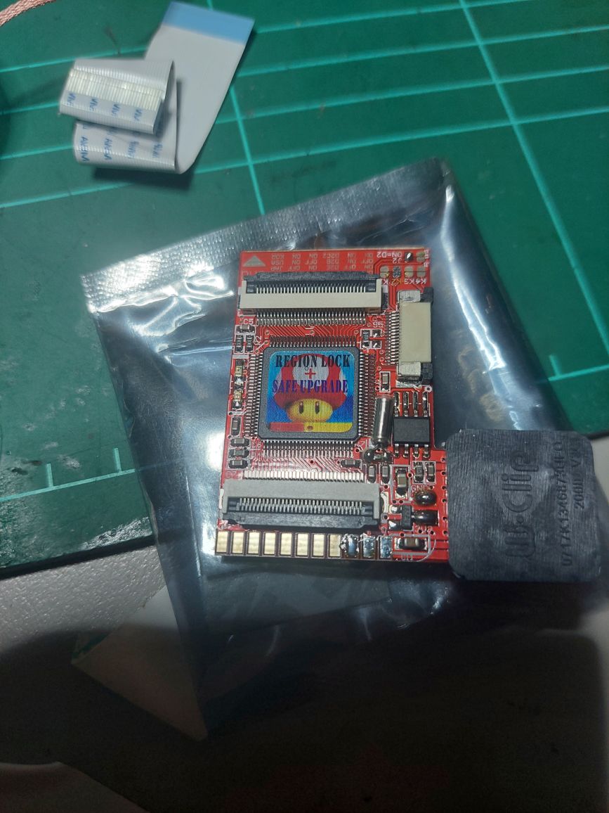

yeah i was installer. mostly used yaosm for dms-d2b. then d2ckey for short period was only. then d2sun lites as worked dms-d2e (softmods was taking over at bout this point so drive install requests was low for little. never used d2pro as by time needed to was d2sunlite lot cheaper), was cheap and worked well. still used yaosm for early rev. do have a d2sun still, the higher end version as got it for a d2e for myself and chips was long dead by then but found d2sun still on ic2005 (dunno if still up). ended up coming across some dms-d2b boards so swapped for wiikey that mate sent me 2x. installed one then noticed i had the dumps of it so tested actually worked with dip atmega8 as local electronics shop stocked that, was unsure work off the 3.3v point so just put it on 5v. as datasheet showed its range not as low as L or newer A for supply. worked np so stripped the wiikey for easier tracing n did my clone of it.

heres some pics seeing said was going to take some of what got.
