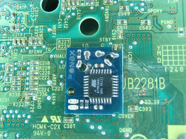

and other cool link
so the xeno is a atmega8l,
(74.19 KiB) Not downloaded yet
Posts: 4927
Re: Open Source Modchip like Wiishkas for GC
Post by emu_kidid » Tue May 11, 2010 6:32 am
I'm not a hardware expert but that's not very useful without knowing the fuse bits to set. The reason I assume it works on a reflashed wiikey is that it has the fuse bits already pre-set the same as the XenoGC does.
