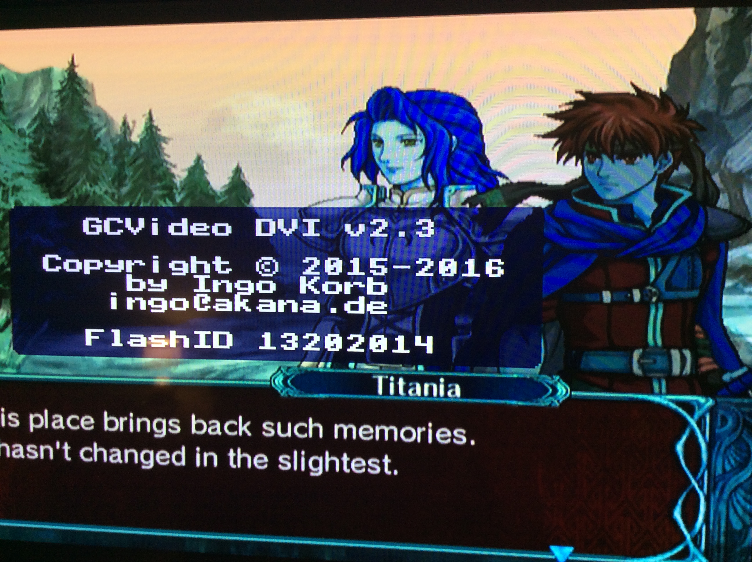

Problem: HDMI output seems to be working great, EXCEPT the red and blue colors are coming through swapped! This occurs only through HDMI, not through the composite output. All blue things look reddish-pink, and red things look blueish. Composite colors are normal. See my pics and note hair, skin, sky, water colors. Nintendo logo should be blue not pink. My forum search didn't come up with anything, knjn told me to try posting for help!

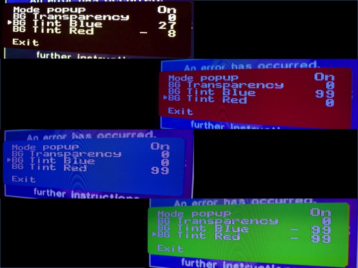

Update: I replaced and checked the CSEL connection with a higher quality wire but no change, blues and reds still backwards.
New info: If I set the GCVideo menu color to maximum blue (99) it turns red. Red=99 makes it turn blue. See my attached photo. Doesn't that indicate the color processing is getting mixed up INSIDE the Pluto II card?
FYI I have tested the color accuracy of my TV (good display) and swapped different HDMI cables with different inputs on my receiver to rule out a cable/receiver/display problem.

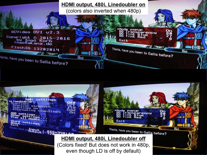

Update: I can get good color output through the card's HDMI output if I stay down at 480i AND turn off linedoubling. But if I turn on linedoubling, or if I try to switch to progressive scan 480p the colors invert again. See attached picture…
This tells me the card is receiving accurate colors, and CAN pass them through with certain settings… just not when it tries to engage the FPGA and/or software to upscale the video. Doesn't this point to a problem with the card/chip/on-board programming? Any thoughts on this conclusions, am I still missing something?

Yoadrian wrote:Update: I can get good color output through the card's HDMI output if I stay down at 480i AND turn off linedoubling. But if I turn on linedoubling, or if I try to switch to progressive scan 480p the colors invert again. See attached picture…
With all this additional information, I would point to your display as the culprit. One of my initial theories was that the red and blue channels on the output side might be swapped, but I discarded that since the OSD appeared to have the correct color and because the display shouldn't be able to show a picture in that case anyway - DVI/HDMI transmit the sync signals as sideband data on the blue channel.
Since you get correct colors with a 480i output and incorrect colors with 480p, the current most likely culprit is your display. Have you tried a different one? I would also be interested to know what happens with a 480p output if you disable "Enhanced DVI" before switching to something that results in a 480p output (either start a 480p game or turn linedoubling from off to on while the Cube outputs 480i).

Ok, I'll be 100% honest Unseen my first thought was "whatchu you mean my tv???" but I'm old enough and wise enough to lock those thoughts up and listen to those, well, wiser than me...
Spot on! I watch my Panasonic plasma all the time and it doesn't invert colors, but it is doing it with my Gamecube. I just tested the cube on my Sharp LCD and it looks perfect. So my first task was to jump online and tell you guys THANKS. I'm glad I kept testing, collecting data, and sharing it. More glad you guys chose to think about my problems and help me solve them.
My next job is to have a little chat with the Panasonic... I'm expecting wacky color settings or something, but will let you know if I learn about any "gotchas" with my set.
UPDATE: The culprit = Pioneer VSX-1121 AV Receiver. Hit "Video Parameter" button on front panel, and set "V.Conv." To OFF! Wish I understood why that setting made my receiver invert B and G... but I would rather go get a beer and toast to our success!
