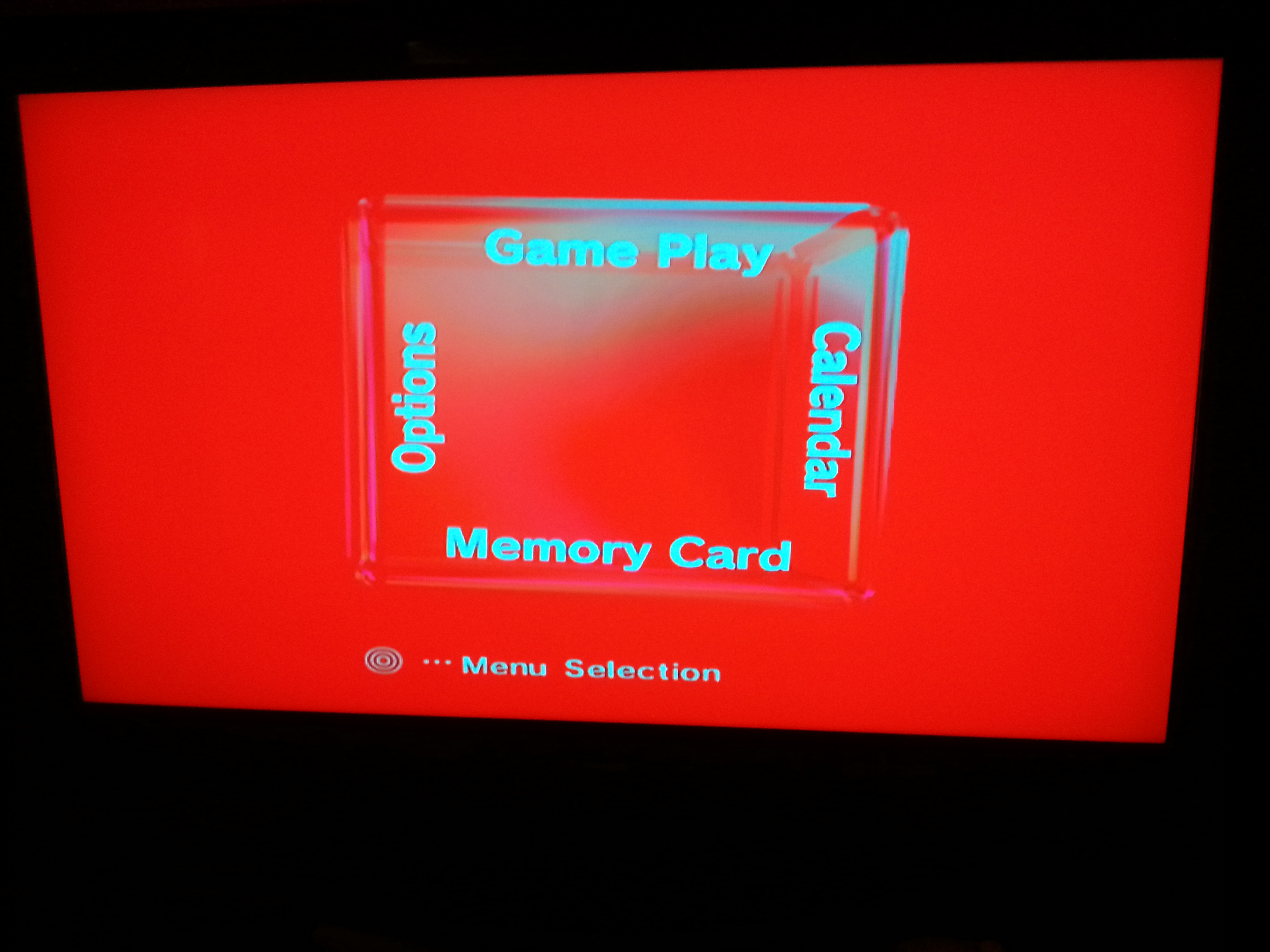

I am trying out the p2x code. I get a red screen. Most likely something is wired up incorrectly, because I have the idea to yuv to rgb is always active?
Currently looking what is going wrong, but perhaps you have an idea, Unseen?
Edit: never mind it is working now. The inversion of the TMDS was probably incorrect. I already tried changing the code to set it correctly to try and fix the issue. I guess I flashed an old file to the SPI.
Gotta go somewhere now, can't wait to play around with this. The OSD is really cool. Thanks Unseen! :D

meneerbeer wrote:I am trying out the p2x code. I get a red screen. Most likely something is wired up incorrectly, because I have the idea to yuv to rgb is always active?
Yes, since the p2x outputs a DVI signal it has to convert the output to RGB.
My first guess would be something wrong on the input side because as you mentioned the colors do look more like YUV problems than RGB problems. Since there is a stable picture, at least Clock, VData 4 and VData 5 are connected correctly (HSync/VSync, muxed within the pixel data). CSel might be involved in the problem, but it would be connected to a wrong signal and not just open or shorted to ground/supply. Another possibility could be a mis-wiring of the highest VData lines (6/7) so that it is seen as constant/mostly-constant 1 during the picture area, although it can't be miswired to the adjacent 3.3V pin because then you wouldn't get a picture at all (all-zero Y component is used to mark that the cube is transmitting Sync+Flags instead of picture).
If you want to check that it's not a problem of the board, you could try to flash KNJNs Pong demo from the StartupKit zip, subfolder "FPGA project - HDMI". It doesn't matter if the board is connected to the cube or not to run that demo, choose the method that is more convenient for you.
(which reminds me that this might be a good test for andre104623's board too...)

I tried out the line doubler. It seems to give a "jumpy" image. As if every other frame the image jumps down by one line. It definitely happens at the top and bottom line, but I have the idea that the whole image is jumping up and down. I think this can be fixed, but then we first need to be certain about what causes it.
Scanlines are working great for me for linedoubled 576i. For linedoubled 480i they are barely noticeable. They only seem to be noticeable when there is movement on the screen. I think this also has to do with the above issue with the jumpy image.
I do not really care too much about the linedoubling issues, since I do not really plan on using it.
Oh, one other thing. It seems you do not set the active video you send over HDMI as 720x480/720x576. Perhaps some TVs get confused by this because they expect a line to have 720 active pixels (that will give black bars). Although it is definitely not the problem that is causing the p2x to not work with so many TVs.
Other than that, it is really nice. I would have never put this much effort into it. I probably would have only decoded the video signal to HDMI and been too lazy to add all these features.

meneerbeer
Posts: 212
Post by meneerbeer » Tue Jul 21, 2015 6:40 pm
Unseen wrote:
tueidj wrote:For the jumpy image problem with the linedoubling I believe what meneerbeer is suggesting is to add one extra blank line to the top of the bottom field image to properly align the original scanlines with their intended display position, rather than implement some sort of deinterlacing algorithm.
I'm reasonably sure that the alignment is already correct. My method for testing this uses a short video capture using a PEXHDCAP card, with a 480i source signal, linedoubling enabled and maximum-strength alternating scanlines. The scanlines black out every second line in the image and two consecutive fields of the captured video can be combined in Photoshop or similar image editing programs with a "Lighten only" blending option. A test capture from Mario Kart Double Dash is available on imgur and the attachment is a 400% enlarged crop from that.
Of course I still may have gotten it wrong, but I think the flickering cannot be avoided without proper deinterlacing.
I think you are right. Even if you place the second field one line higher, you would still notice the copyright logo changing every frame, as the data is different.
